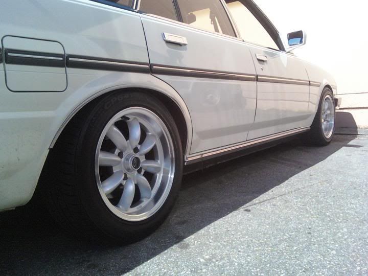

            This is my old setup with my rotas 15x8+10 all around and a 6mm spacer in the front, camber 0 in the front or slightly negative. 205/50r/15 all around too, before I put the spacers on I was rubbing my tires on my coilover's top perch/spring.

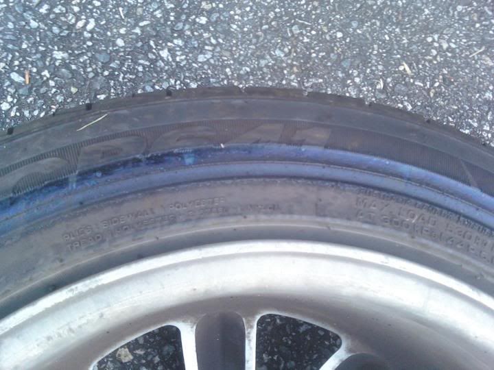

            Here's the tire :P wore in about 1/4"
            Gooo looow offset brooo.

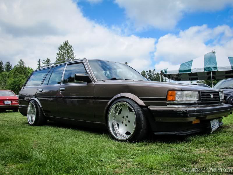

              If you wanna go hella aggressive... my buddy Aleks of DeathSquad has 17x10-10 and 17x10.5-25 (I believe but not sure about front width) on his wagon with a huuuge pull on his stock flares all around.

                Well, that wagon looks fantastic. I just want a bunch of lip, hence the massive offset. Aiming for something like this
                • #23
                  I'm also seriously considering doing this in my wagon after the air. Looks sweet.
