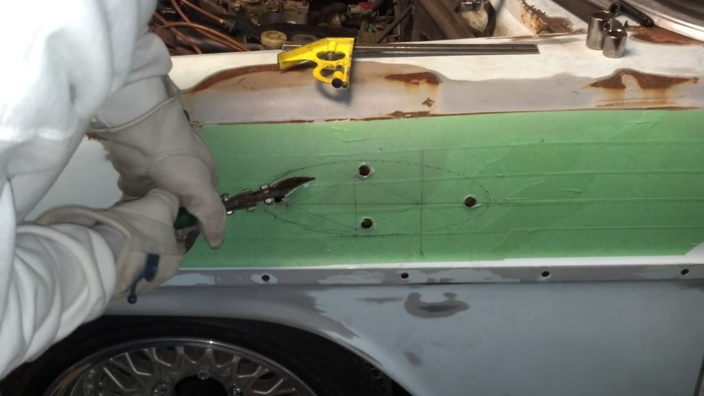

      I'm almost finished with the drivers side exhaust after last night. I actually remembered to take some pictures this time so here you go.
      To start I cut a 25" cherry bomb in half
      Then I made a cap for that out of a street sign.
      Along with some 2" pipe to extend the core out through the cap.
      Cut a hole in the inner fender.
      9" slash cut in 3.5" pipe for the tip
      Tapped up the fender and started pulling measurements.
      Let my old man make the cut since he's a master with tin snips haha

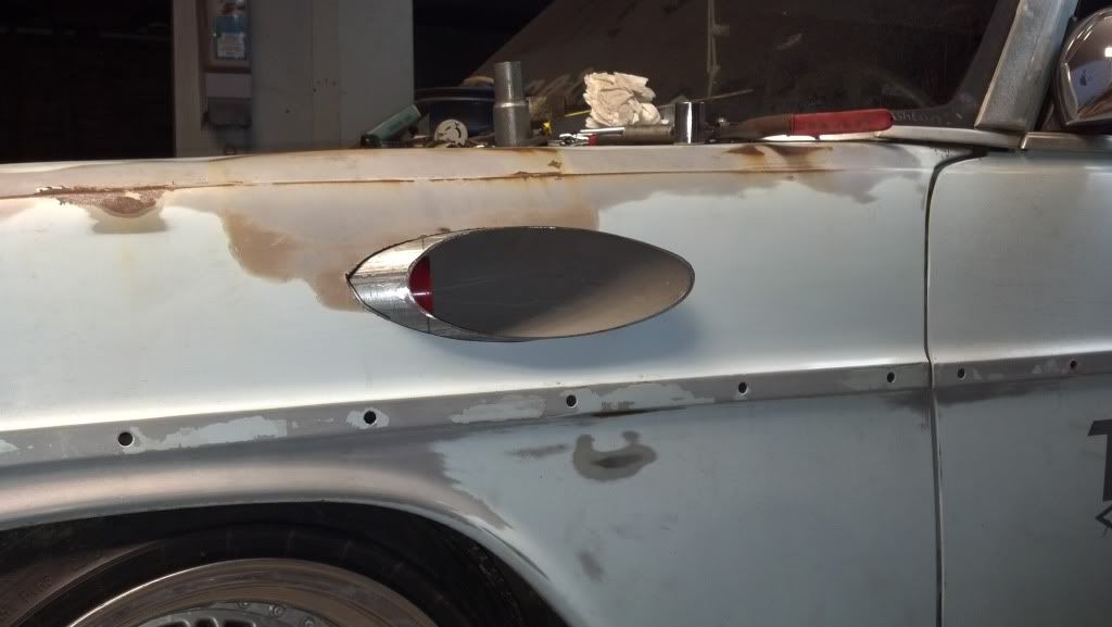

      Test fitting
      Found a happy spot.
      And stopped right here.
      And if you haven't caught on yet... Almost everything I have built for this car has been out of scrap metal and pipe or whatever I have laying around the shop. It's not a rat rod, but i'm building it with that mentality by buying nothing that I can make out of something else. That's why all my pipe is miss matched. So there's that...

      • Badass...
        • Holy shit.
          • now that's a mean exhaust exit

            • That will be loud=) I think once it corrodes a bit that it'll blend right in

              • Still have to clean up the edges a bit too...

                • worst exhaust ever. if there isn't danger of fire near your face then it isn't good

                  • The fire will be in my face and bystanders crotch.

                          • if you dont shoot flames, i will give you shit for the rest of your life. my jaw dropped by the way. finish it now.

                                Thanks a lot guys!
                                You know it's going to. Like you even have to doubt that... haha
