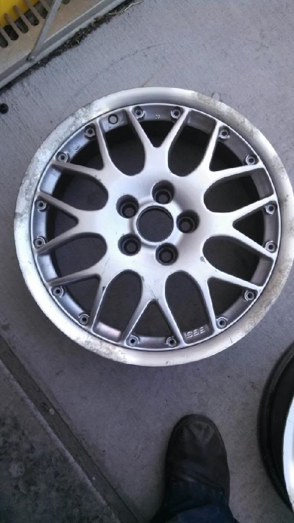

                      Just bought these:
                      VW-spec BBS RXIIs, 16x6.5" +38. Sourced from a certified wheel whore / powdercoater friend of mine. He already has a line on different lips for them for a good price, so I'm going to go for an 8" and 9" fitment front to rear, respectively. They'll also be getting coated in whatever color I want, but I can't decide.
                      Any thoughts, Stanceheads? The car is Graphic Red and the interior is light gray. Lips will be polished. I was thinking a silver flake, gold or copper for the centers.
