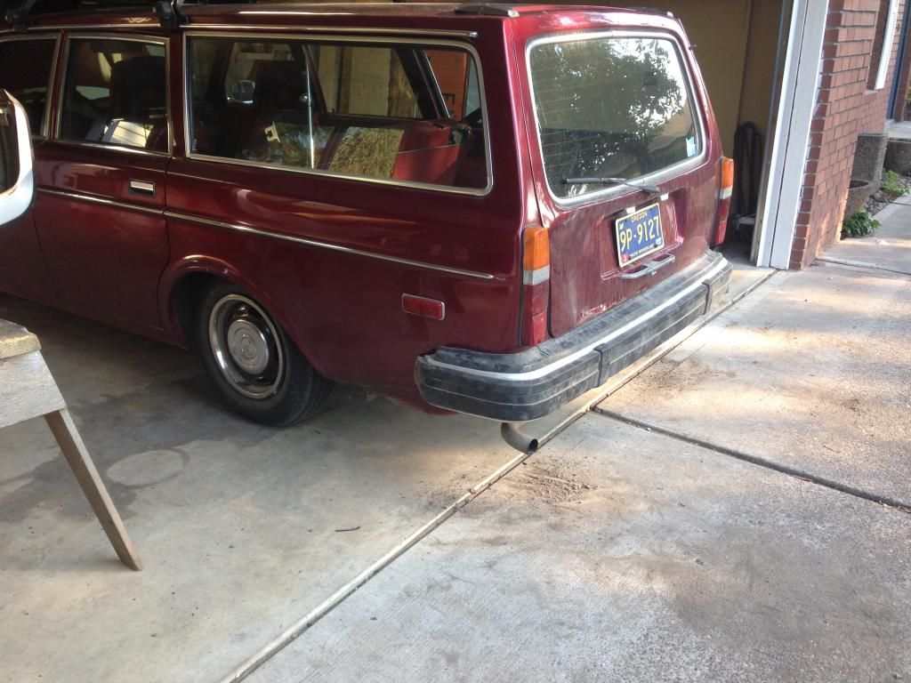

    After scouring the junkyards looking for a good hatch to steal, I stumbled upon a 1976 wagon that had BOTH bumpers tucked. I had only seen it done once by stanceworks user Carter and it's something I knew I would never get around to actually doing myself, so I was stoked to have found them! I snagged all the brackets that had been shortened and rewelded and threw them on. I was a little unsure at first since they were VERY tucked, but I love them now! It's something unique that you don't see a lot of Volvo guys with the commando bumpers doing. I'm going to try and see if the top rubber trim from the newer plastic bumpers will work since they go farther back on the sides, but for now it's still great.
    and here you can see how much they were shortened
