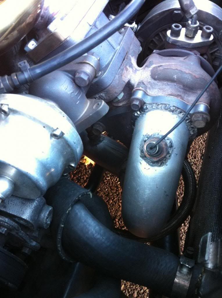

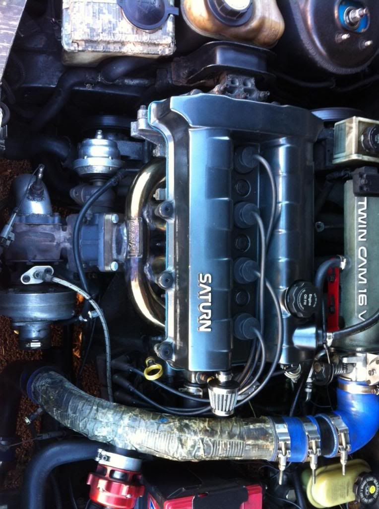

Here's the new set up. I had to swap on a different hot side, the stock ford one went out. A little bigger wheel on this guy so it takes a bit longer to spool, but it's not too bad.
If you want to use an external wastegate with an OBX manifold this is the way to do it. I bought a $40 adapter for an external wastegate and it just clears the block with the tial 38. I know part of the problem with the OBX manifold is that because of the cheaper metal getting real hot they can crack, I figure this adapter should help seperate a little heat from the manifold. Also This time I bought thicker exhaust tubing for the downpipe so this should be a bit more solid. I did all of the measuring and cutting and had my buddy weld it all for me. For being a gasless mig it turned out pretty damn well, there is obviously some splatter, but it just adds to the..... patina?

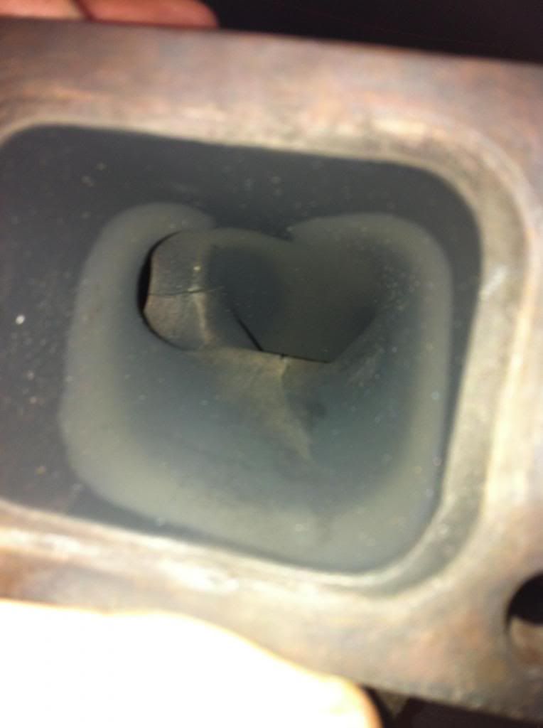

The crack started on the outside of the turbo from the wastegate port and went inside and did all kinds of crazy stuff. I'm surprised it didn't seem to run any different.
Oh yeah we'll be fabbing the wastegate dump this coming weekend. I'll get pics of all that stuff as well. I want to put it pretty much straight down although I considered running it up through the hood or out of the bumper lolz.94 Saturn SW2 - T3s60 7psi, slammed, daily driven
