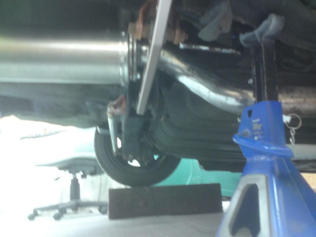

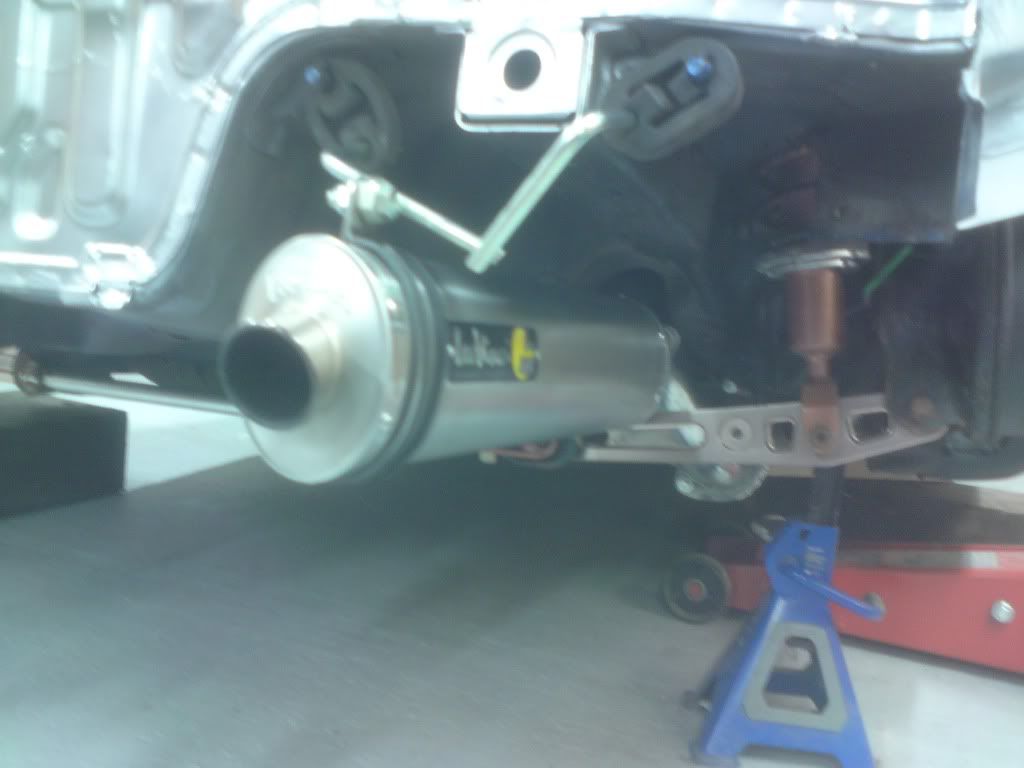

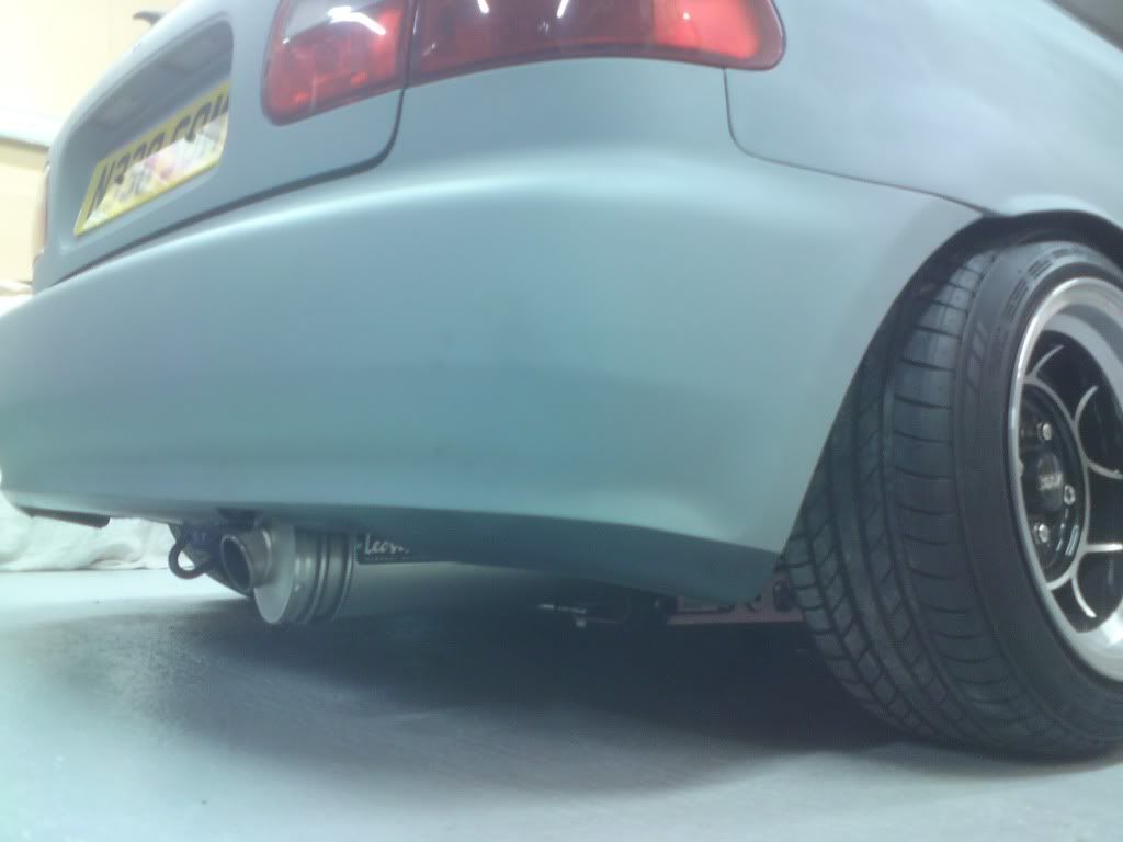

Right guys finally got round to choppin the stupid bass cannon off and replacin it with a smaller can. Got some friends in to work their magic with the welder

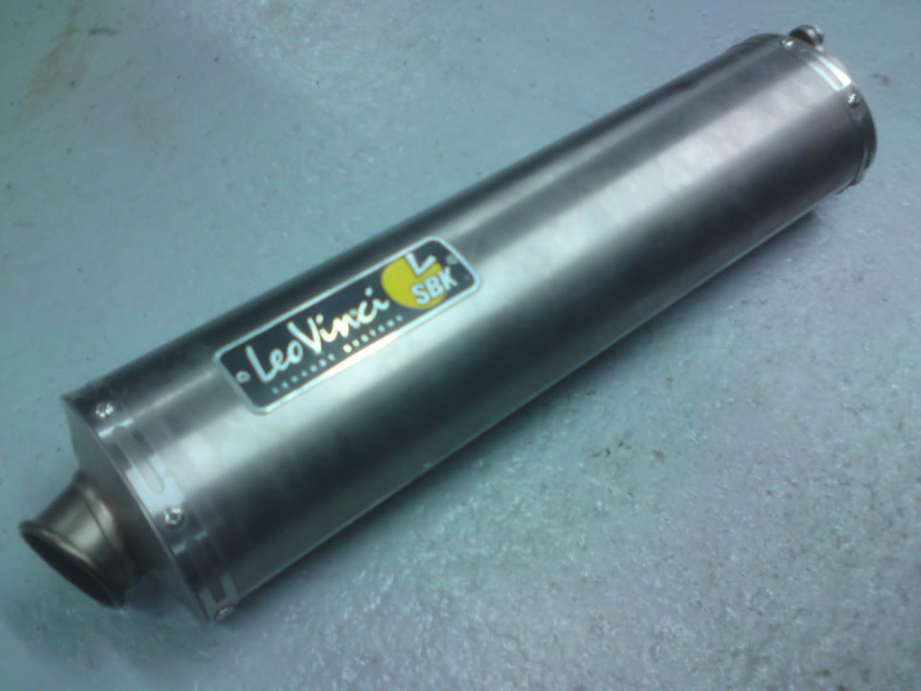

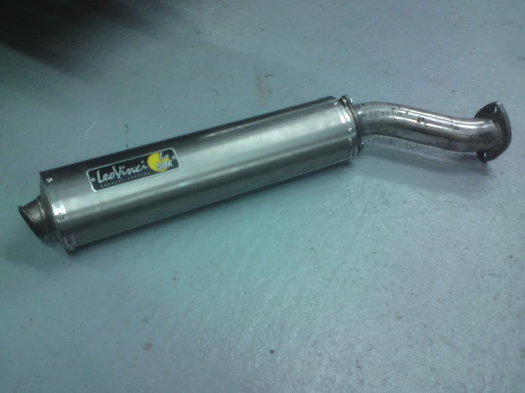

. After hours n hours of searchin ebay I found it. A Leo Vinci SBK bike can. Not the usual option for civics but I always fancied one
. Firstly had to take bumpers off so I could get it on to my "ramps" lol.
More pics to follow soon...Have Faith, Roll Static...

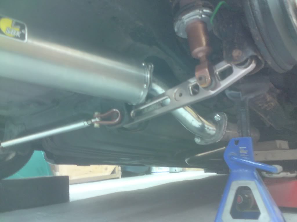

My mate milled me a flange out of a block of stainless, top bloke. We use the bend off the old back box and altered it to fit. The new can is alot longer so we had to fit it higher to the body. The hanger was chopped off and re-used. The exhaust now sits tight against bumper and control arm. Now i have plenty of clearance from the road
