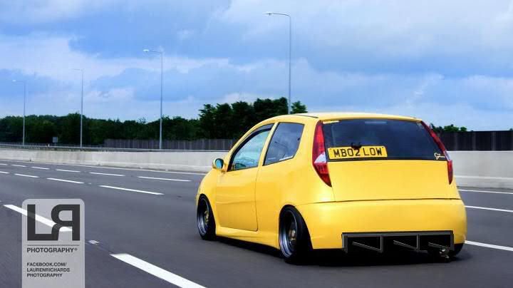

    Little update
    Now have done a bigger brake upgrade using Punto Mk1 GT3 front calipers with Drilled/Grooved/Vented Discs and EBC greenstuff Pads with a Punto MK2 HGT rear axel and rear disc with Drilled/Grooved/Vented Discs and EBC greenstuff Pads. Also did a box change from a 1.2 8v 5 speed to a 1.2 16v 6speed with a 1.4 16v clutch and lightened flywheel.
    had to add more camber due to rubbing the tyres on the rear
    And currently it is having a custom turbo conversion -
    once I have run this for a while I will be stripping it down and relocating all wires possible in the engine bay and smoothing it then getting custom stainless manifold and other parts with the engine being fully polished and painted
    little video (running 5psi but it will be running around 15/16psi when finished)
    [ame="http://www.youtube.com/watch?v=6Q1s9FiiAPU&feature=youtube_gdata_player"]Bedworth's car first drive - YouTube[/ame]
    ps - dont worry at the end about him saying about the smell. Its just my HIDs getting too hot
