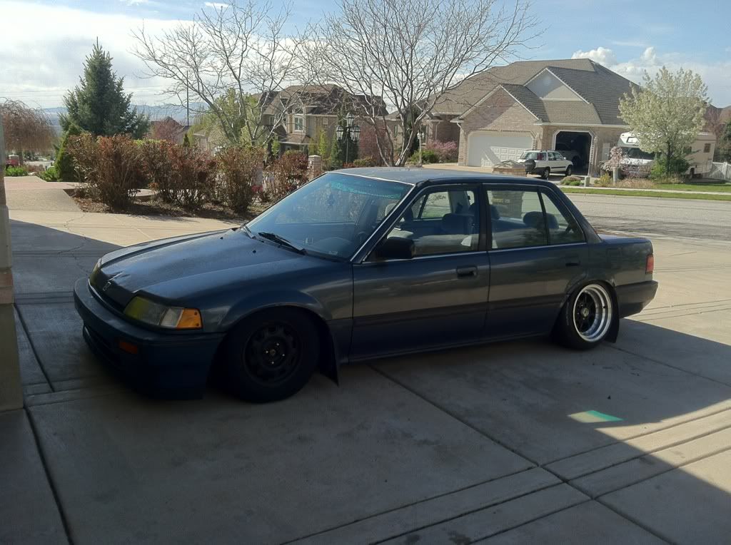

Anywho, I love this! I have always been a fan of these old sedans ever since I had my 88 hatch back in 2003-4. They look so good when done right and you are doing it right!

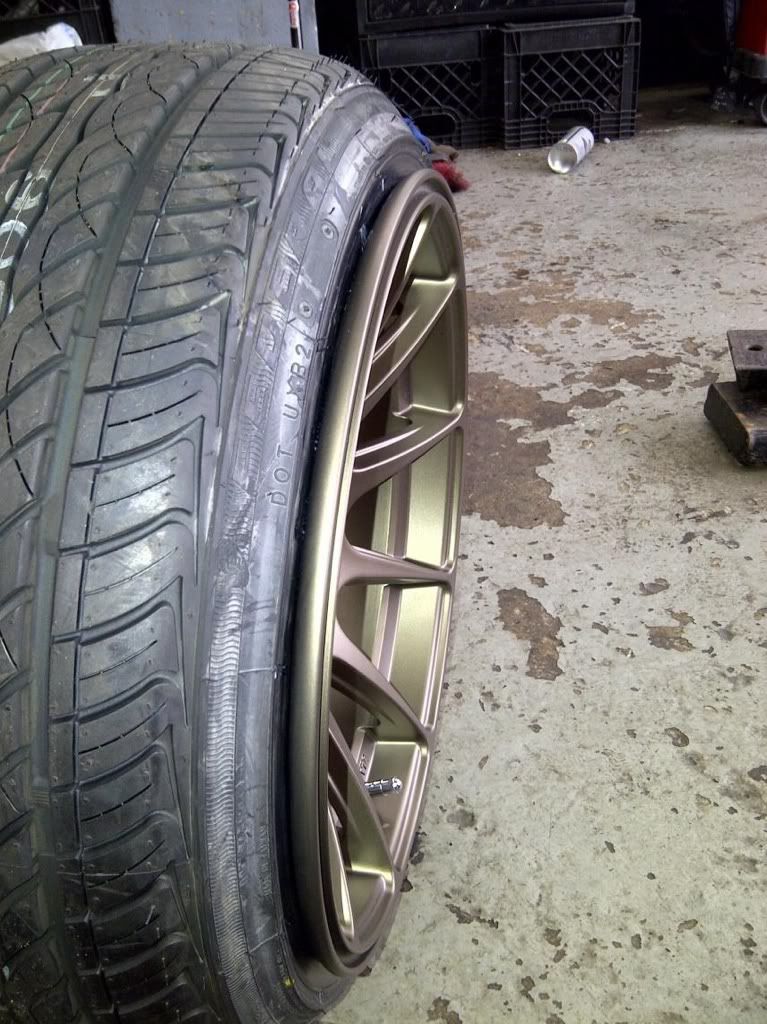

Camber doesn't wear tires much at all. It's the excessive toe induced by slamming the car. Adjust that and your tires will last
