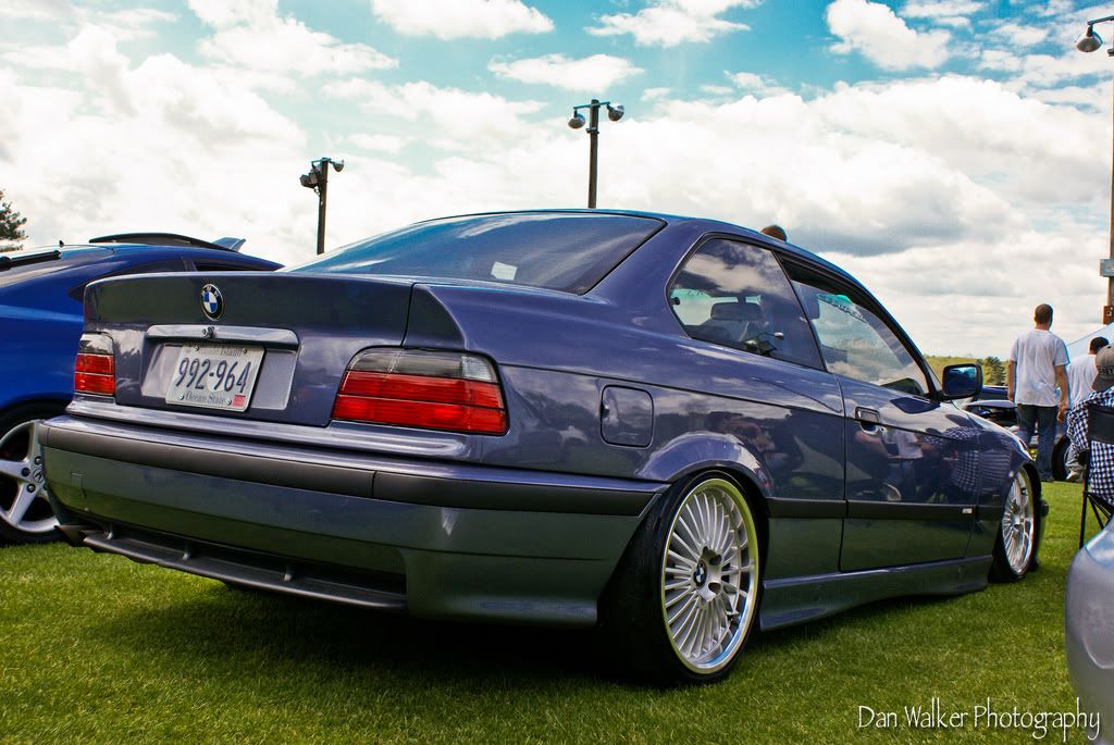

Got something sorted out and ordered since my last post. Fixed my camber issue. Decided that I don't have 400 for some Adj. camber plates so I just went with swapping the mounts to their opposite sides for almost -2 degree of camber up front. Staggered in CT was around the corner so I decided to lay her out and test these coils. I was not disappointed. My spacers came in for the rears so got them on as well. 25mm out back and my 25mm spacers only came in on Monday, the day after I needed.
My other spacers came in on Monday for the fronts so I finally got them in so I can have some almost proper fitment finally.
I still need to grab some proper pics because I had to spin the coils up so I could actually drive with this fitment. The wheels could use maybe 10mm out back more and another 5mm in the front.
