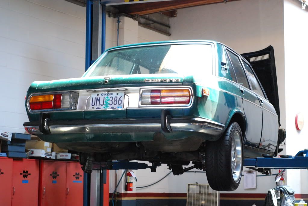

I Then drove it to my friends shop where I was going to overhaul everything mechanically.
Things I've done:
The old tranny was leaking to much for my liking so I decided I will somehow put a newer BMW 5-speed tranny in it.
-Put 5-speed Getrag 265/6
-New Shift linkage plate (e28)
-New clutch
-Machined Pressure plate
-New rear main seal
-New pilot bearing
-Had to fab up a cross member for the tranny
-Shortened and balanced the driveshaft
Brakes:
-New rotors
-New Calipers (2002 tii front calipers)
-New Pads
-New lines
Other things:
-17'' BBS style 5 wheels
-Tires
-New radiator
-Alternator from e28
-Sound system
-Fixed most the lights
-Another fuel of filter
-Wheel bearings
-Exhaust hangers
-Removed old cruise control unit
-Adjusted Carbs
-New fenders
-New bumper
-New bumper brackets
-valve cover gasket
-Fixed power steering leak
-Cap, Rotor, Plugs, etc
So, I have been driving it every day (at least 60 miles a day) for the last several weeks and I couldn't be happier. I love the thing and have so more work to do.
Next is paint, some interior stuff, and coilovers.
I'll keep this thread updated as I go.
