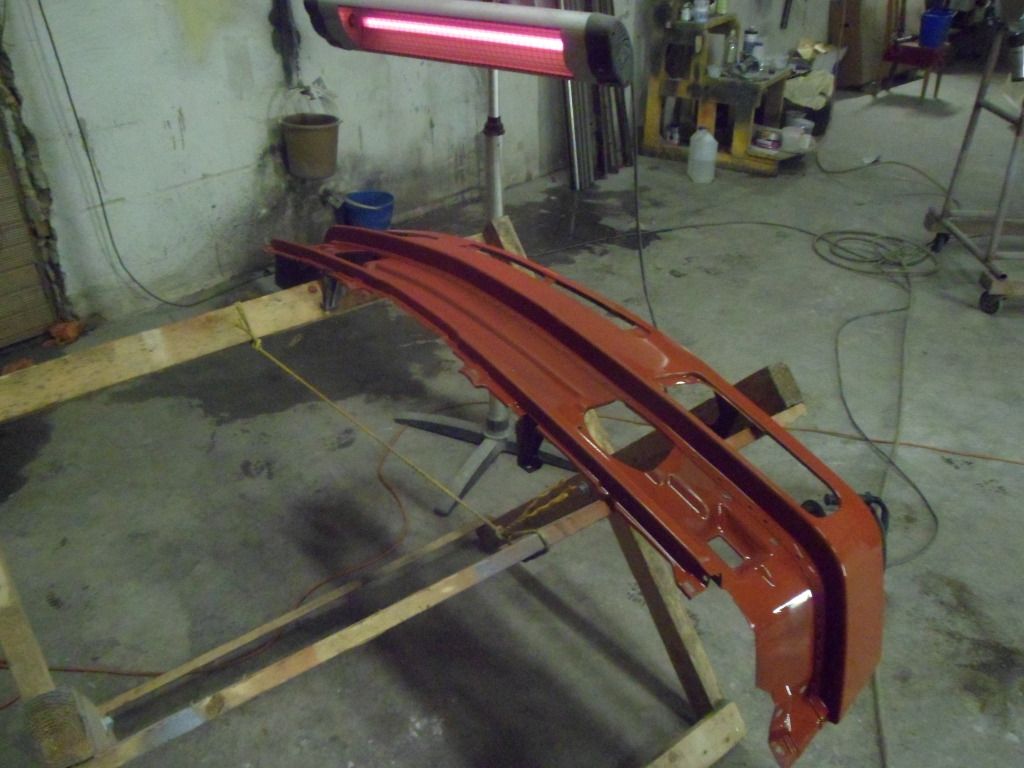

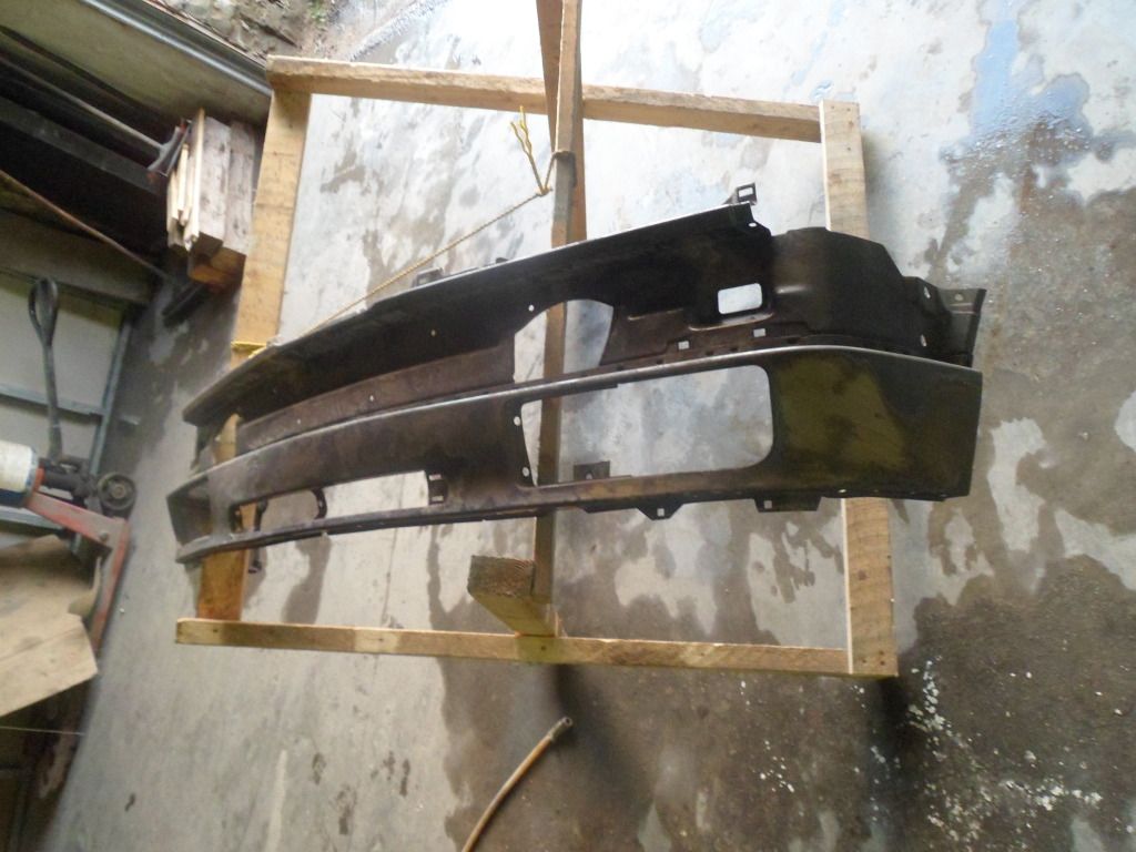

Decided to paint the front valance .
It was hanging on the wall for three months, I had dipped it in a rust converter, so that it would not rust any further as it was bare metal.
You could call this the leftover valance, as every ingredient was a leftover from other projects.
Started by removing the rust converter
photobucket.com/albums/n505/MartinsElerts/?action=view¤t=SAM_2250.jpg" target="_blank">
A clean surface to work with.

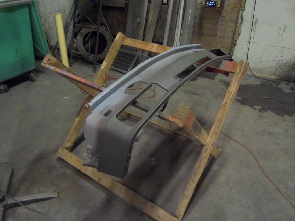

The bare metal needs some protection, so I used acid primer.
Valance it self had a lot of dents and road ware, but as it was also very rusted I decided not to use any body filler as it will need to be replaced as soon as I have some cash.

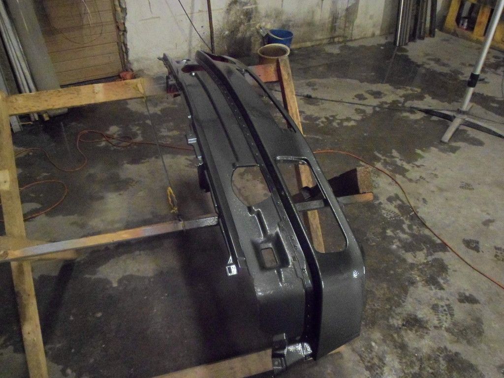

Applied some acrylic primer and stone chip protection.
photobucket.com/albums/n505/MartinsElerts/?action=view¤t=SAM_2263.jpg" target="_blank">
Left over paint and clear coat later we have a "LEFTOVER VALANCE"

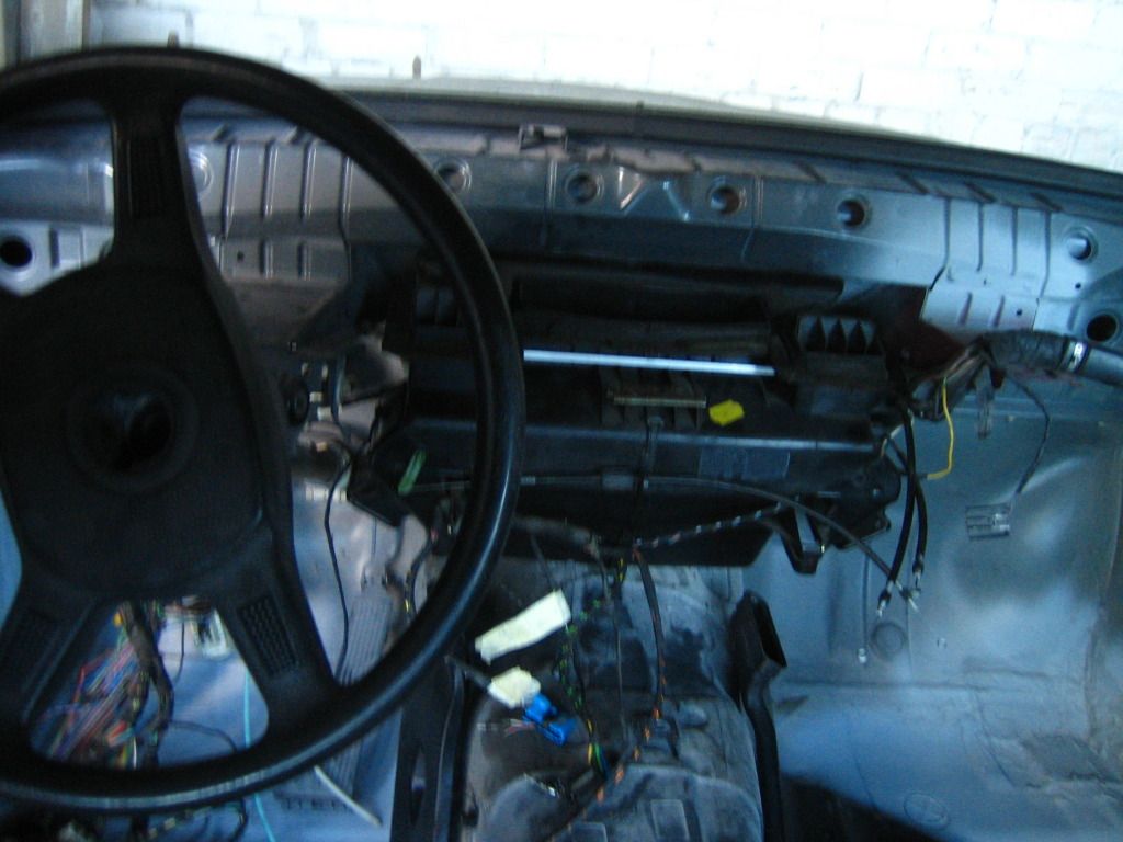

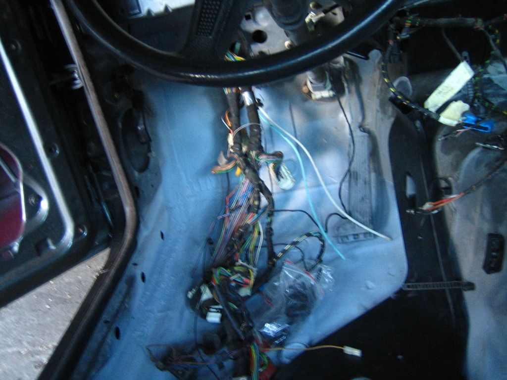

And a lot of work still to be done,
Started to fit the wiring loom and I already want to hang myself in it.
Also need to get brakes done.
And I don't have a clue how to get the engine running
