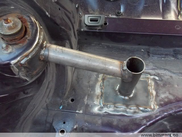

        Subbed, this is SUCH an awesome build, the amount of fab work in the third post alone is unreal! I can't wait for more updates.

                pretty damn good metalwork and welding.... 10+

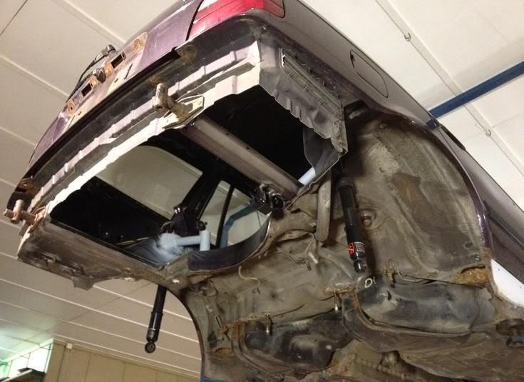

                  Thank you guys! Like the "love" here We will try to giv you as mutch Stanceperiance a.s.a.p.
                  The Bmw 2002 is the hi-priority at the moment.
                  Here is some more of the Touring, thee engine choice was switched to a M50B28 (Look at the first post ):

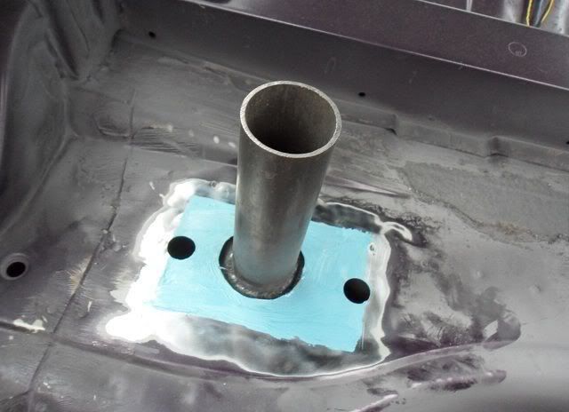

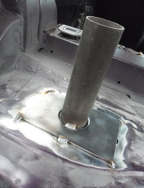

                      • #26

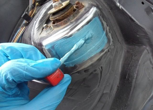

                        What is the blue stuff you're using in the last post before you weld the plates on? forgive me I'm new
                        IG/TWITTER @alloydhiggins
                        • #27
                          It's welding primer, it will rust if you don't use it Munchơ importante!!
