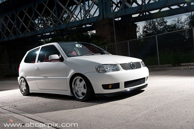

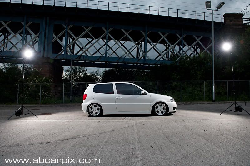

mk4 vw polo 1997

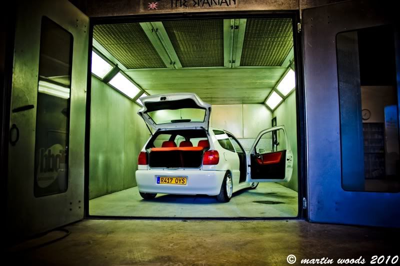

Full respray in audi ibis white inside and out
Bentley black roof

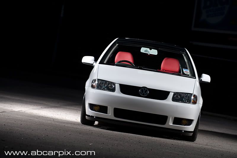

full 6n2 GTI front end conversion to the 2001 models
smoothed front bumper
smooth GTI splitter painted Bentley black
smoothed off side repeaters on wings
m4 Golf R32 sideskirts shaped to fit then smoothed into the body

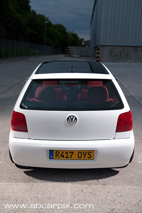

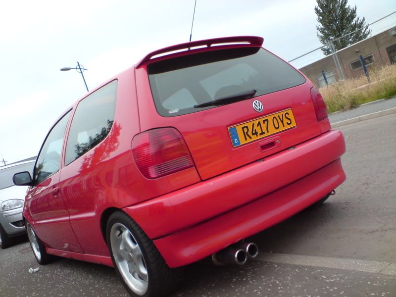

6n2 gti tailgate with gti roof spoiler and lower brake light
smooth petrol cap cover

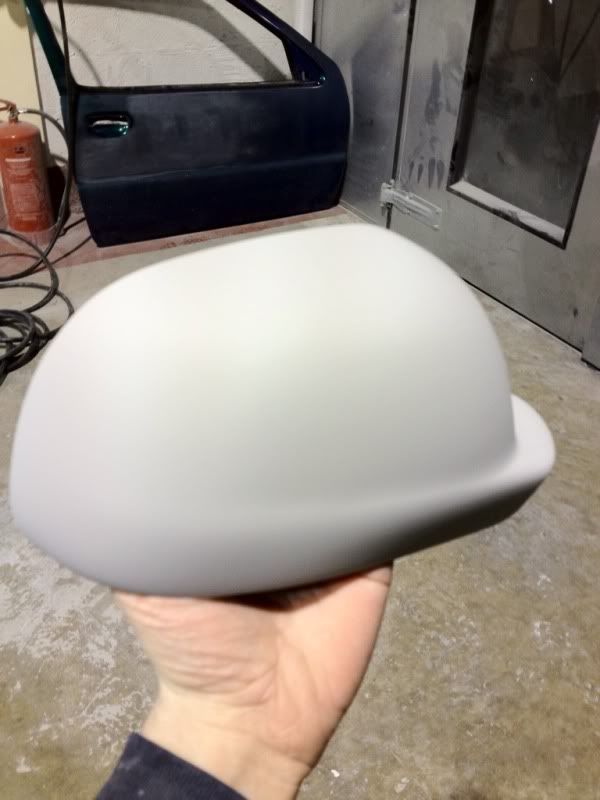

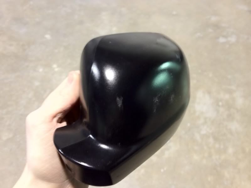

mk5 stubby wing mirror
lowered approx 100mm on adjustable coilovers

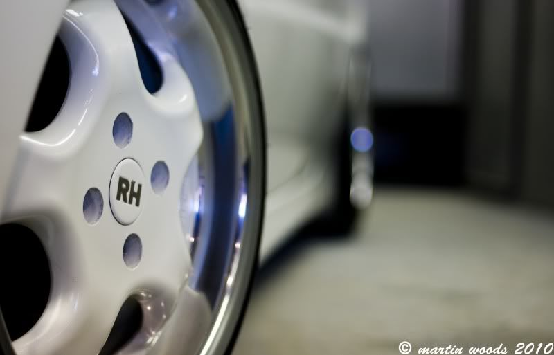

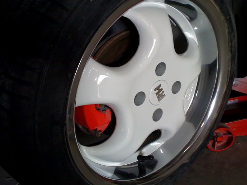

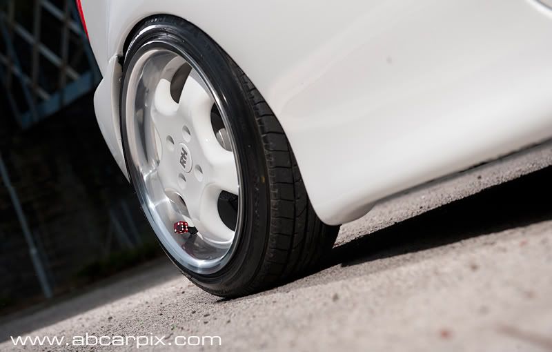

15" RH Cups with colour coded centers and mirror polished lip

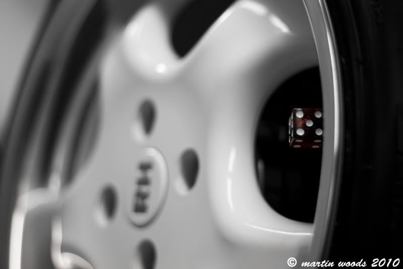

Red las Vegas casino dice made intovalve caps

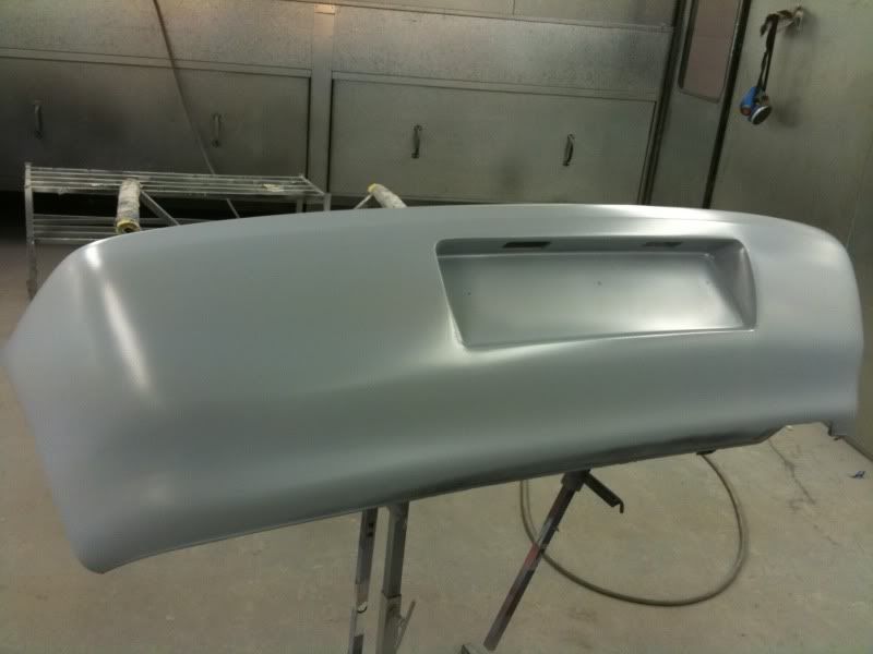

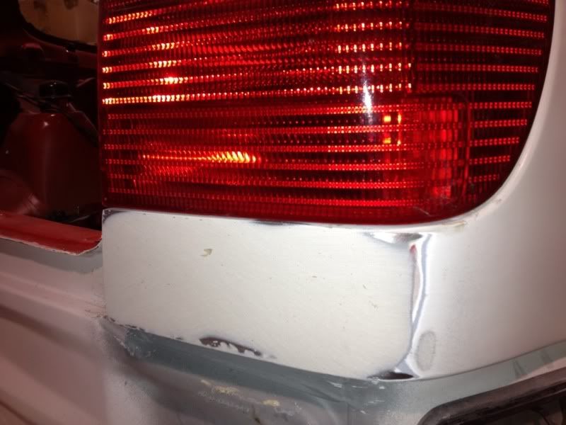

mk4 and mk5 rear bumpers grafted together for 1 off bumper
mk5 rear lights
aero front wiper

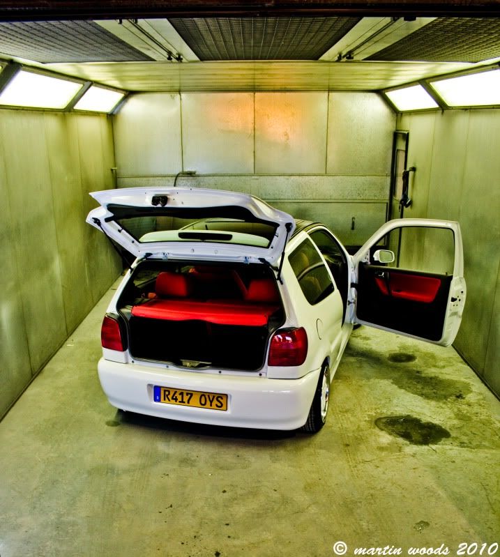

glass blank in rear window afte removing rear wiper
removed rear tow eye for smoother look

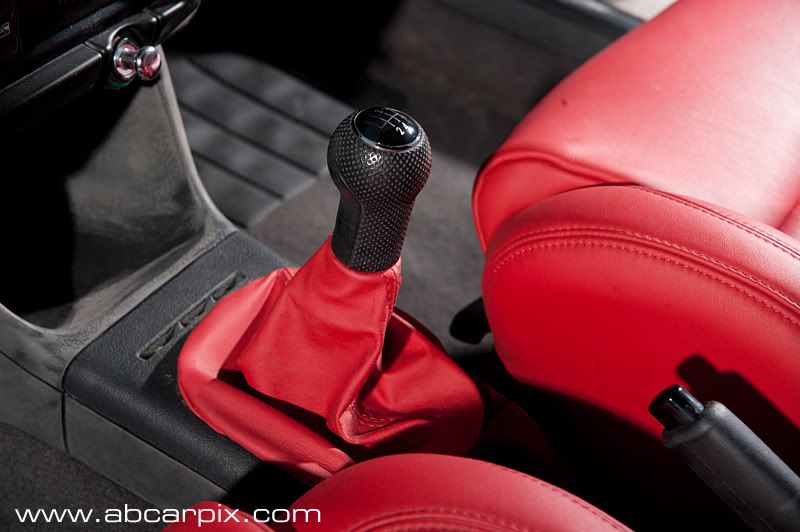

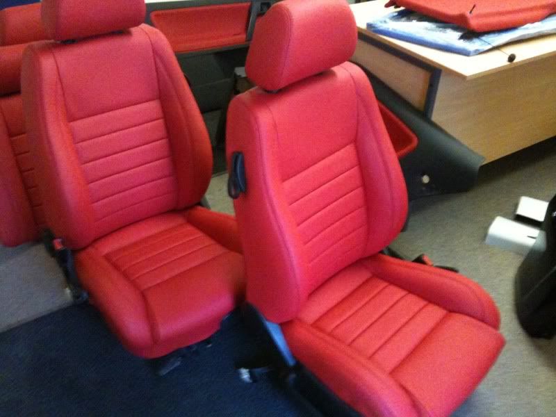

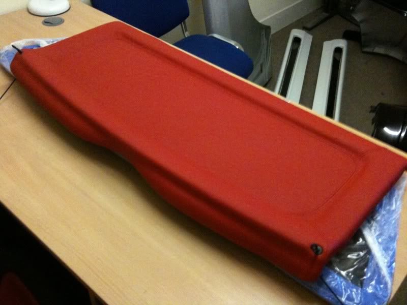

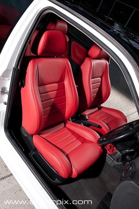

Full 6n2 GTI interior retrimmed in Porsche Panamera red napa leather with porsche design centres
roof lining and pillars trimmed in black
mk5 steering wheel
lupo gti black sun visors

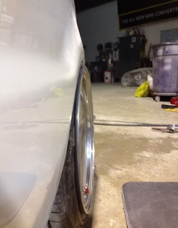

wheels after dish being mirror polished

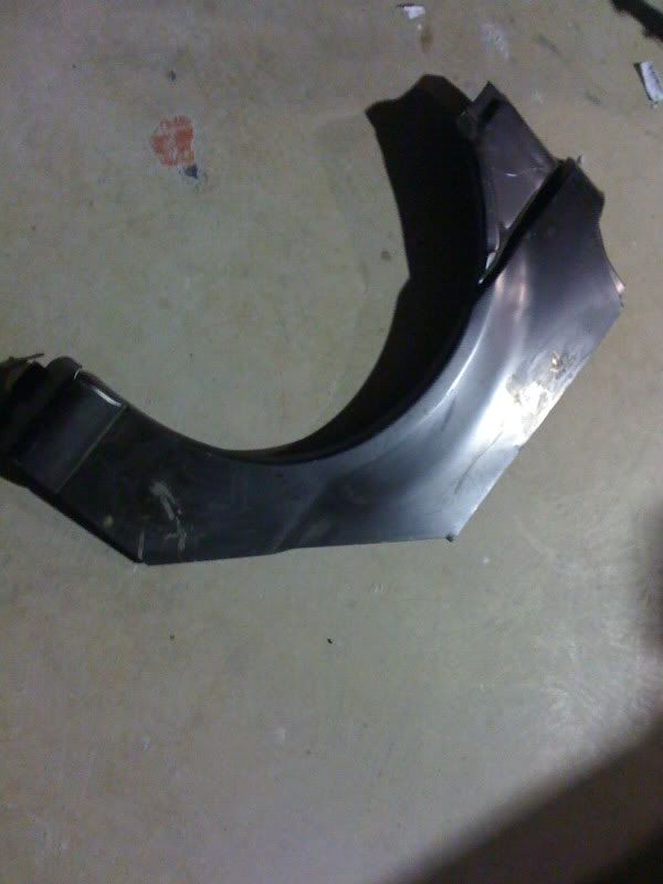

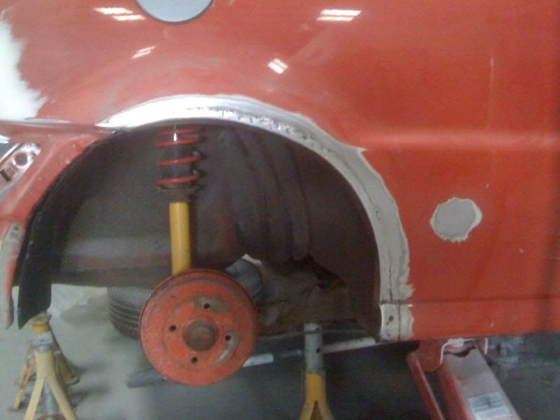

new arch welded in place

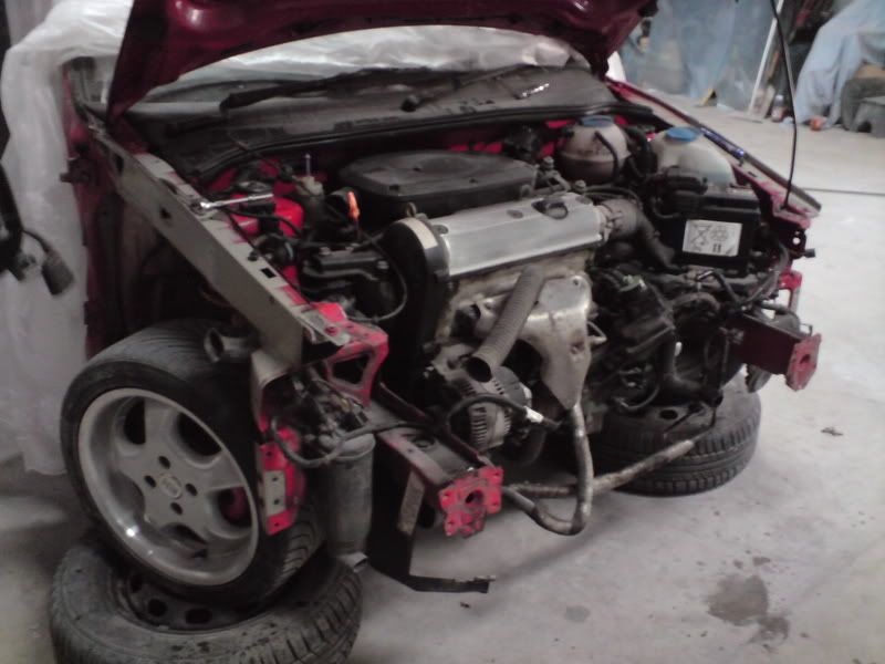

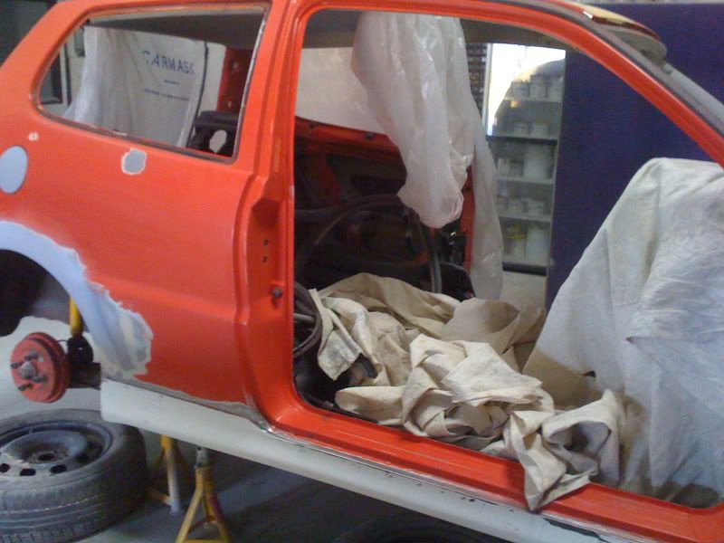

car completely stripped and mk4 golf R32 skirt being moulded into the correct shape
R32 skirt smoothed in and primed
wheels painted
rear bumper being made from the top half of a 6n and the bottom half of a 6n2 bumper
bumper primed

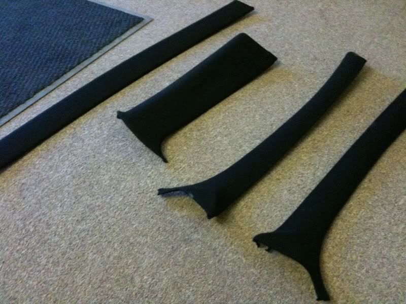

pillars trimmed in black velvet
interior retrimmed, full 6n2 gti interior

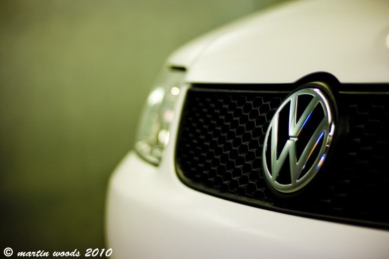

and how it looks today

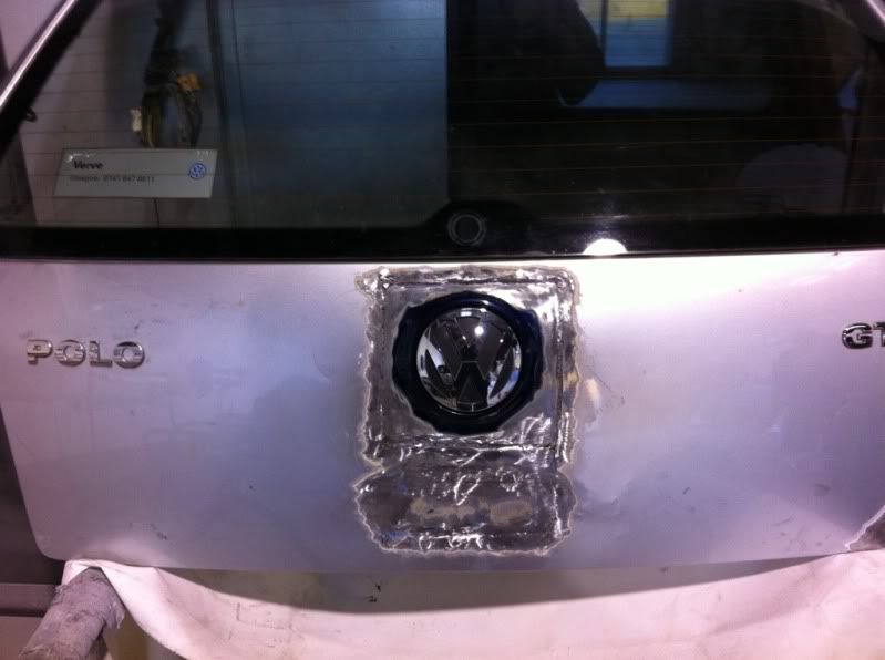

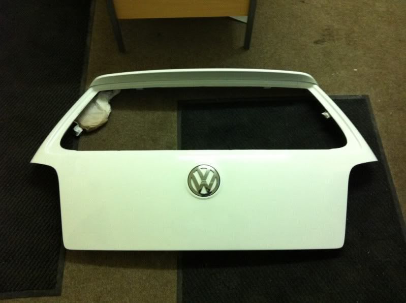

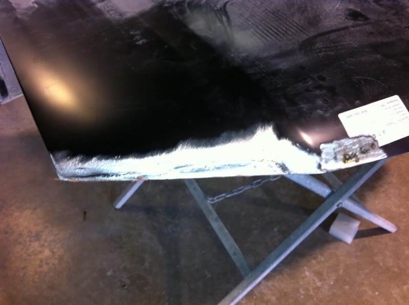

first off the tailgate
i got the chance of a mk5 tailgate cheap……how could i let this pass by

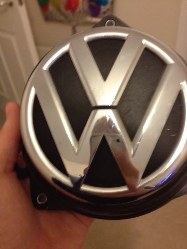

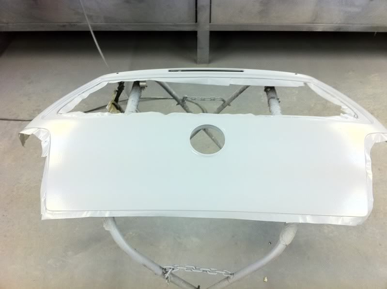

so out with the grinder and welder
I wanted to keep the handle in roughly the same position the original VW badge was on the tailgate and the plate was placed inside the tailgate then welded in so the actual bulging piece of the handle is smaller than a mk5 so it resembles a badge more (subtle)

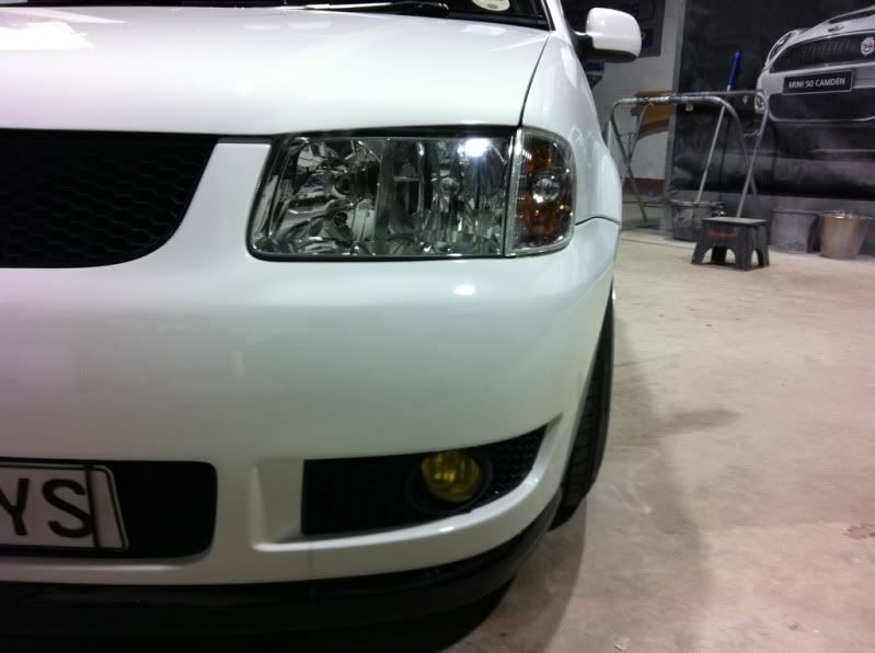

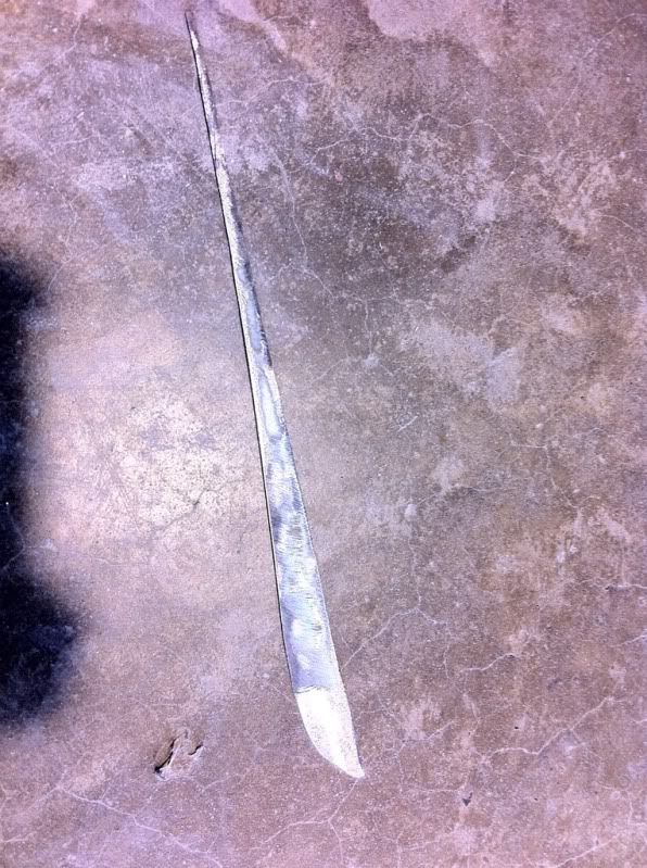

next up, the bonnet, i wanted to add my little touch to the bonnet but i wanted to keep my badged honeycomb grill so instead of smoothing out the bonnet notch i extended the area above the headlight by half and inch, its not a huge change but it add a different look to the front
the weld in section

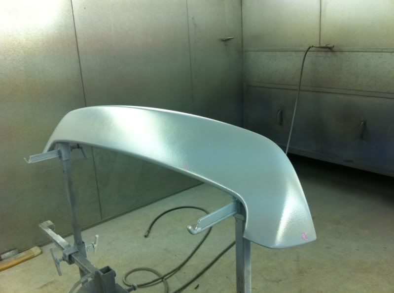

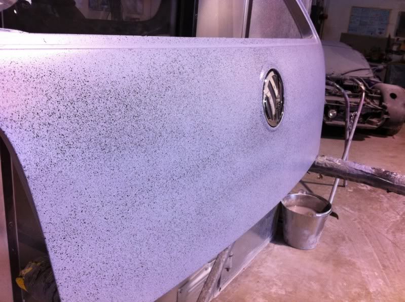

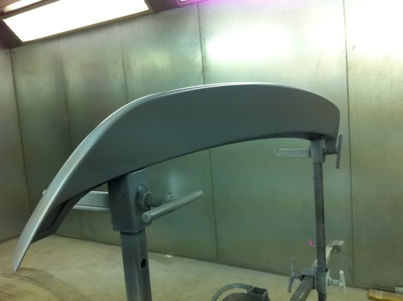

next up, gti spoiler, you can only buy 2 of these, one with a brake light fitted to it and the other with a large cut out section so the brake light on the tailgate can show through, i wanted….neither so take out the brake light and fill in the holes and space
an all painted
handle backing colour coded
and done

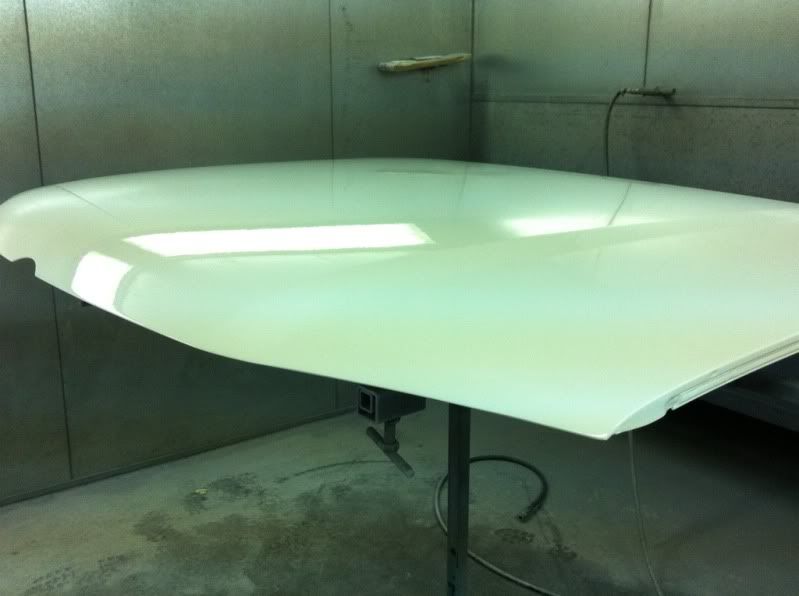

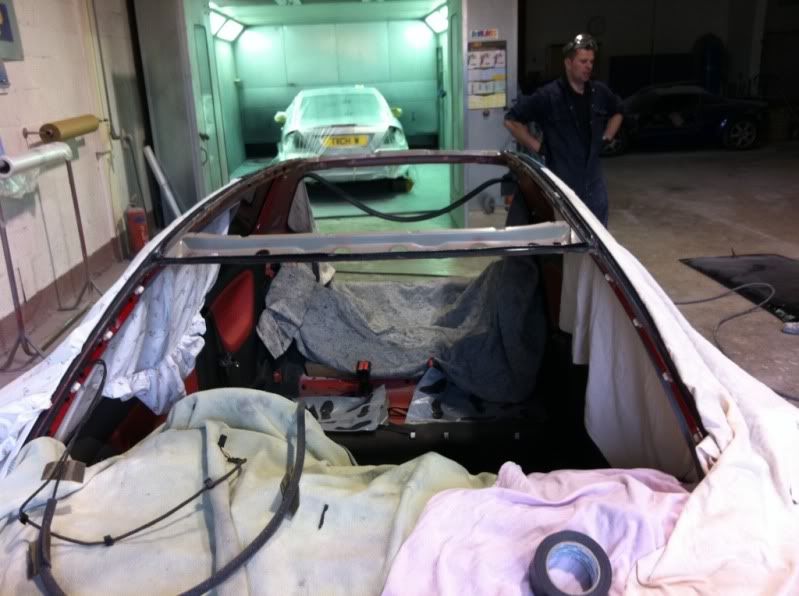

needed to get rid of that horrible sunroof on the car so ordered up a new roof skin from vw and 3 weeks later it arrived
fitting the roof
take off the old one
new roof now fitted and re aligned

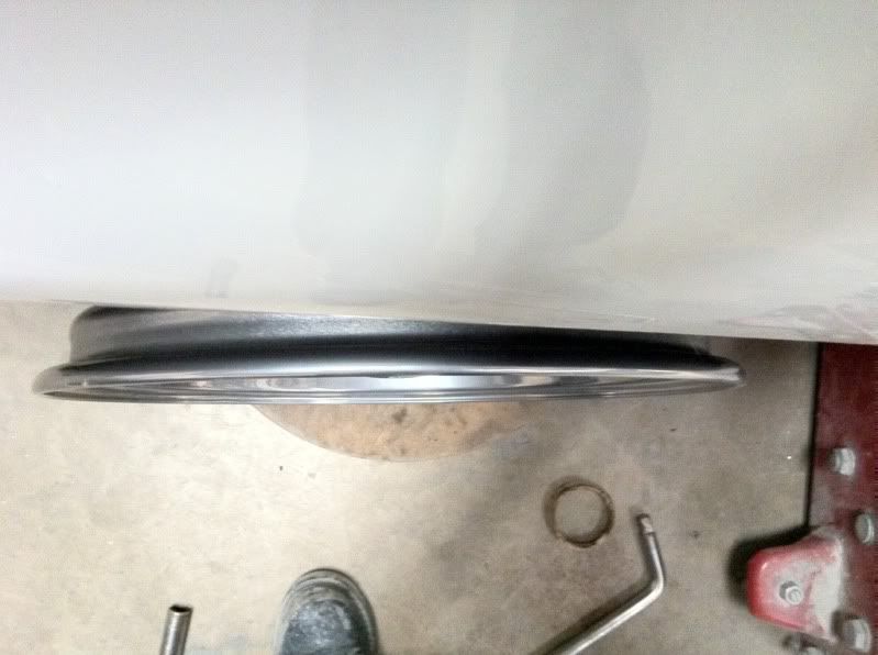

custom made adaptors for the new wheels to convert my current 4x100 to 5x112
trial fit of the new wheels

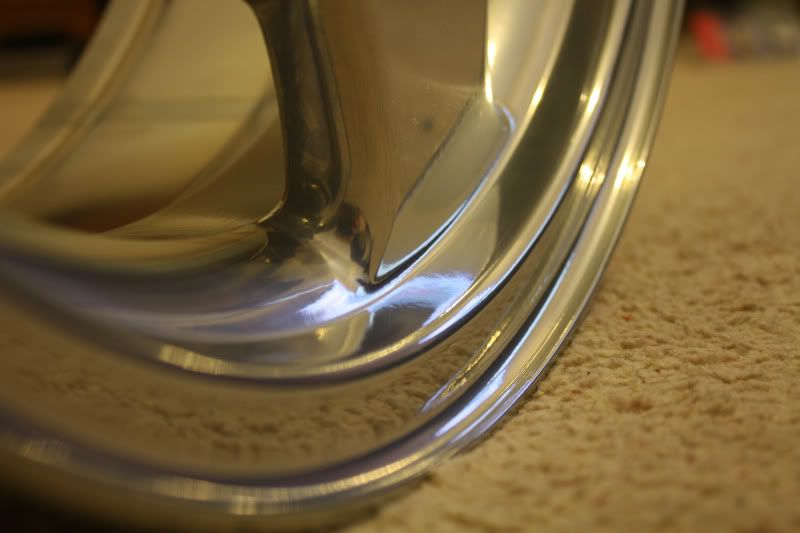

oh and collected one wheel from mike the polisher at the weekend............LOVE IT

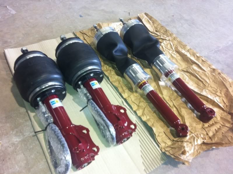

after ordering this I found out airlift don't make bags for a polo, in fact alot of companies didn't make bags for a 6n polo. so on the phone to bagyard in austria who made a custom set of supremes for a 6n from blisten struts and finished in Lexus pearl red

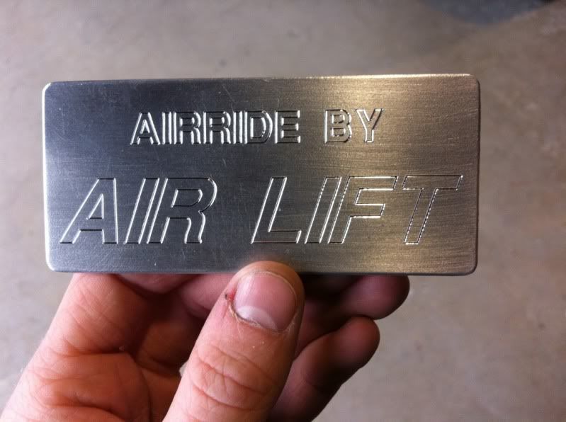

and my brushed aluminium engraved airlift plaque
mk5 rear lights
bumper primed
fitting the roof
