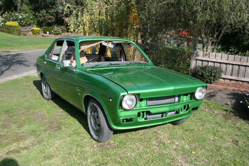

Here's my little beast that I've been building up for about 5 years now, Aus delivered as a 'Holden Gemini' - but let's not use the H word. I bought it fairly stock with the usual mods; bigger carby, exhaust, some lame single piece ROH rims and that's about the lot.
The Plan was to keep it fairly starndard, change to a slightly larger motor (2.0 from 1.6L), change the exterior around abit and get it on the road... All these things happened and i was happy with her, until i started picking with a tiny bit of rust in the roof, resulting in a full respray.

How she sits:
In this photo my rear spacers are on the front, i found out an hour before this car show that my rims didn't clear my front brake upgrade!
So ignore the horrible track difference!
I'm planing on dropping the the front by 1.5" and spacing the rears out about 10-15 mm, i've got some old school racks to go on the roof aswell.
There's still alot to do, alot of parts still need fitting and purchasing, i endevour to keep you all posted! I broke my water pump on the way home from a car show last month so it's out of action at the moment
Cheers guys, i hope you like it!
