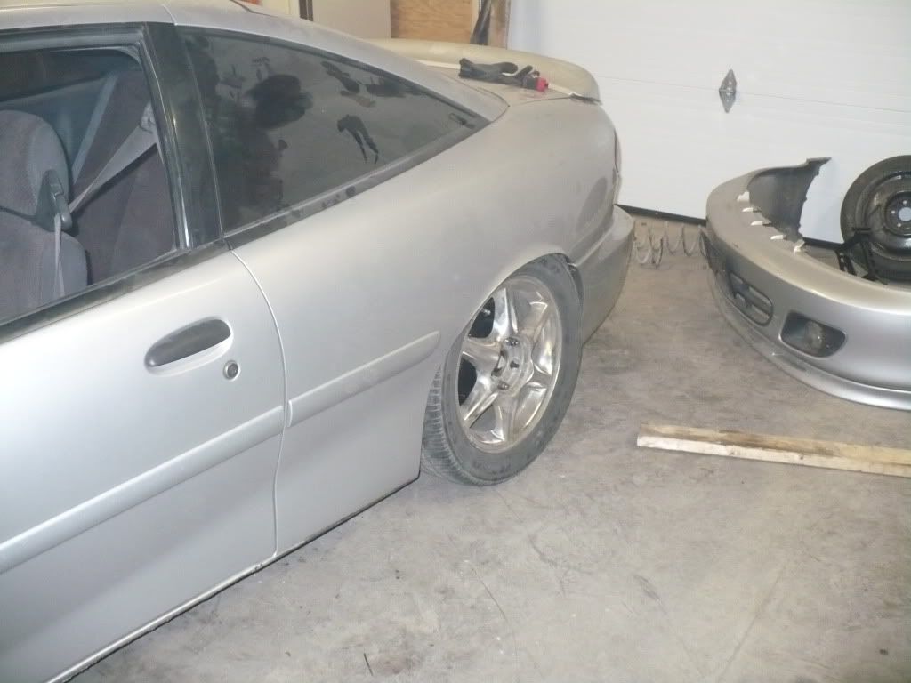

      Also shortened the trailing arms in the back, and now the wheels sit perfectly centered. Again, really happy.

      • Pictures of the rear with the vette wheels on, current tires are leaving Im pretty sure. I have the front adapters on, the new rear ones are 3/4 of an inch thicker. Life will be good. I'll need to roll the rear quarter more near the bumper side though. Which is not a huge deal, will just take some time and fiddling.
        Left side
        Right side
        Camber anyone? Currently set to be 0* where an alero would be at stock ride height.

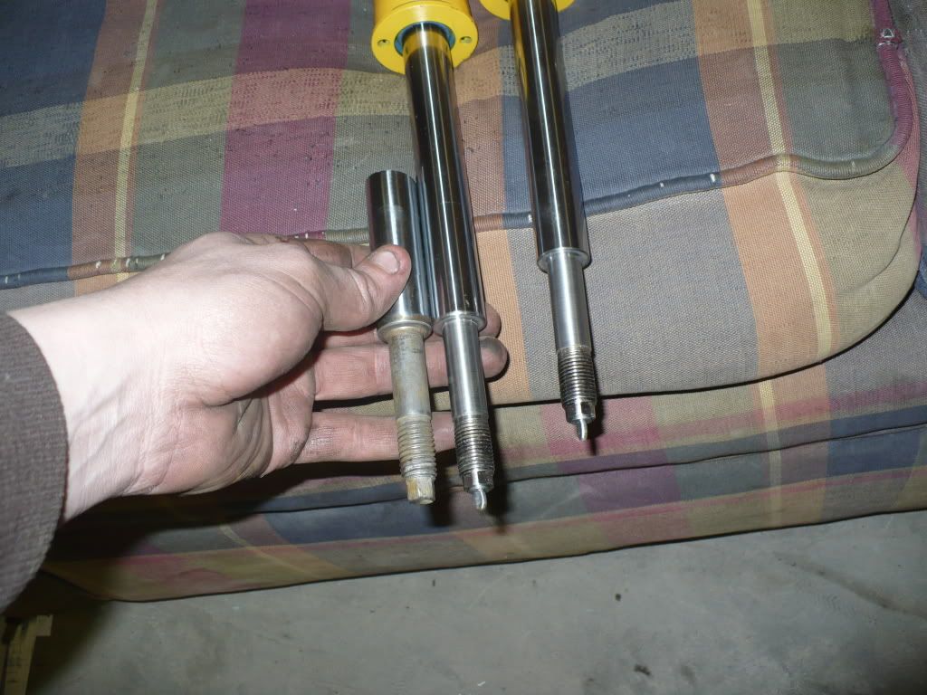

                                I managed to finish the rear end of my suspension set up last night, I used two new neon strut inserts from koni, which are essentially the same as j car ones. Had them machined to properly seat in the N car rear mount. It has all worked out exceptionally well. The pictures of the rear of the car are with the GC adjusters spun all the way UP.

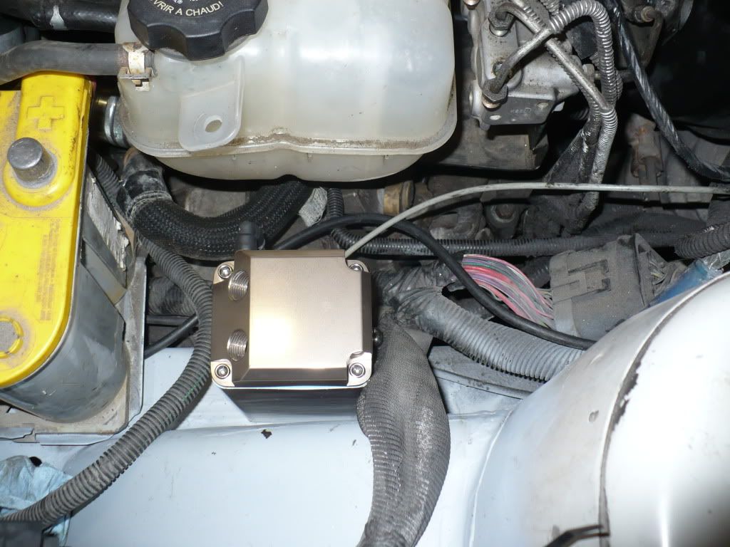

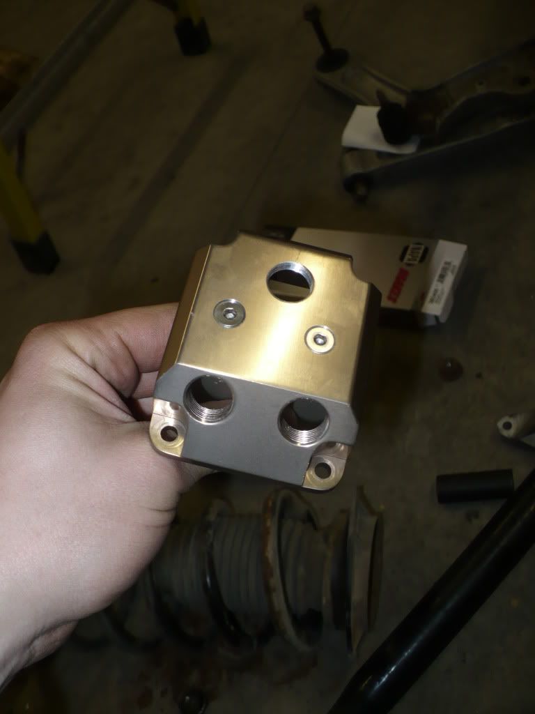

                                I also got to finish my catch can modifications today. I added a 3rd tapped hole and a seperator plate. Hard to explain the general function now, but you will all see once the lines and things show up.
                                Before:
                                After:
