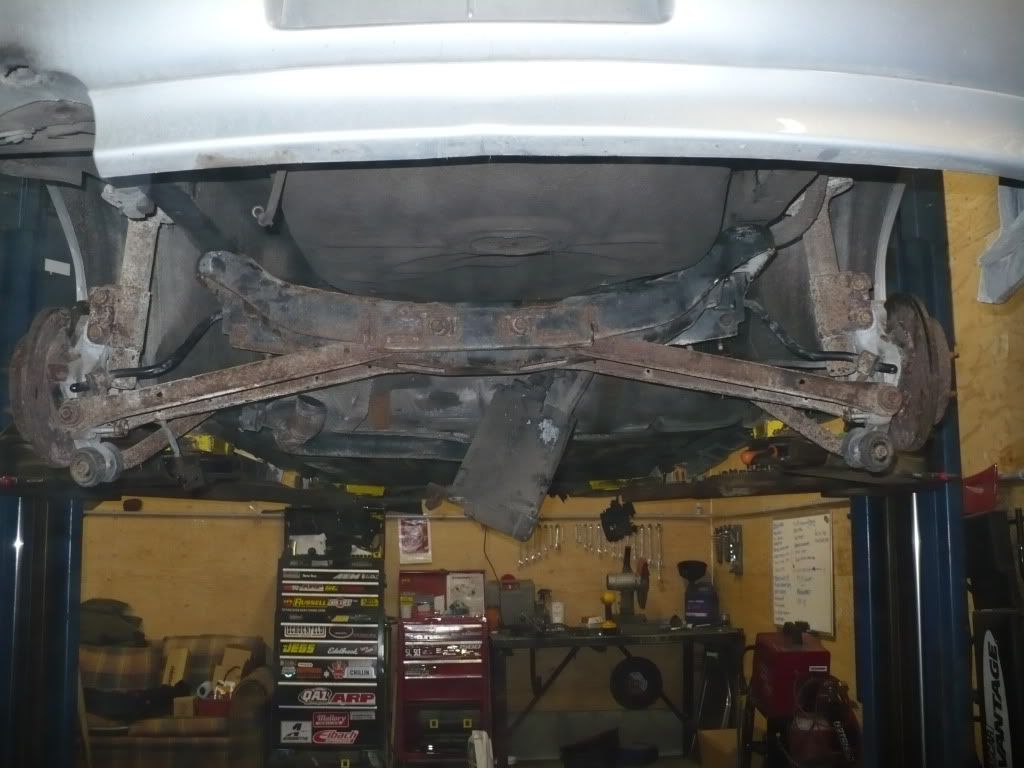

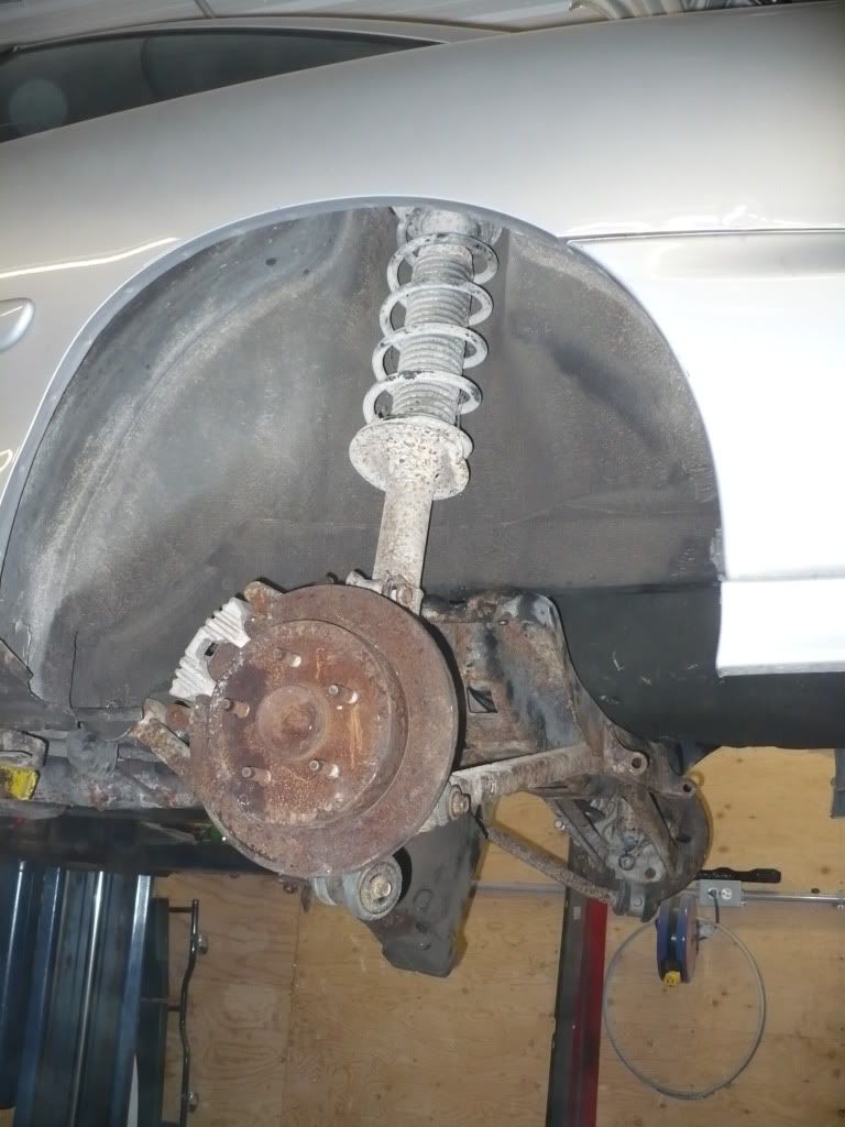

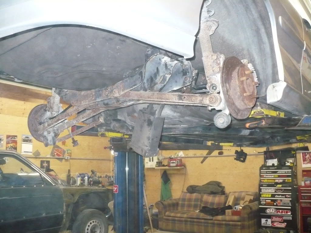

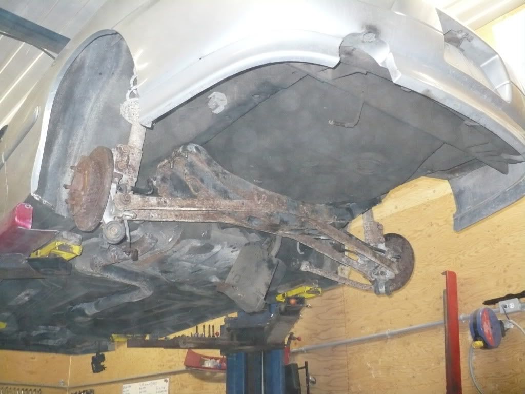

          Got the car away finally, and major progress occured this evening.
          Pulled out the stock rear solid axle/drums, etc. And mounted up the Independant rear suspension/rear disc setup. Keep in mind this will all be cleaned up, and for the most part be replaced, re-invented. But it was a hell of a night for progress.
          I'm extremely excited.
          How we started:
          Where we ended up:
          More to come

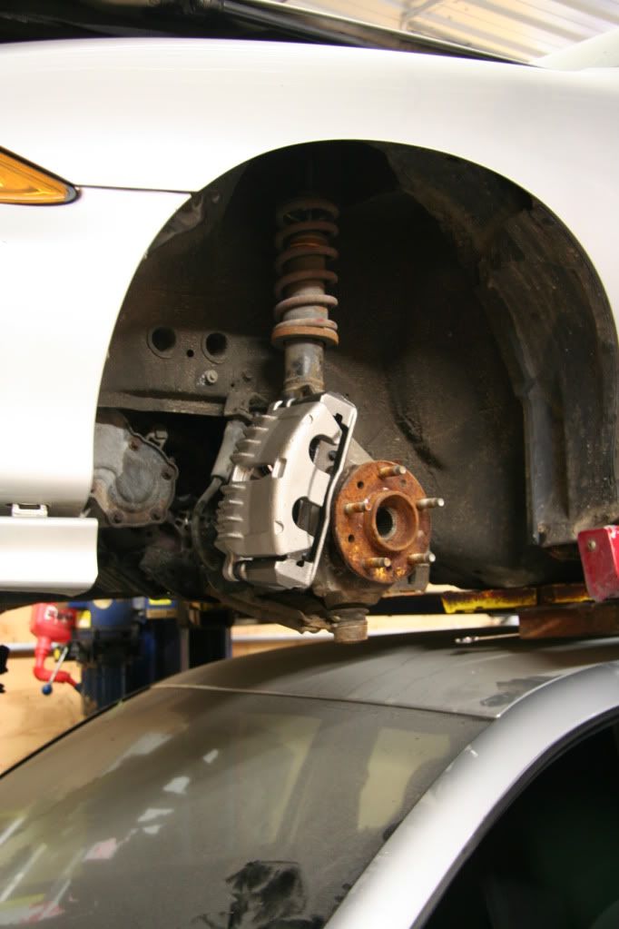

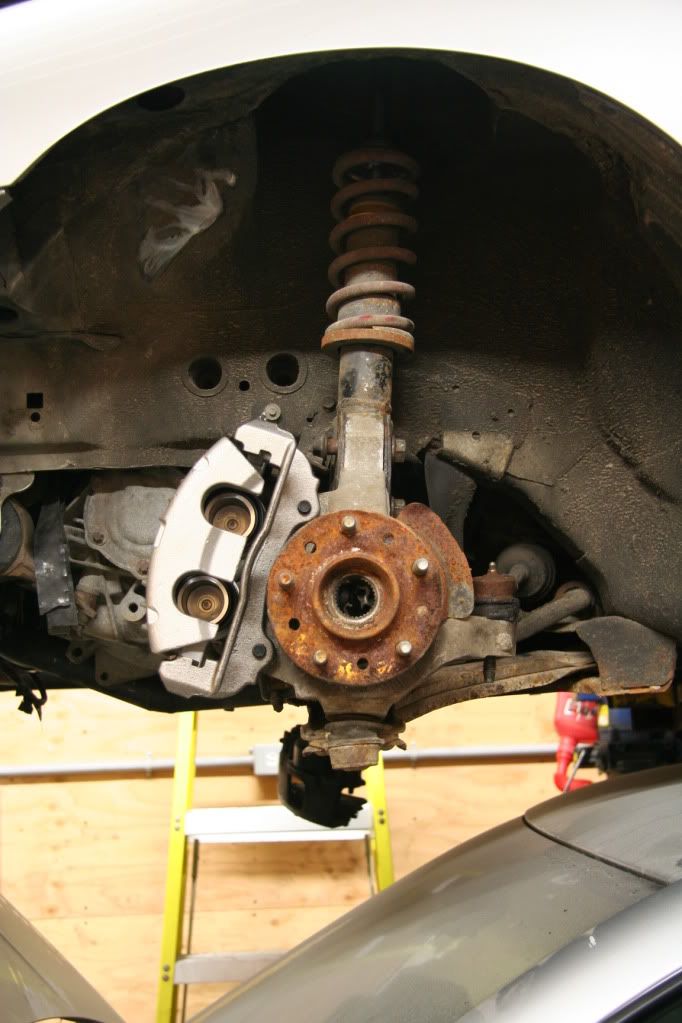

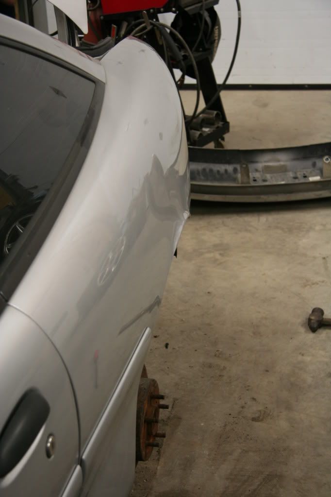

                Anyways, Camaro calipers showed up, and I had my first hand at fender rolling/pulling. To be quite honest I think it looks like total ass, but whatever. It's a cavalier.
                Ended up only getting one side "done" and half started the other side, then the bolt stripped out on the worn-the-fuck-out fender roller we borrowed.
                Like i said, I dont really care for it, but whatever.

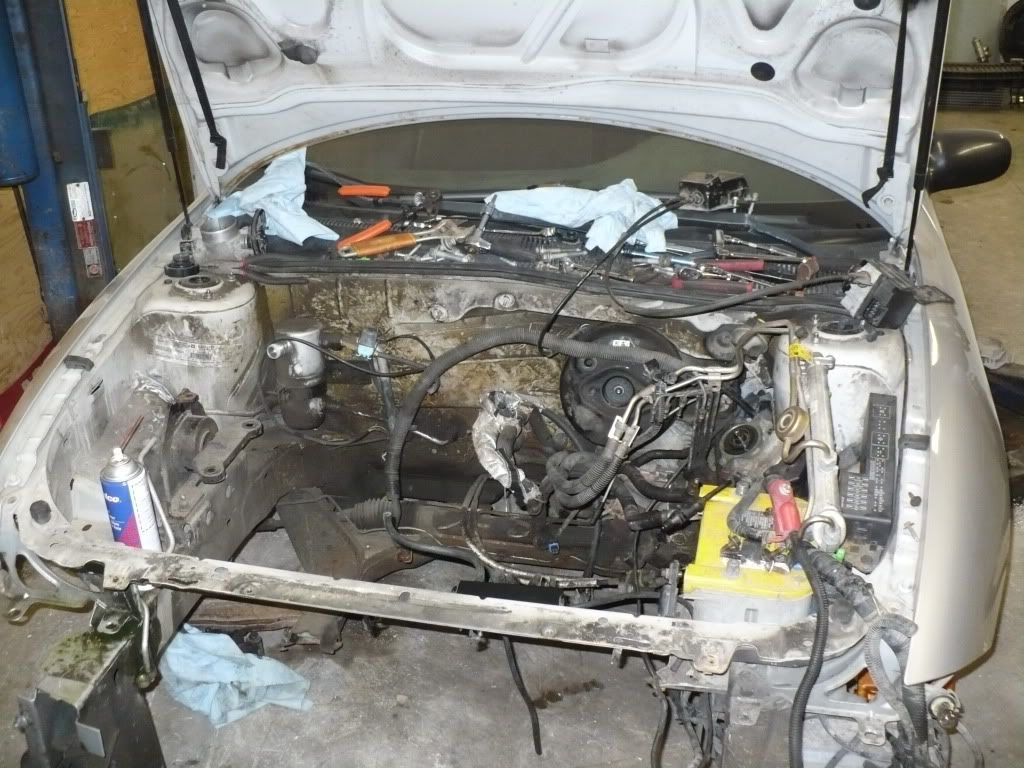

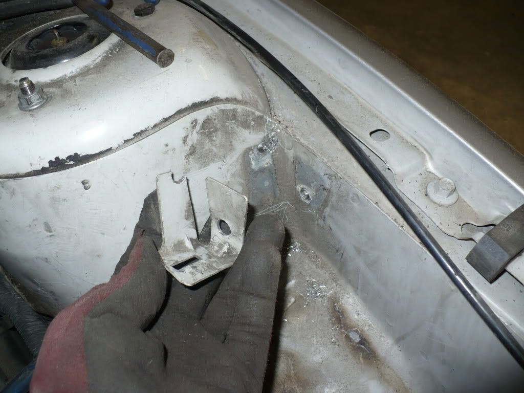

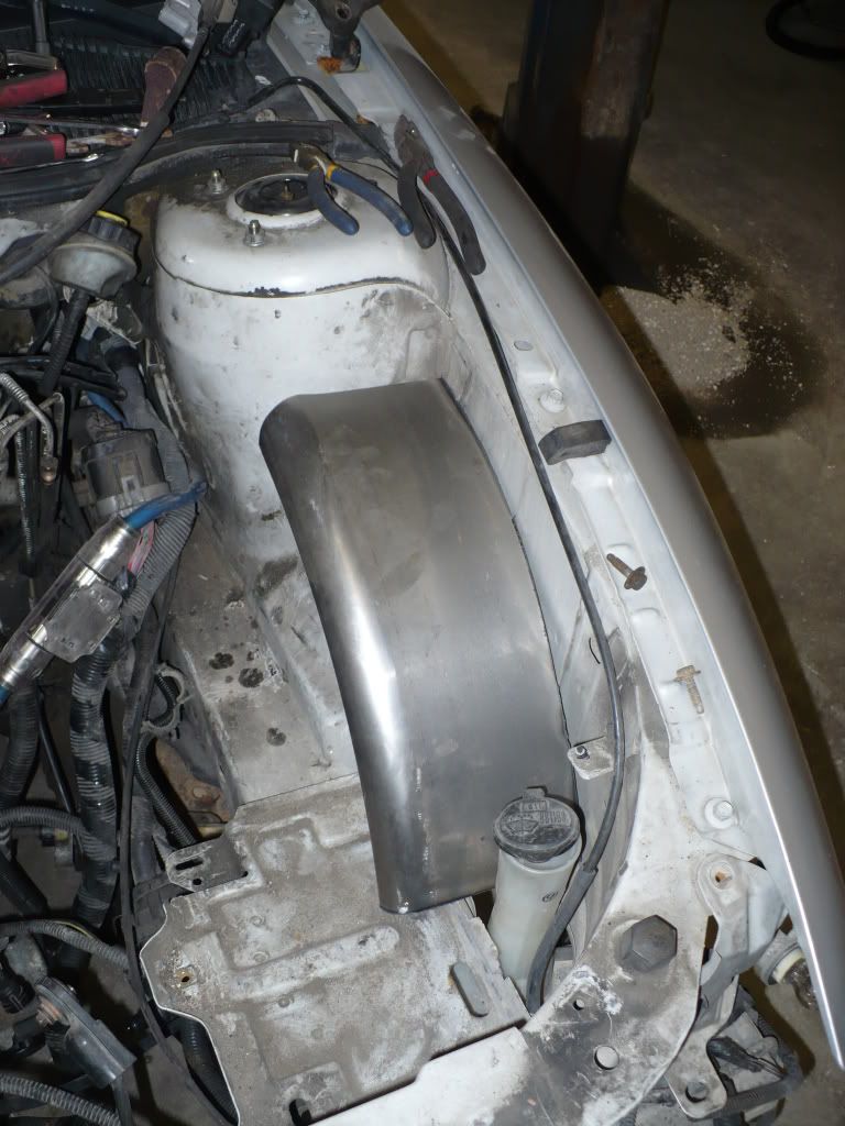

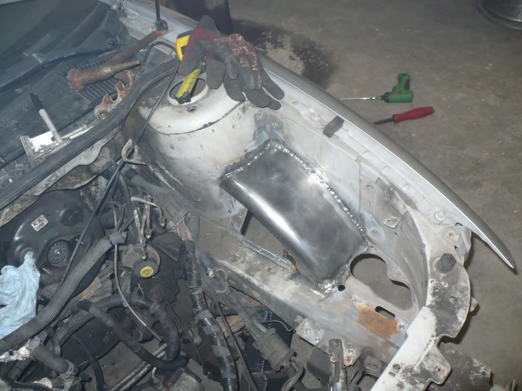

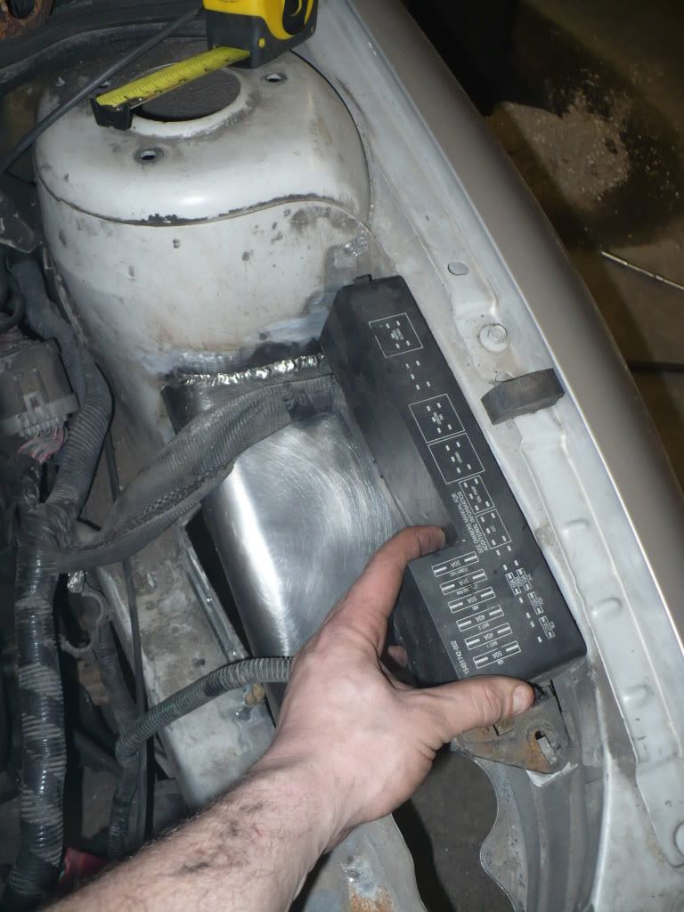

                  Been hauling ass the last two days.
                  Pulled the engine and started tubbing the wheel wells.
                  How I left the car Monday night:
                  And this is what I got done tonight:

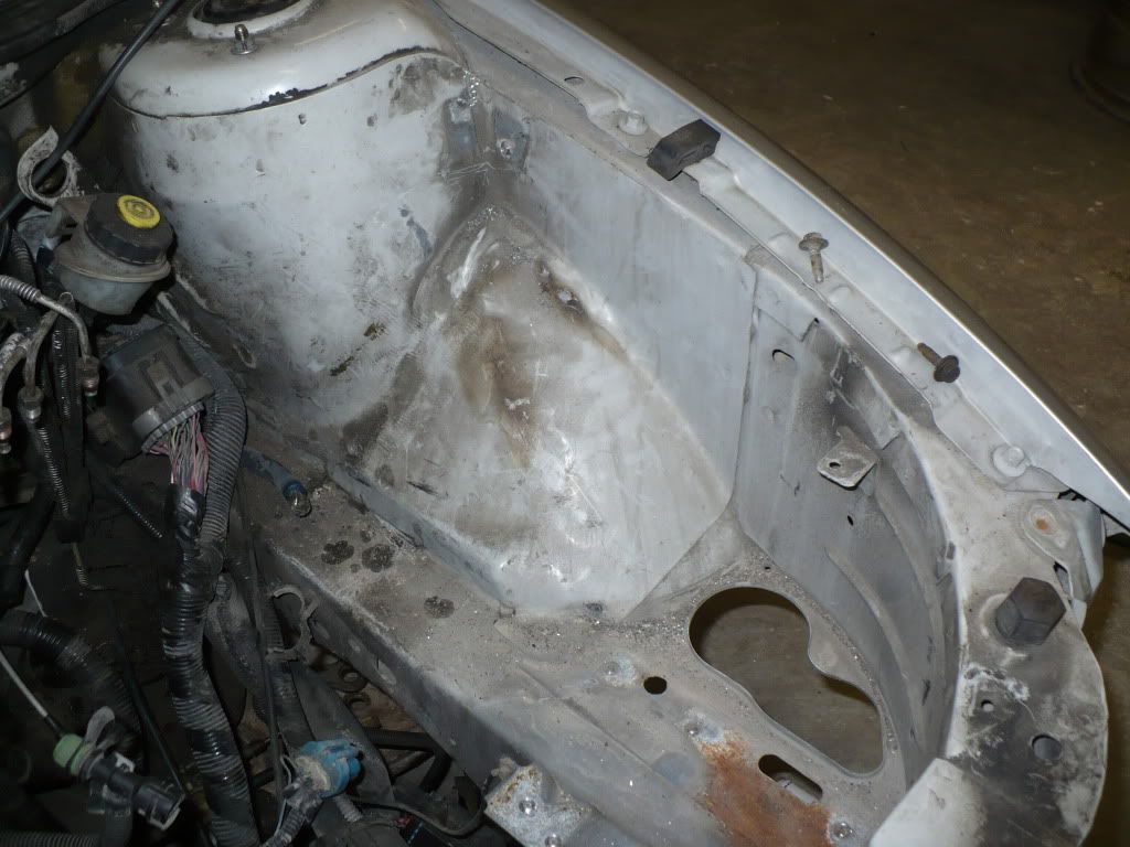

                  Started with this:

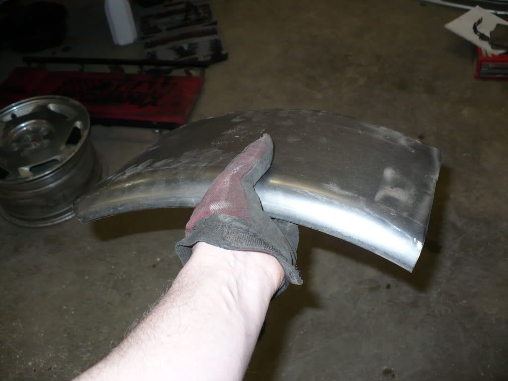

                  Trimmed a piece off to rough size:

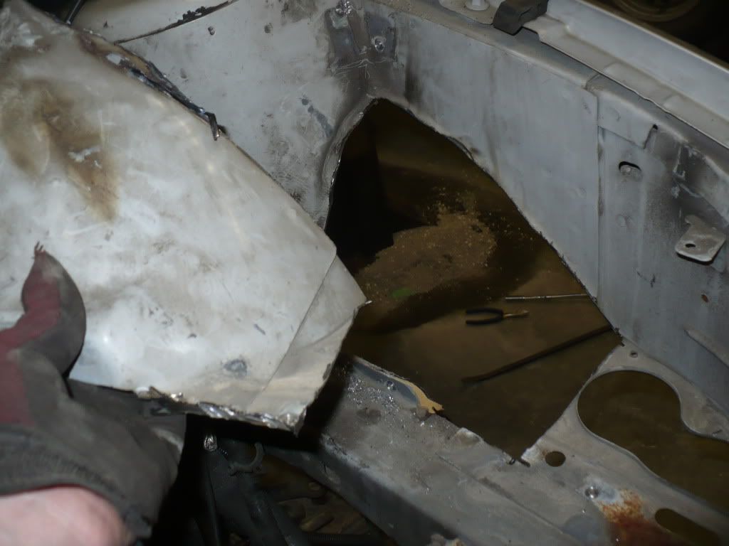

                  removed the battery tray, and original fuse block mount:
                  Took a big breath, and started cutting:

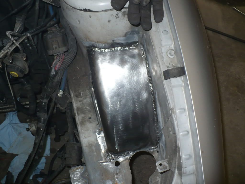

                  Wound up at the end of the day with this:
                  Stock fuse block will even still fit:
                  Will be grabbing some steel to finish the siding tomorrow, will hopefully have it all welded in, smoothed and seam sealed by tomorrow night.
                  Only thing is a may have to move the battery to the trunk, which really isn't a big deal.

                    Good to see you ditched the solid rear end and are going to independent. You'll love it.

                          I mainly did it for rear strut options... I had pretty well exhausted any way of gaining travel in the rear the way it was.
