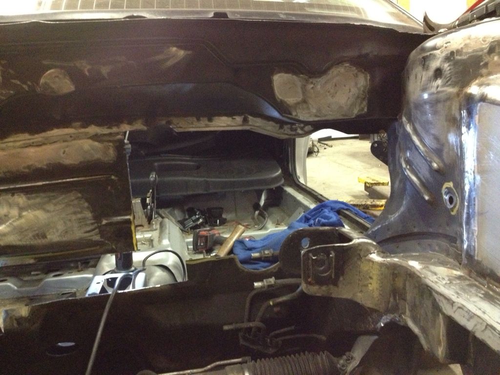

      Took the entire weekend off the car, was SO nice. Finally got motivated again today at work, and decided I'd start tackling that giant hole. How did I deal with it, you ask... I made it bigger.
      Start:
      Another one thousand spot welds later, voila:

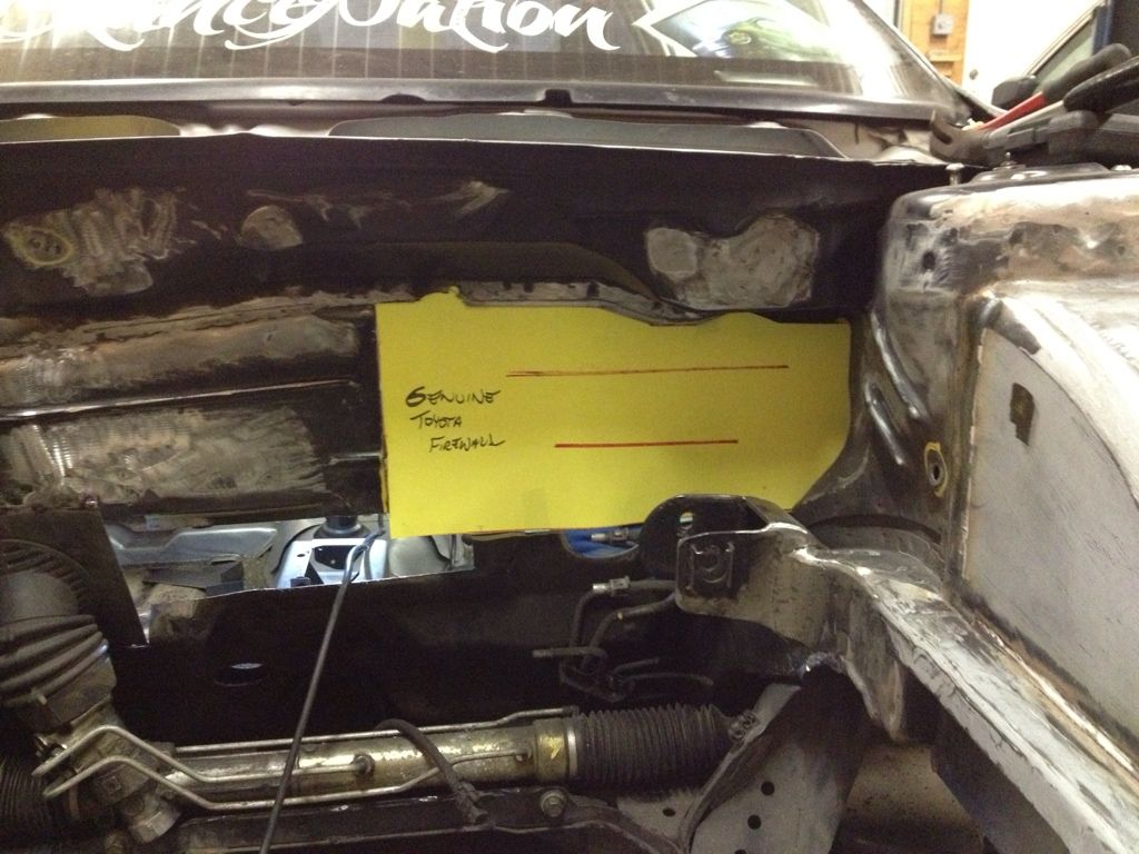

      Made up my template
      Steel made up:
      Going to have my cousin bead-roll it tomorrow, in a similar fashion to what is drawn on the piece of sheet-metal. Initially I had planned on bead-rolling it straight across, but if it wasn't completely identical to the factory straight bead-rolls on the firewall, my OCD would make my head explode.
      Once the main piece is welded in, then I can made the rest of the fillers and hopefully finish this firewall up by the end of the week.

          • I'd honestly try and see if your brother could match the beadroll. Shouldn't be too difficult if the die is the same width
                I don't has a brother.
