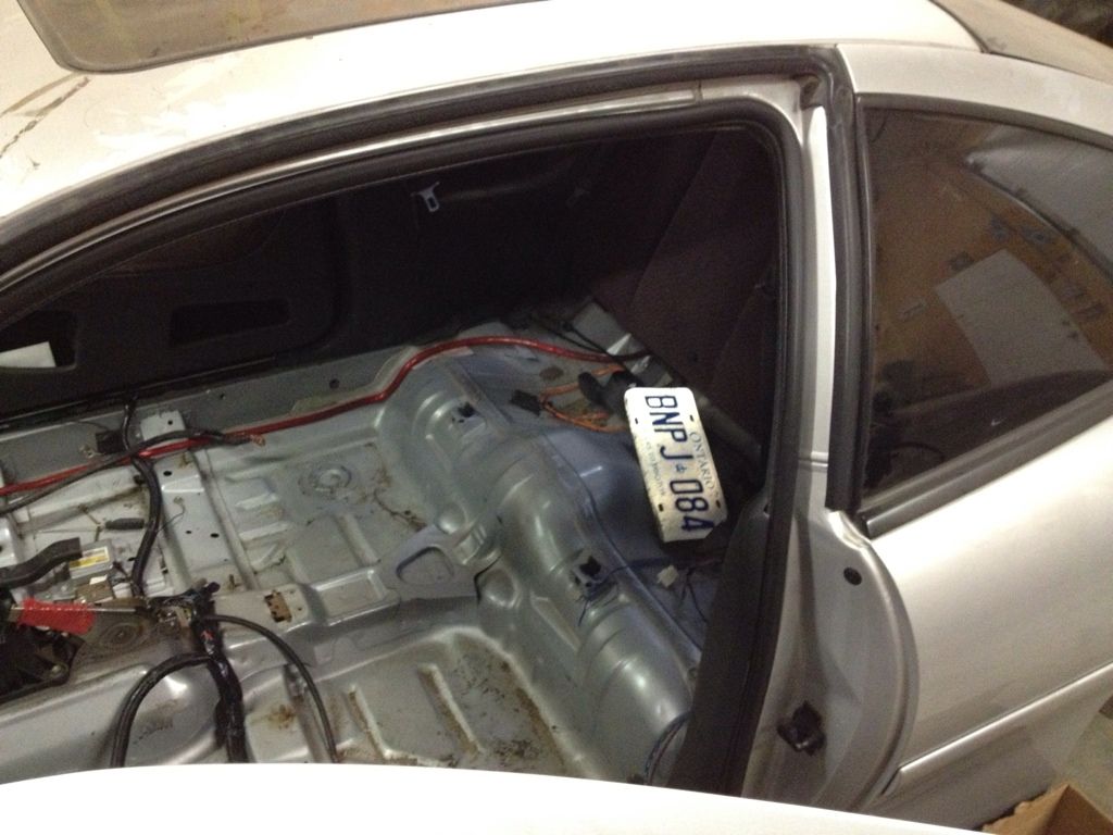

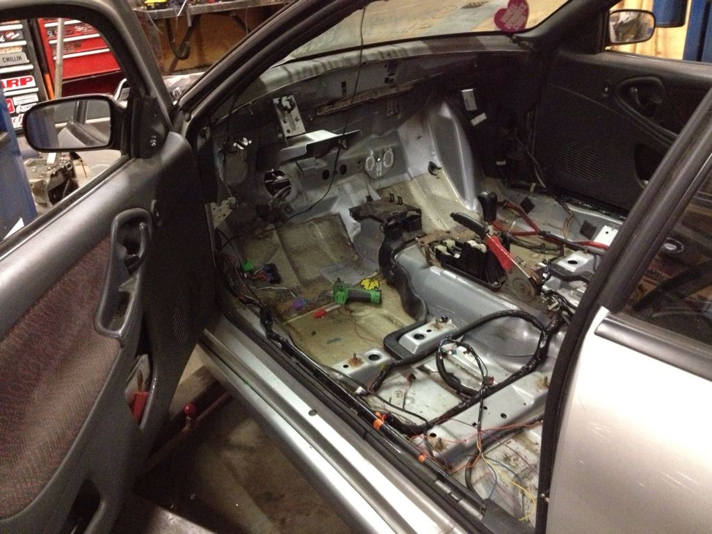

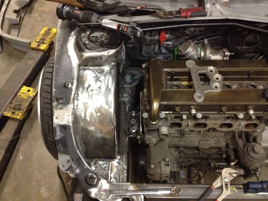

    Haven't worked on the car in a few days, dealt with some issues on the S10 I've been putting off for a while.
    Not a very exciting update, but I spent most of the night pulling what interior was left out, and began also removing the rest of the wiring from the car.
    After staring at the firewall from the inside, I gained a couple new ideas and improved on a few previous ones. I'm not going to elaborate on anything just yet, it might be letting certain cats out of bags that they shouldn't be let out of yet.
    Anyways, here's what I left it looking like tonight.
    I'll finish tearing the rest of the body harness out tomorrow as well as any remaining interior.
    Here we go again.

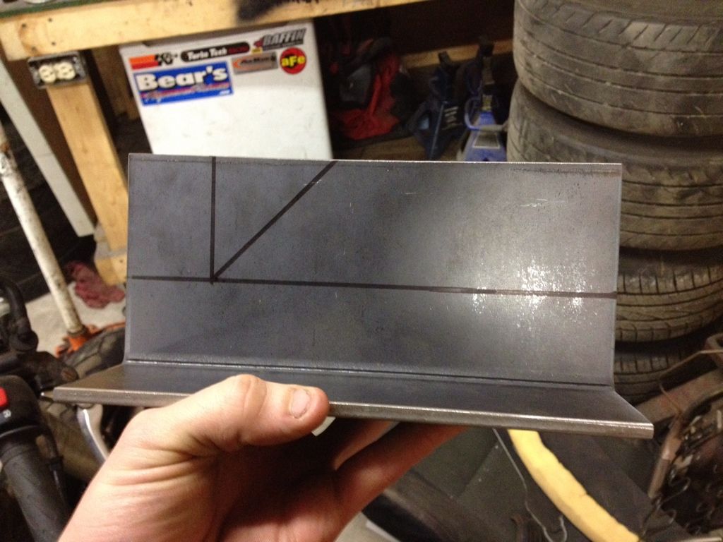

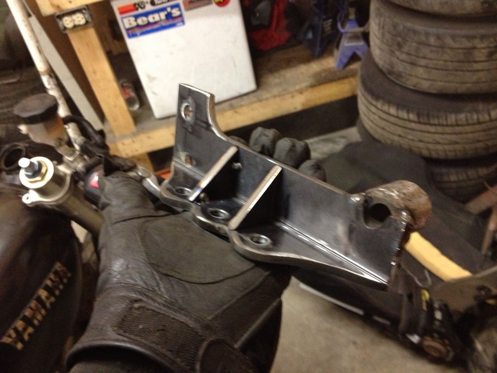

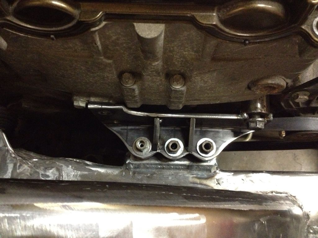

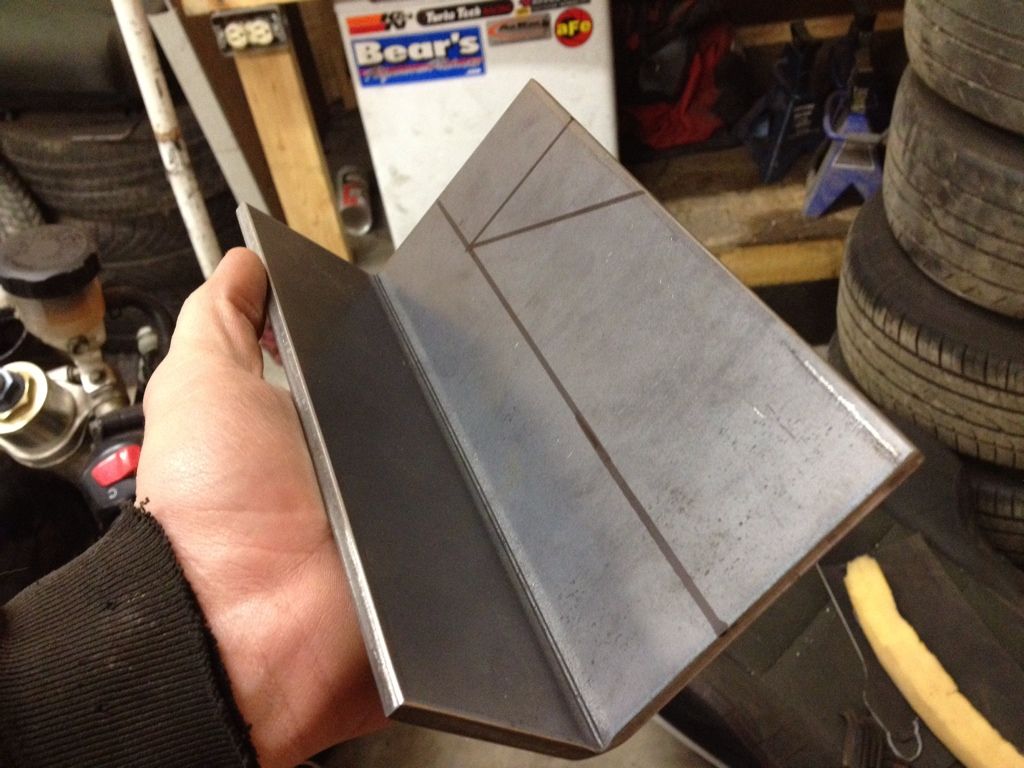

    Went to the shop late last night with some motivation and intent on starting and finishing part two of my engine mount re-design. I almost immediately fucked it up, but all was not lost. I decided it was a good chance to make it work and just to verify that this was going to work and look decently.
    I'm happy to say that it will. I preach constantly about measuring three-thousand times and cutting once, but I got jumpy last night and now I get to start over. Regardless, the few hours I spent last night were not a total waste.
    Started with this:
    Which turned into this (you can see that I cut the vertical height too short, poop):
    And mocked up in the bay:
    I'm very happy with how it turned out, it pleases me to see that it is very tucked in to the engine.
    I'll get it redone this week. We're getting closer! Soon enough I'll be able to build a new downpipe and charge pipes, and start doing the fun stuff again.
