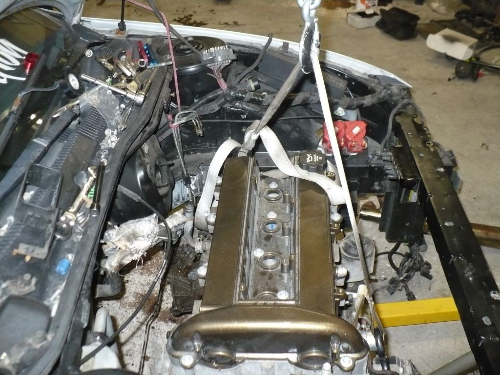

    Got the subframe out tonight, pulled the exhaust and downpipe, I/C pipes and the intake. Everything that needs to be moved or modified when the engine is rotated is now out of the way.
    Hopefully tomorrow or Saturday the engine will be mounted in its new orientation, and I can get the fab work started to redo the necessary piping attached to certain engine parts.

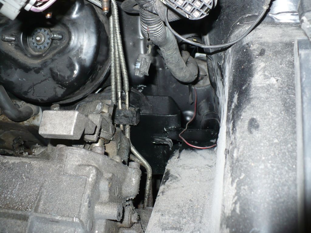

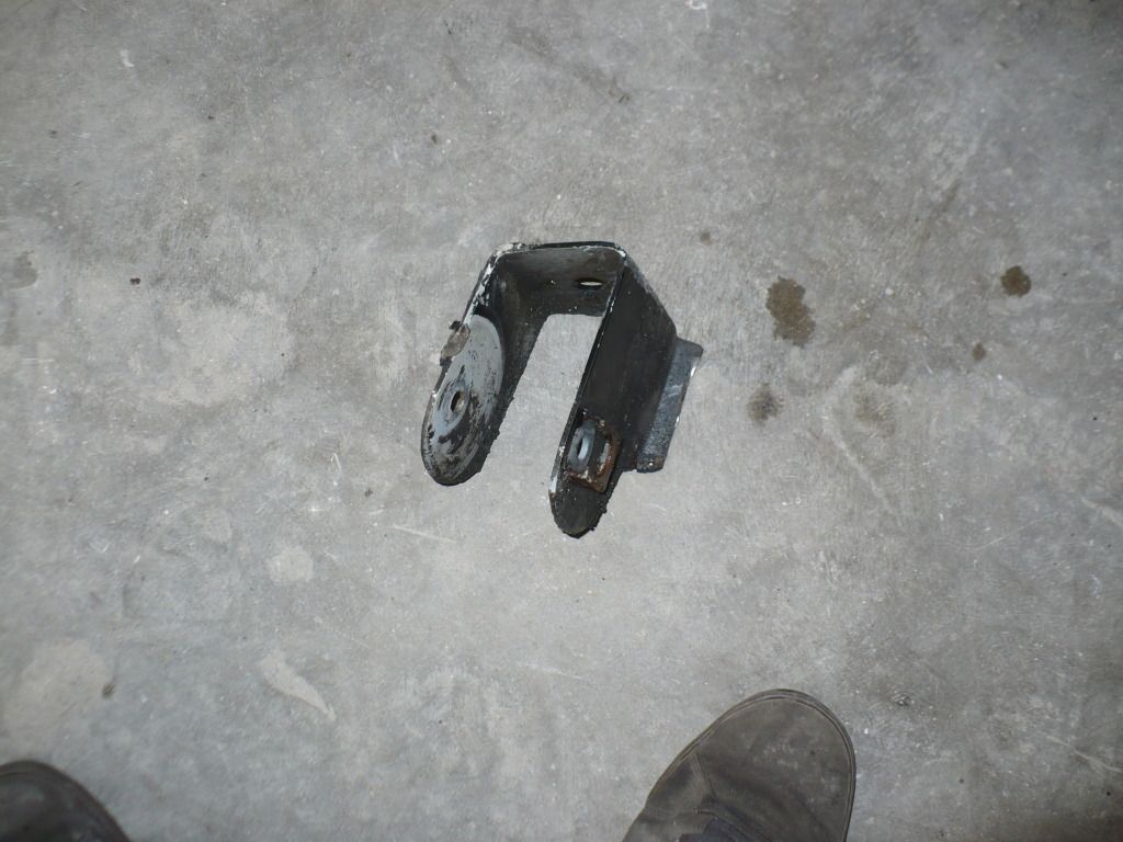

                  • Got some work done tonight, been humming and hawing the last few days about how to go about this, and I finally have decided/taken the leap. Started off by carefully cutting out the rear transmission mount on the body. Then started mocking in the engine. Bolted in the front trans mount and the main engine mount. Quickly found out when i brought the diff up with the jack, the engine does not sit square to the body, which i expected.
                    Front transmission mount will have to be cut off and moved back - not the end of the world. Next matter at hand, with the engine lightly rotated, there is a nub on the trans that hits the frame rail. I'm quite certain that moving the trans back will resolve this issue, but if not, I'll have to do a small notch in the frame, again, not the end of the world.

                    This little prick was an absolute asshole to get out:
                    Said angle:

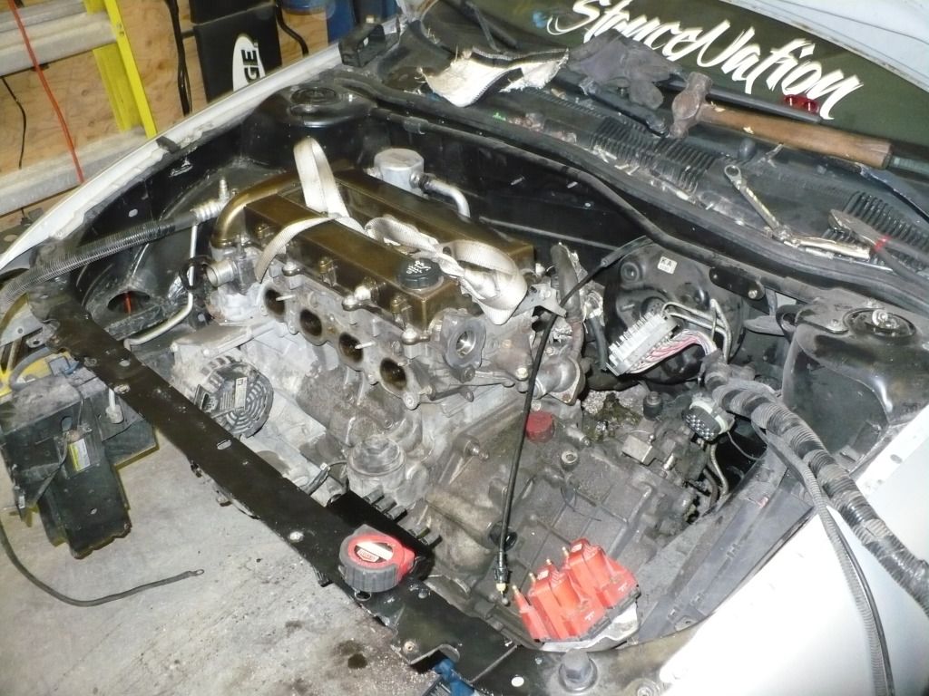

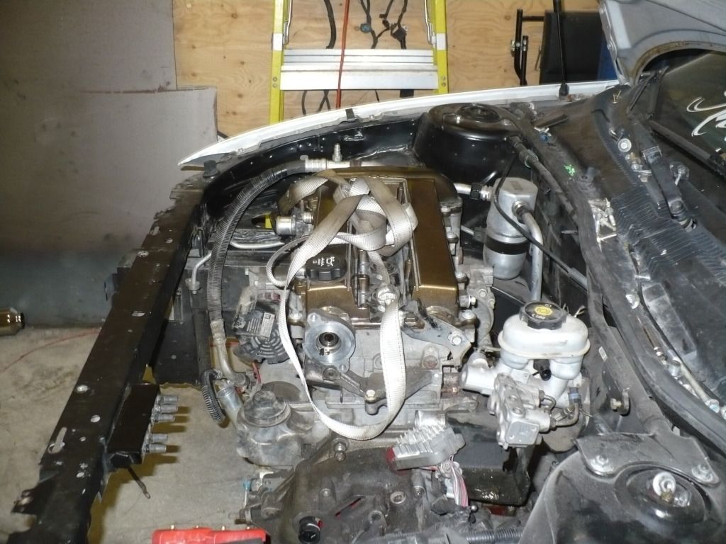

                            Worked for hours on end Thursday night, and got seemingly nothing done. God, I **** these kinda nights.
                            Started out by pulling the engine again, and removed the front trans mount. I then reinstalled the engine, finding the next step was to notch the rear pinch weld on the frame rail, so the trans mount can come up.
                            After dinking around with all that I finally got the engine to sit how I want.

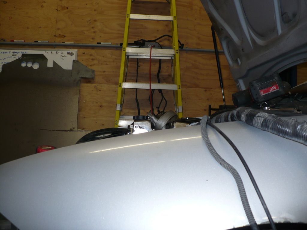

                            After sitting and staring for a few minutes, I decided to close the hood and check some shit out. To my surprise there is a tonne of room between the valve cover and hood. Opportunity.
                            I've got a few tricks up my sleeve, that, if they pan out, I'll be raising the engine straight up at least an inch and still be able to close the hood.
                            Okay, pics.
                            I've just now realized that pictures of the engine make it look absolutely no different from stock location. I assure you, it is. Just eye-balling but I would say the diff has come up about 2".
                            Fucking car........
                            I will hopefully go out and get the engine raised up today, notching various parts of the frame rail and others as I go. Hopefully get a start on the mounts and be able to take the jack stands out, etc.

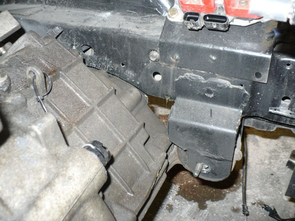

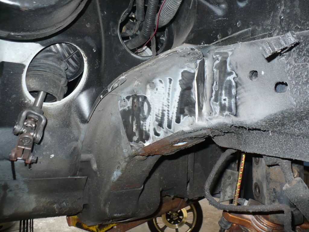

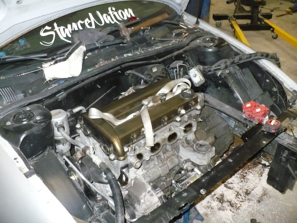

                              • Had a real good afternoon/evening at the shop, finally felt like I got something accomplished. Modified the rear trans mount and got it welded back on the car. Rotated it 90* around the trans mount and then notched it to hug the frame rail, welded, painted and all the good shit.
                                The engine will be raised a total of 1.5" and has also been rotated approx 30 degrees. The differential has come up, I would guess, about 3 inches. I had to notch the drivers frame rail to accomodate part of the transmission.
                                The passenger engine mount bracket is currently cut down 1.25", it is ghetto rigged right now for mock up. I will be fabricating a completely new bracket that will be shortened a total of 1.5"
                                I'm real happy with how it is starting to shape up
                                The notch, will be forming a boxed notch to weld in here to restrengthen the frame rail.

                                Some general engine position pictures:

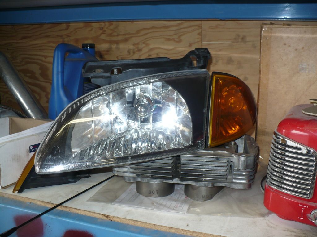

                                On an unrelated note, blackhoused my headlamps since I've ordered black wheels, I figured I needed to tie them into something
