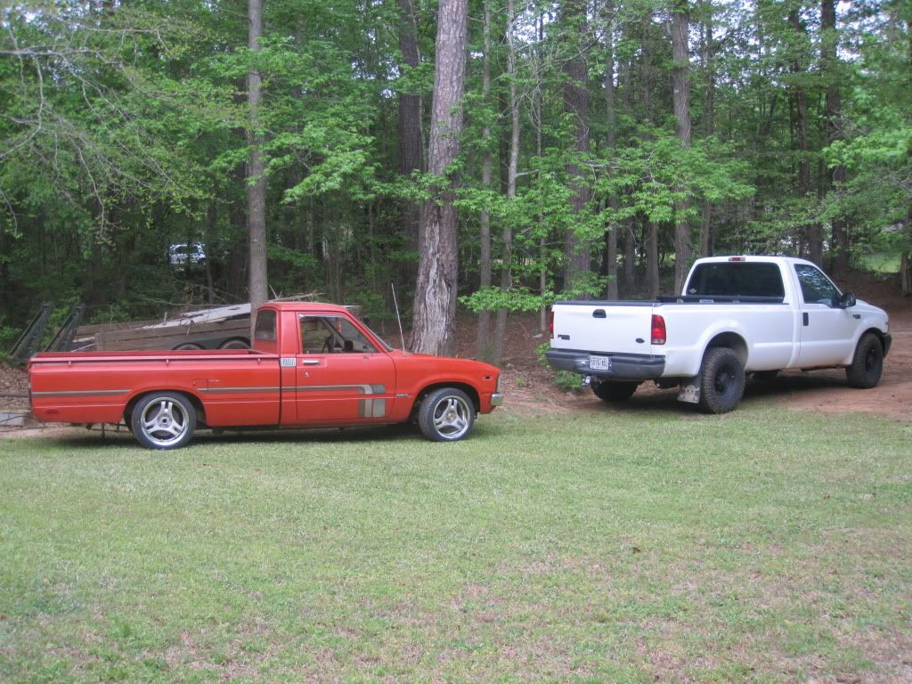

    I've had this truck for a few years now. The only one of many that I just cant let go. I'm pretty far along into the build though so I guess i'll just hit the highlights... It's a 1980 toyota sr5 looooong bed.
    The day I picked her up

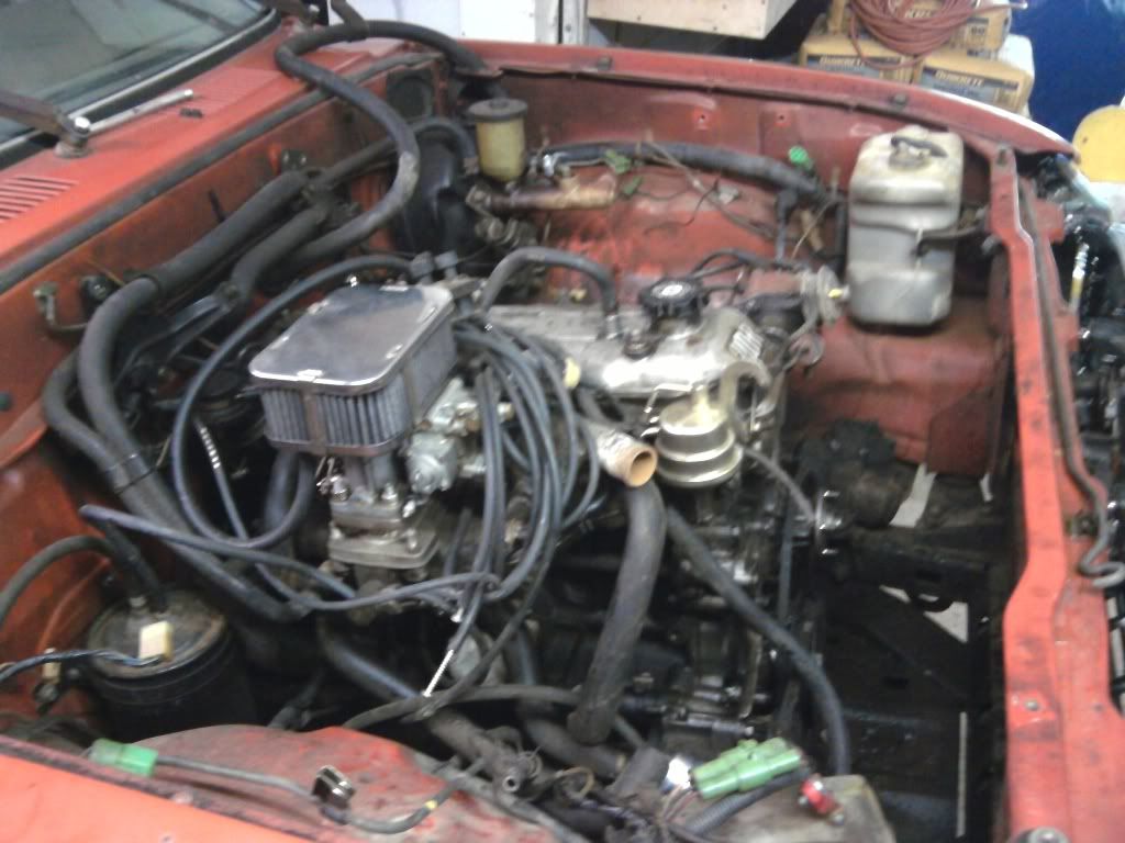

    And this is where the motor gave out on me. Why repair when you can upgrade? I blew up the beastly (80ish hp) 20r so I decided to swap in a 2rz from a 96 tacoma. The motor literaly only has 200 original miles on it. The truck was totaled right after it was bought.
    Bye bye 20r

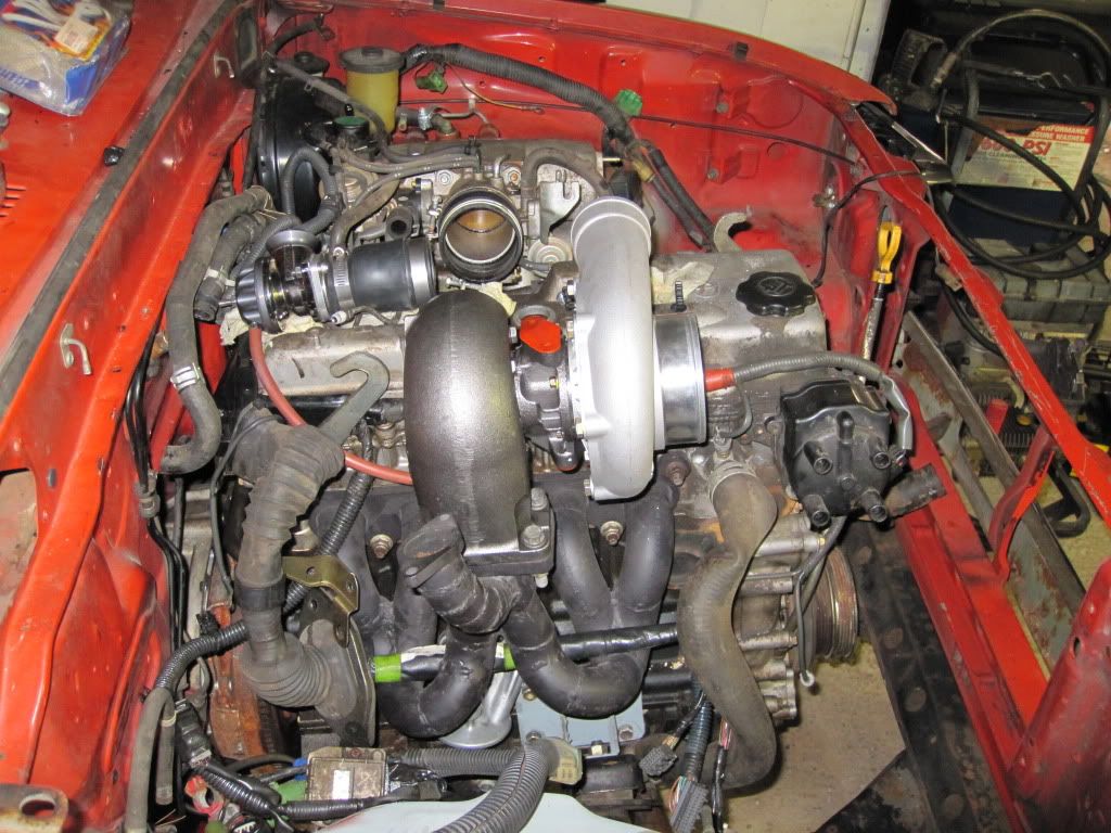

    I've never seen this swap done in this model truck before and if it has been i'll be damned if I can find any info on it so i'm just making it up as I go haha Had to make new mounts of course...
    And an oil pan...

      Now the swap is an increase in power and all buuuuut I want to go fast
      I'm going to have to build a different turbo mani since this one sits so high.

          that turbo is tiny, not really thought its gigantic.
