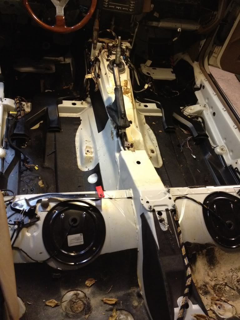

          Also tore out the interior to change to black and install stereo.
          drilled new holes for the door speakers.
          I wired in the head unit and finished up the speaker wires.
          Started removing some of the sound deadening. First was the rear, cause it was terrible from the PO spilling paint on it. Wasn't nearly as hard to remove as I imagined.
          A couple of hours later... got all 3 sound panels removed and pulled back excess wires. That huge wad of wires on the right ran all over the back seat. Now it's temporarily tucked behind the panel. Wrapped the remaining wires in frcition tape.
          Where it's at now:
          Next projects are more work on the floor to get it ready for paint and welding in roll bar.
          025garage

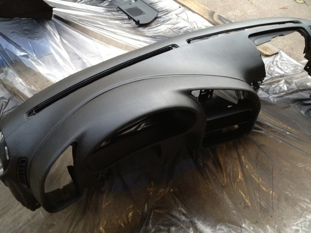

            I Like Are you painting the floors white again? Also, was that Dupli-color interior vinyl paint?
            R.I.P P.WALKER 2013/11/30
            • #66
              Thanks! Yes, the floor and roll bar will be painted in white. Duplicolor grease remover + adhesion promoter + matte vinyl/fabric paint. Plan on redoing door/rear panels eventually, but pretty happy with how it came out.

                        What type of paint/dye did you use on the dash parts? I've been wanting to do that for a while, it looks great!
                          It really isn't hard and the finish is near perfect, so I say go for it!
