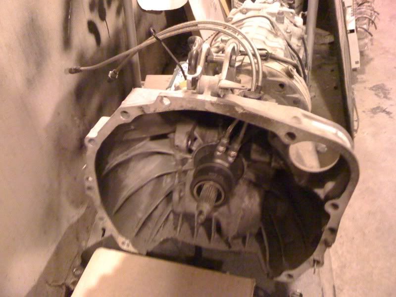

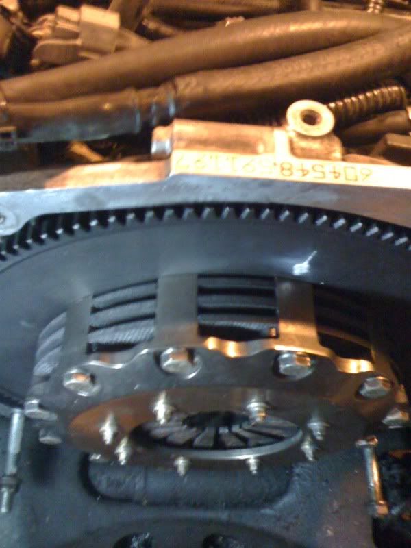

so after dealing with the constant downs of the car with one problem after another i decided to do it all at once this time and be done with each section and not have to worry about it any more. so in place of the buster wrx 5 speed went in a jdm version 7 sti 6 speed. with a tilton twin disk clutch, hydro through out, and master cylinder throw in some kartboy shifter bushing, tranny x member bushing, tic shifter linkage bushings and a kartboy short throw done...

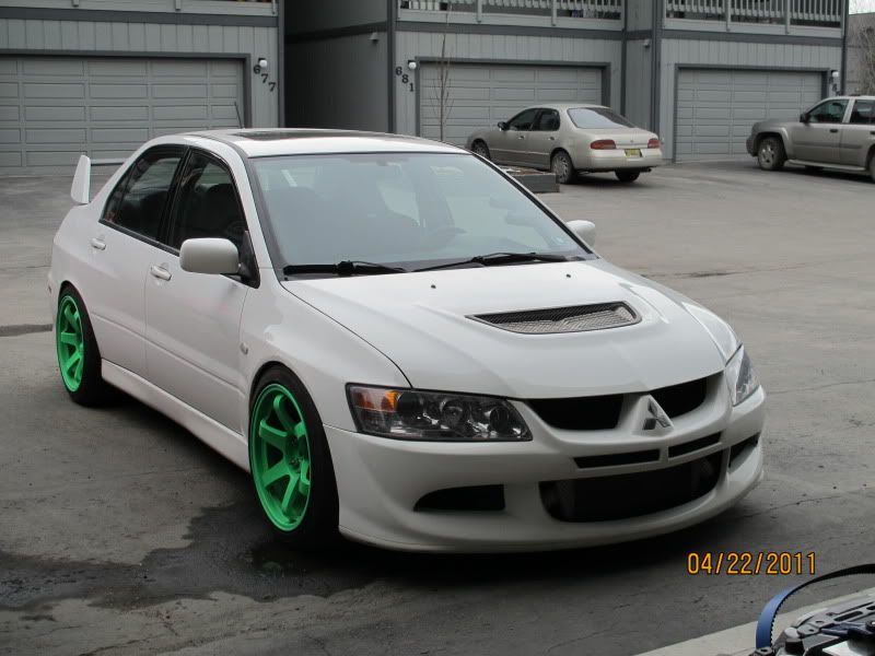

i just took the car to the shop i work at over the weekend and hopefully i will be able to get some more updates on her. sorry for the long read. and just for fun some pics of the old lady's evo
i won't drag out her car like i did mine but we picked it up with the grids and she swapped it over to the 11r's we will be going lower with it but we've got so much on our plates right now and with winter coming up we are going to put it on hold till after some snow clears
