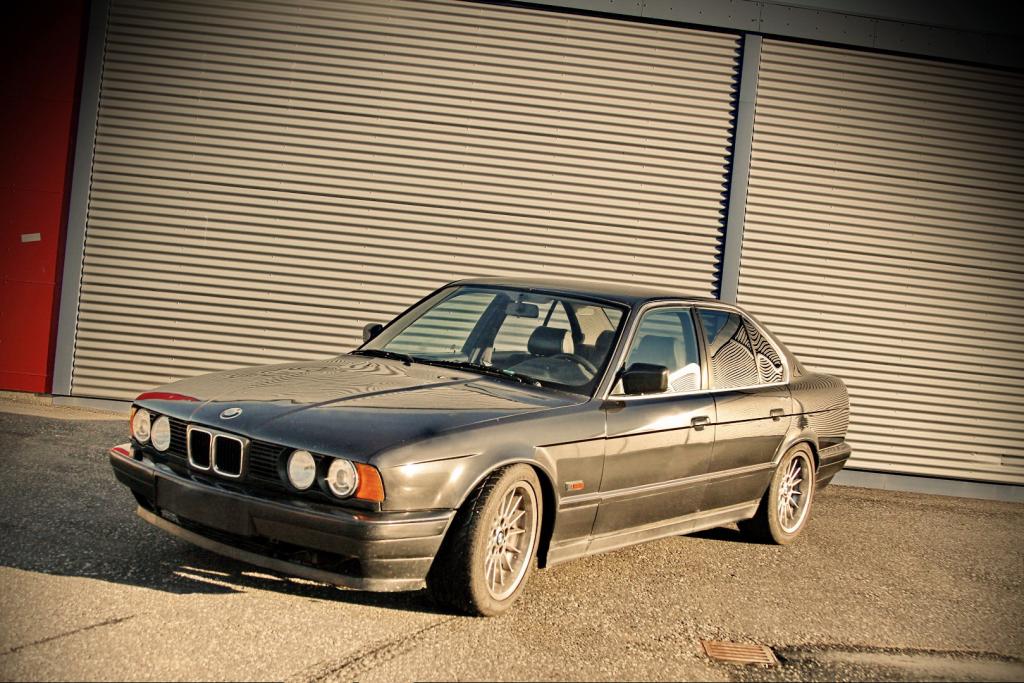

    This is a E34 wich i bought in near mint condition, needs some TLC but i think i will have it completely sorted out before the beginning of next summer
    Looked like this when i bought it about a month ago, except it had steel rims:
    And this is how it looks today:
    Suspension is Bilstein (AC Schnitzer) shocks & H&R coils!

              Crappy Cell Phone pic of it sitting on 18" Alpina rims...
              E36 M3ti TURBO | E46 328i DAILY | E60 535d M-TECH | DODGE RAM - CUMMINS TWIN TURBO
                nice rims yo

                  Few better pics;
                  Still to come;
                  V8 front bumper, smoked indicators & hella-dark headlights.
