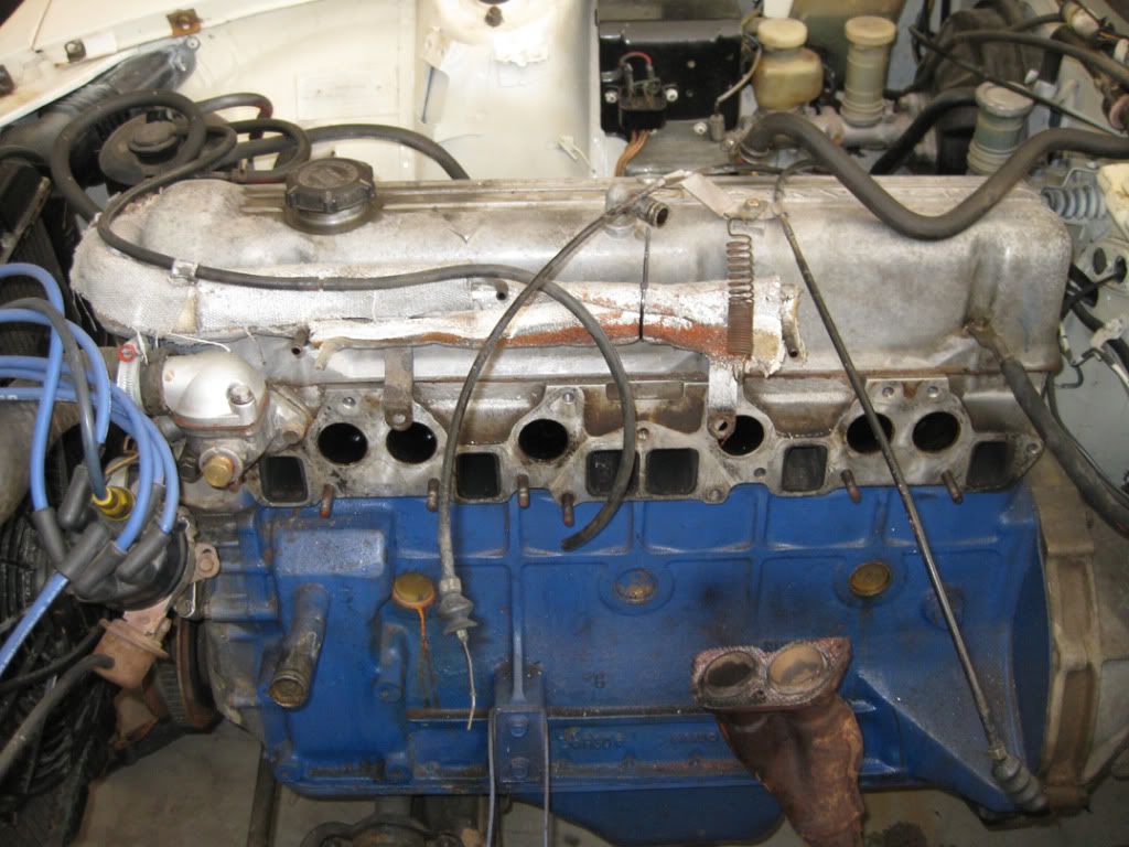

so i've started tearing off the head on the Z

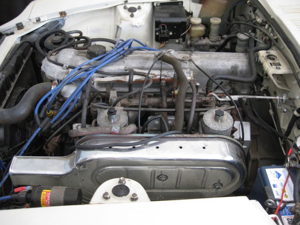

but before i did that i took a few reference photos, so when it came time to re-assemble i could remember where shit went

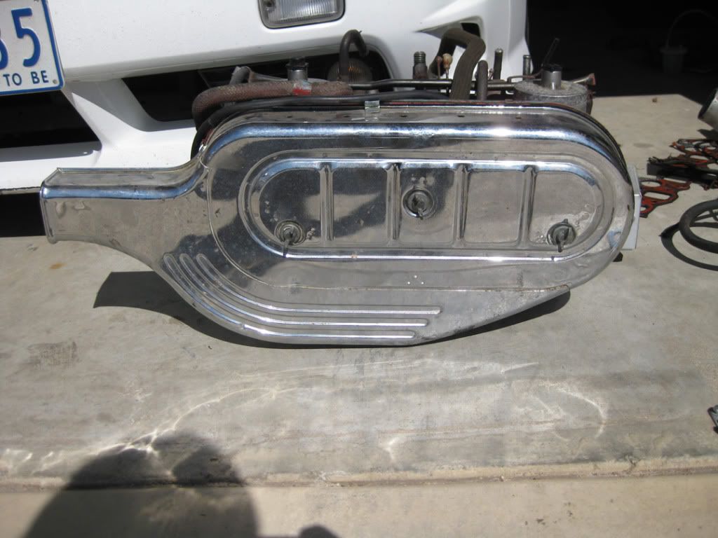

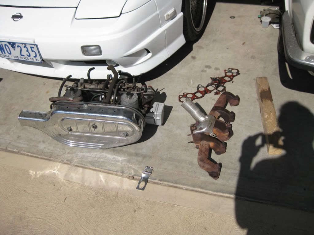

ta da, carbs and exhaust manifold out
so much open space in the engine bay with the manifolds gone

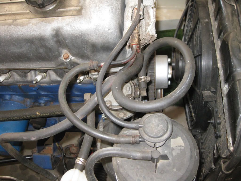

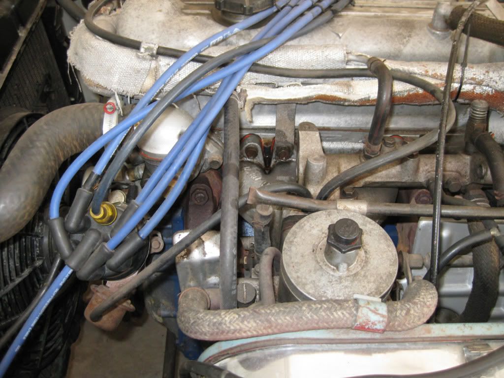

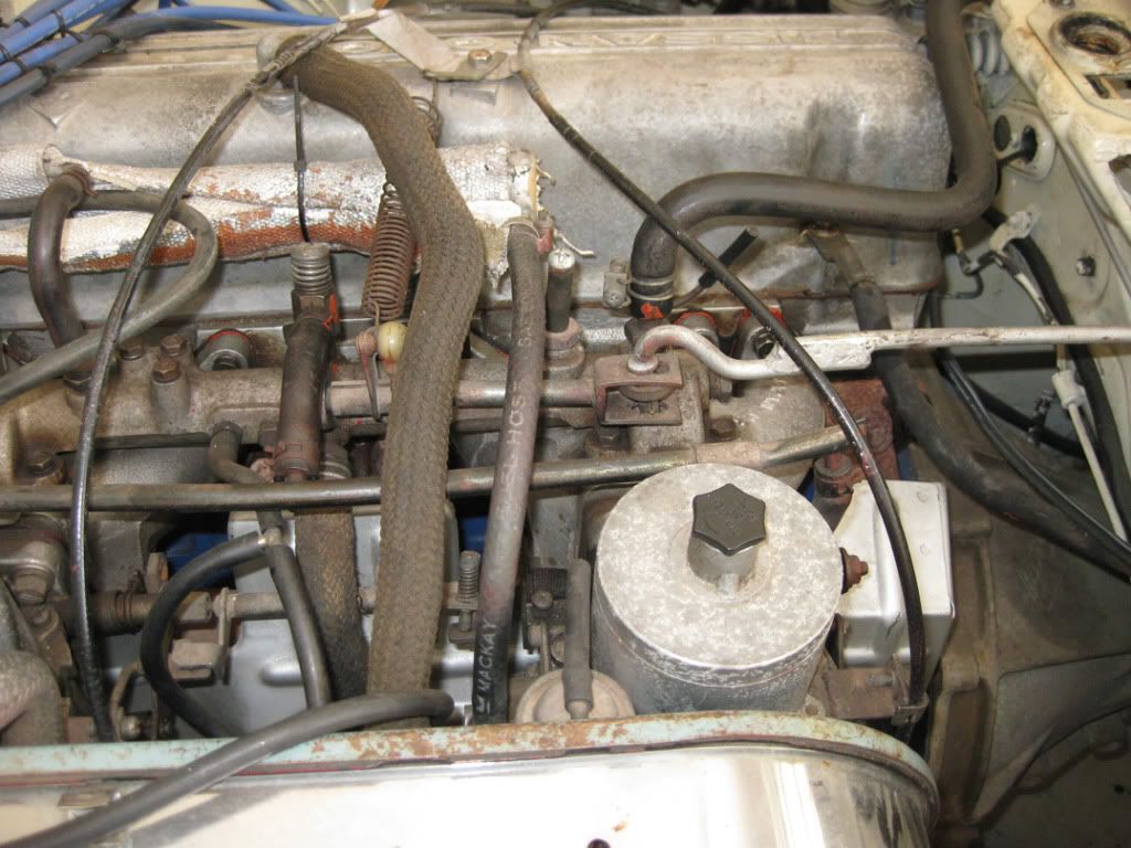

hmm, better remember how these lines go...
strip down completed ready to take the cam cover and head off
pretty shiny, just needs a clean
the strip down of the head didn't take that long at all, there was no seized bolts of nuts, which made me very surprised coz even those nuts on the exhaust manifold which always rust into place came undone with an effort of only 1 hand

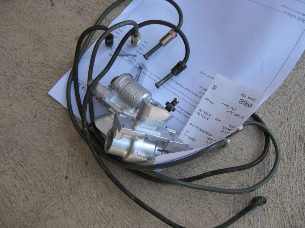

new rebuilt brake cylinders and new hardlines next to the old hardlines

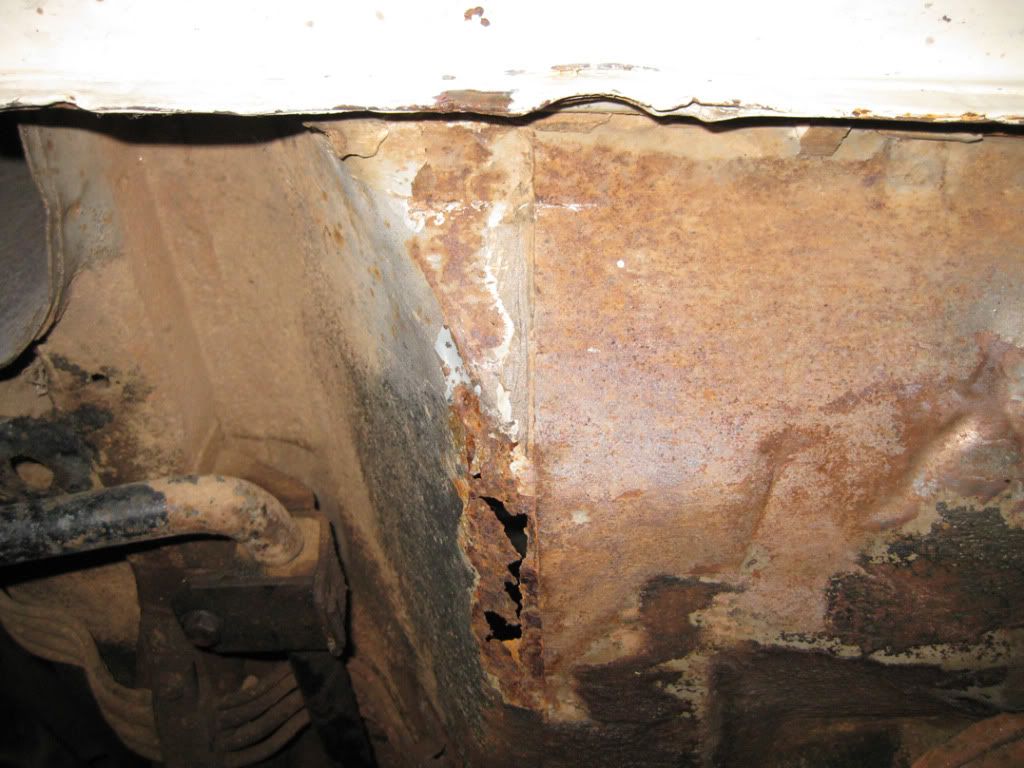

the rust hole in the rear floor that needs to be cut out and replaced with fresh metal

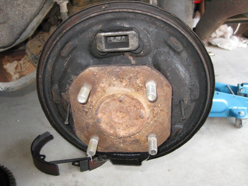

so i've been sick with the flu for a while, so there hasn't been much progress, but today i pulled apart the rear drums and took out the wheel cylinders for re-building
also getting new hardlines made up coz the flare nuts on the lines were fucked
while i was under the car i've also found a rust spot that needs attention ASAP, there is a rust hole in the rear floor along the seam, so i'll see if i can get a friend to patch it up for me.
