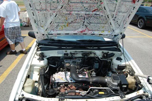

    The little B6.
    Not long after doing the bumpers one day my buddy and I were just BS'ing while working on his car, and we got on the subject of swapping my motor. I thought about doing the 1.8L BP swap at most, a really common swap in these cars. He asked me about the V6 that's in the Mx6. I was like "as far as I know it's never been done, and I don't plan to do it." I left it at that. lol boy was I wrong..

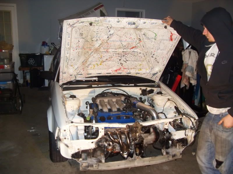

    Of course we had to do a test fit of the KL since it hadn't been done to my knowledge at the time. We had bets going whether it would fit or not. lol
    It's in! sorta. lol

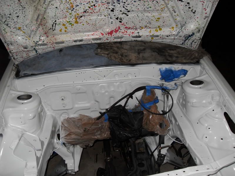

    Started cleaning the bay..

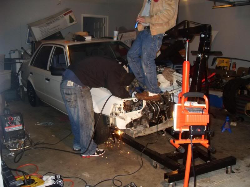

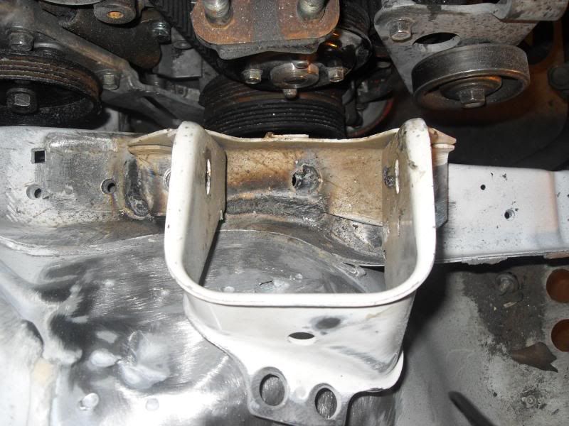

    And then the horrible task of making mounts begun. Luckily my friend is a welder so I had tremendous help from him.
    Stock rear mount worked on the KL trans, thank god for Mazda being lazy. lol
    Mocked up the passenger side and front mount, not yet bolted in or welded.

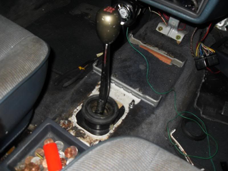

    I was doing shift linkage at the same time, turned out it was an inch and a half too long. So it had to be shortened and rewelded together. The only reason I knew MX3 was close to what I needed was because its what people use in the newer gen Protege/323.

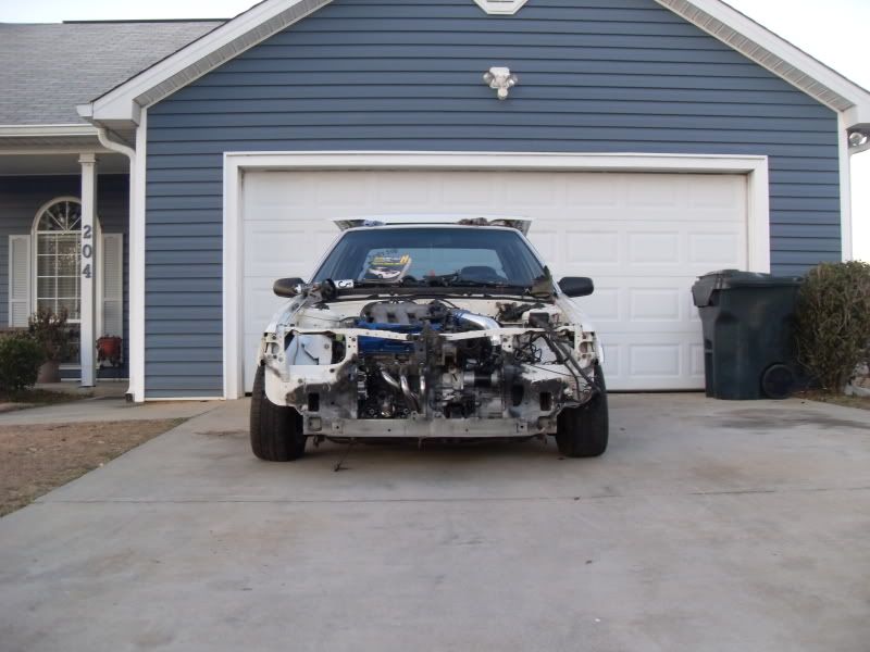

    And here she was, in and sitting on her own.

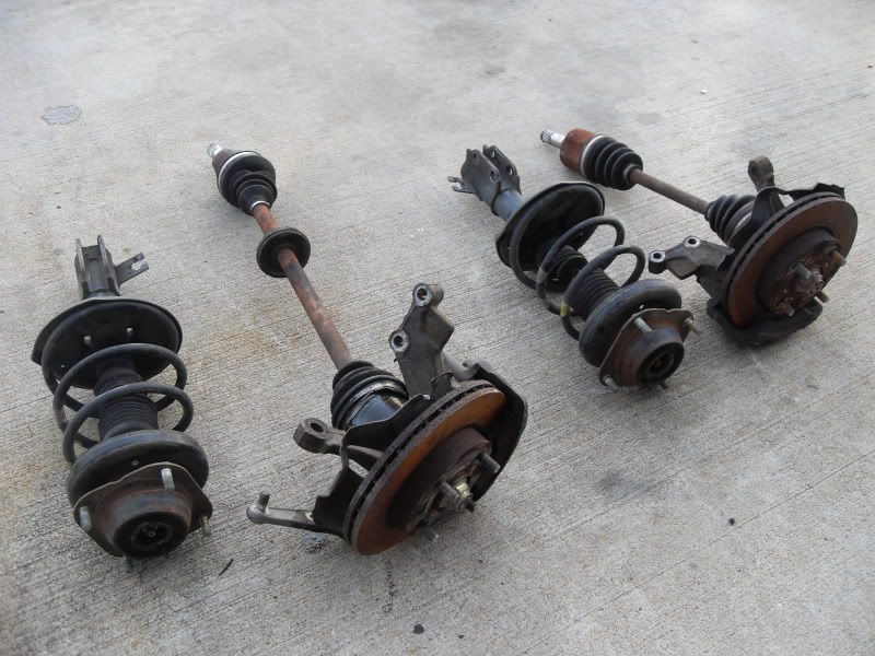

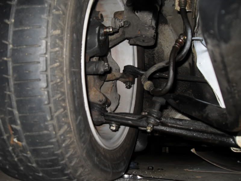

    Then came the next issue, axles. The stock 88 hubs were way too small to accept the V6 axles, and had a different spline count. So I did some research and found out that the 90-94 protege LX used the same spline count as the KL cars do, and it's the closest to my BF (86-89) 323.
    So I bought a whole front setup out of the junkyard.

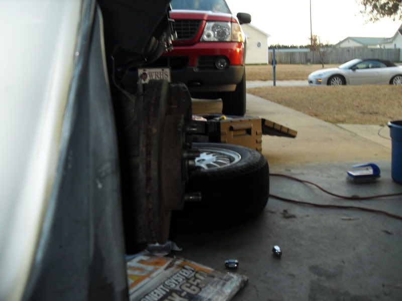

    Had to drill out the lower control arms to accept the BG (90-94 protege) hubs.

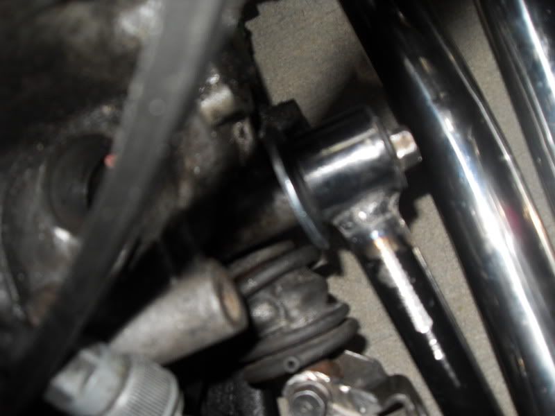

    Installed. However ran into a problem with the BF tie rods being too short. So I had some nasty toe and camber. Headache after headache I swear.. lol
    Ended up finding out that BG tie rod ends will work on a BF tie rod, and are longer. So solved that problem.

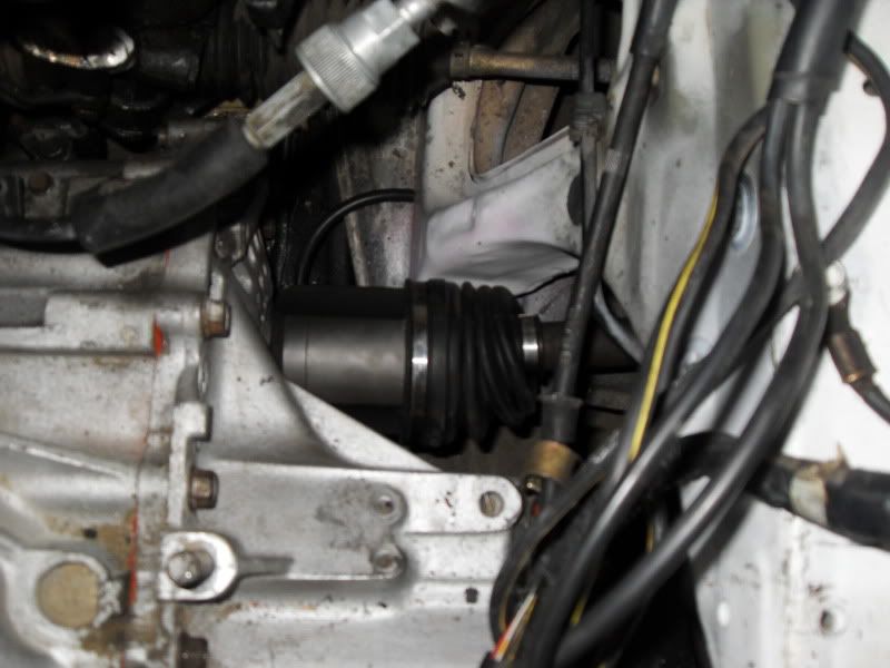

    Driver side axle at first was a MX3 1.8L V6 axle. Too long at the time but I didn't know..
    Passenger side was a whole problem in itself. A passenger side MX3 axle was almost 2 inches too long. The hub stuck out way too far and the strut wouldn't even bolt up.
    So I got a guy who claimed he could make me a custom shaft. Yeah I got played. lol

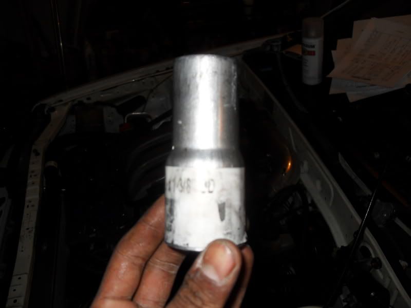

    My custom $27 hose. My buddy let me go through all the hose at Autozone to find two that would work. Used an exhaust reducer to bring them together. They were different diameters at both ends..

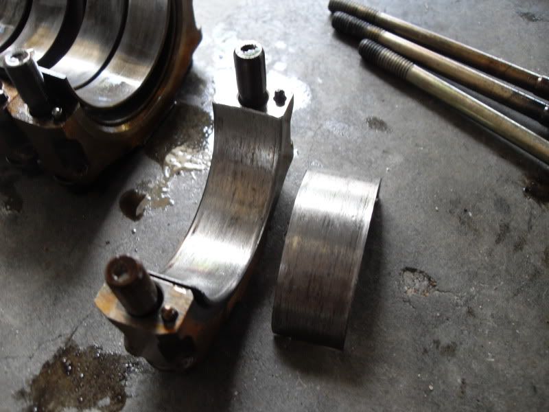

    3 weeks later after all the work, spun bearing number 6. I was so through with this build by then. lol

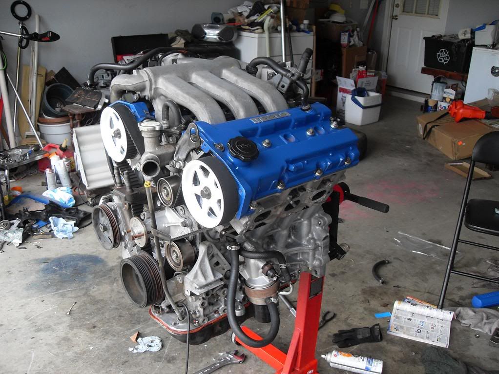

    I decided not to give up though, and saw it as chance to upgrade from the KLDE. So I painted the bay and got it ready for yet another new heart.

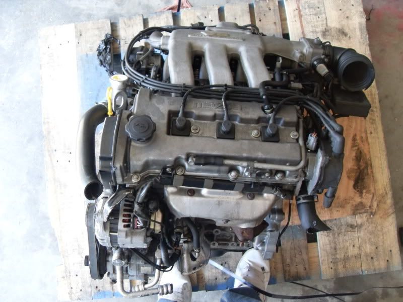

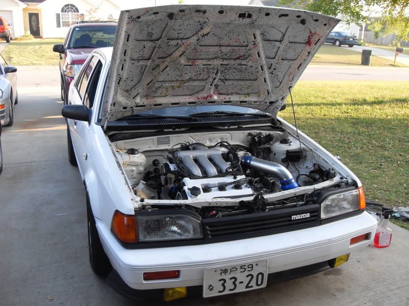

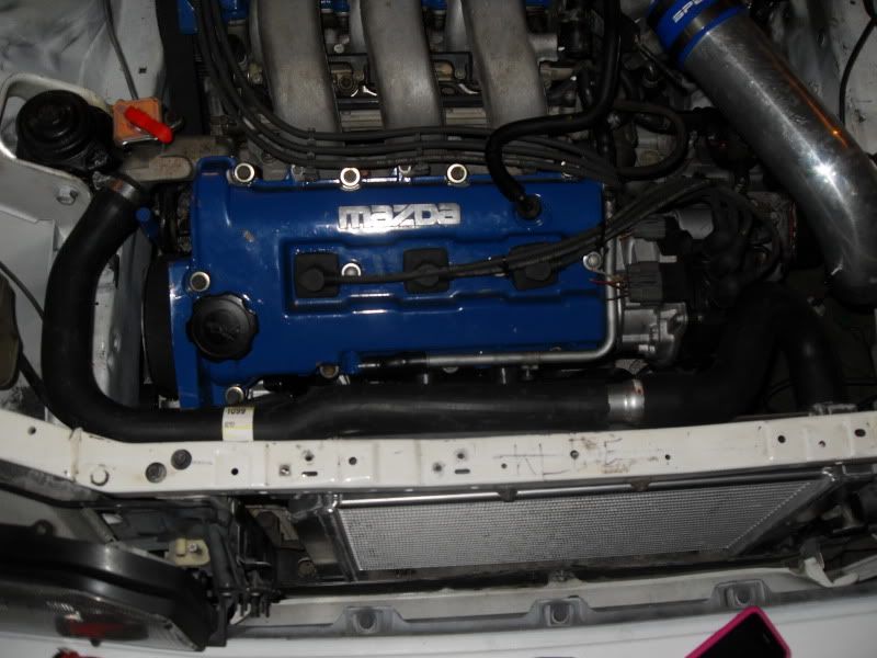

    JDM KLZE
    Swap was much easier the second time, just had to drop in the ZE since they are identical on the outside.
    Picked up the Isuzu I-Mark bumper right after dropping in the ZE. So I had a new front and a new motor. Life is good! lol

    Finally got around to replacing that shit axle with a custom made piece from DriveShaftShop. The driver side MX3 axle was replaced with a Kia Sephia 1.8L BP axle. Yet more sleepless nights of research help me find out that it would work. lol

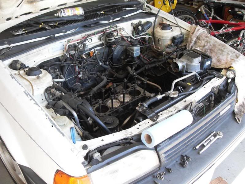

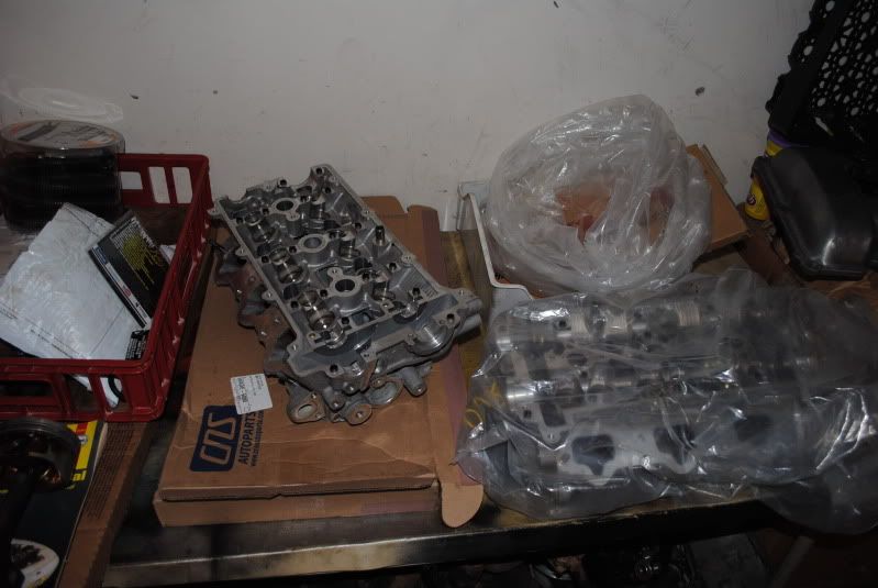

    Everythiing was good for some time.. until I decided to try to fix what wasn't broken. Wanted to swap out the injectors off the old manifold I had. Little did I know these injectors were bad. I had taken them off the ZE because a straight neck ZE manifold won't fit in my car. Either way I went to put them in my curve neck manifold and fired it up. 5 minutes later I had a hydrolocked motor full of gas.
    So I got it up on stands and dropped the pan, and pulled off the head. First piston I pulled, number 5..
    needless to say I was terrified to see what the rest looked like, but I got lucky and only bent one more.

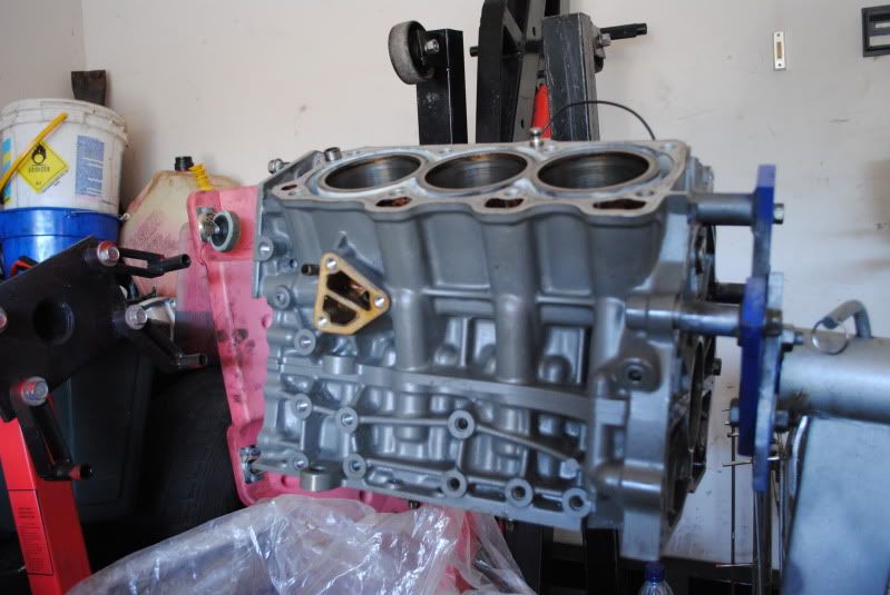

    So down to bare block it went so I could attempt my first motor build..
    Mmm shaved heads! Cheater compression gain. lol
    Started right up. I'm pretty proud that my first build was a success.

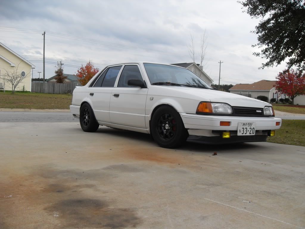

    That's how she has been since then with the exception of my XXRs that I finally got in after 2 months of waiting..
    And here she is today!
