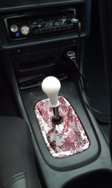

    looks awesome dude, what sort of material/fabric do you use for the shift boots/headliner/door trims?
    i wouldnt mind doing some of my stuff soon, and getting a shift boot made up

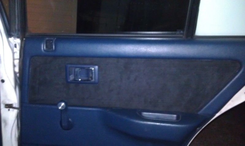

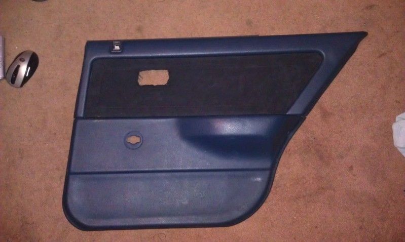

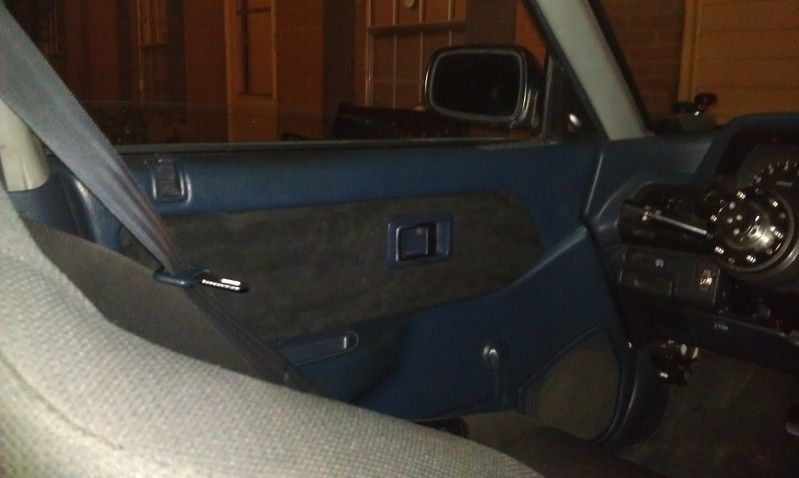

    did a little this and that...
    got this shift knob....... Not sure how I feel about it though... so small...
    Wrapped my arm rest and my door panels with black suede.(sorry for trhe shitty pics... cell phone)

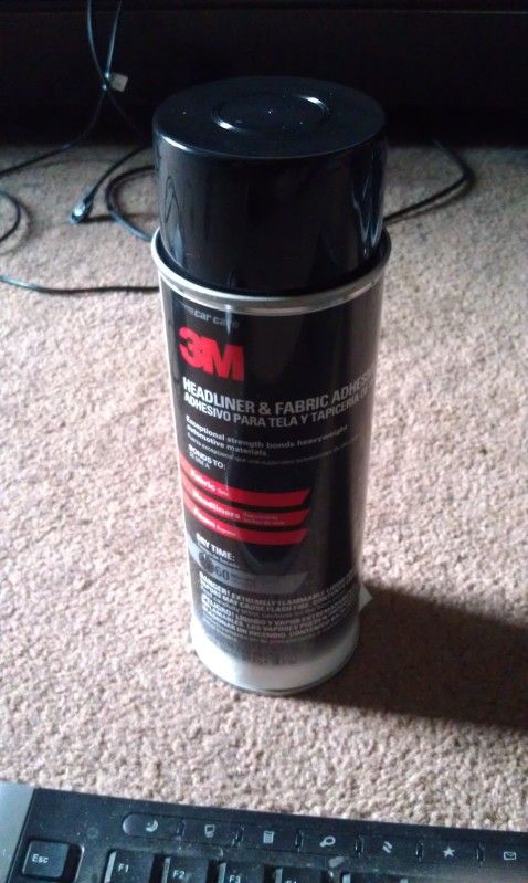

    Yeah.. I think I need to get some 3m, because he crap I gage is CRAP! Thanx for the advice

    They have the 3M stuff and then there's a cheaper brand you can get... I knew the 3M was good stuff so I spent $15 on it so I knew I was getting good stuff over the $6 can of some stuff that might not be as good.
    Mine holds up in the heat. I check it everyday when I leave work.
    It says spray it 2 layers on it in 1 direction.. and then for the 3rd layer spray it in the opposite direction.
    Obviously after you have shaken the can up properly.
    But in those certain areas where there is a bend or "shape" like spot where it needs to shape to it.. I sprayed just a tad more to ensure it had glue that will hold. No problems so far. I recommend the 3M stuff.

    for brick(YOU CAN GET THIS AT AUTOZONE)
    Reason y i asked. Because the adhesive i got from advance auto lost its stickiness once my car got really hot. On sunny days the adhesive liquefies and the material falls off. How much did you use? maybe in doing something wrong. I'll redo it then see how it comes out
