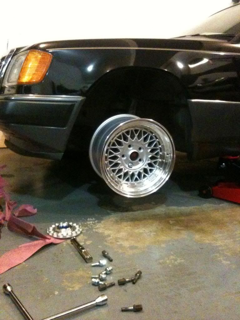

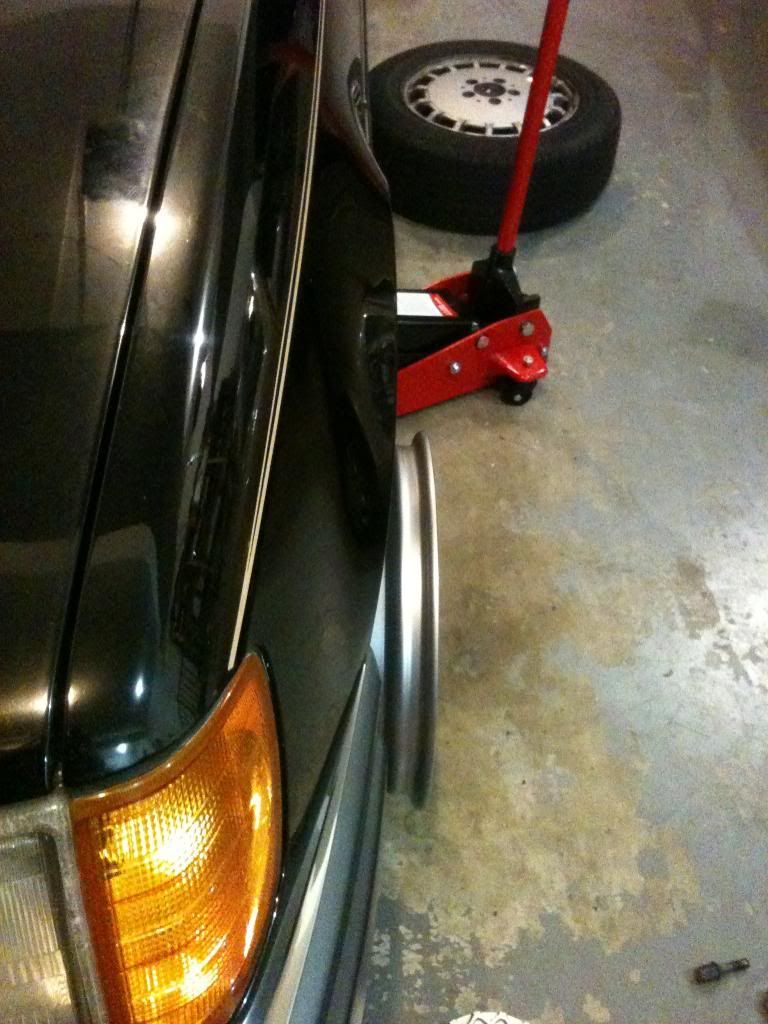

Did a test fit... Needs a washer or 3mm up front but the fitment should be good, been wanting to try 16's out forever.

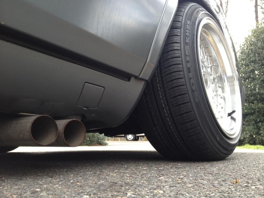

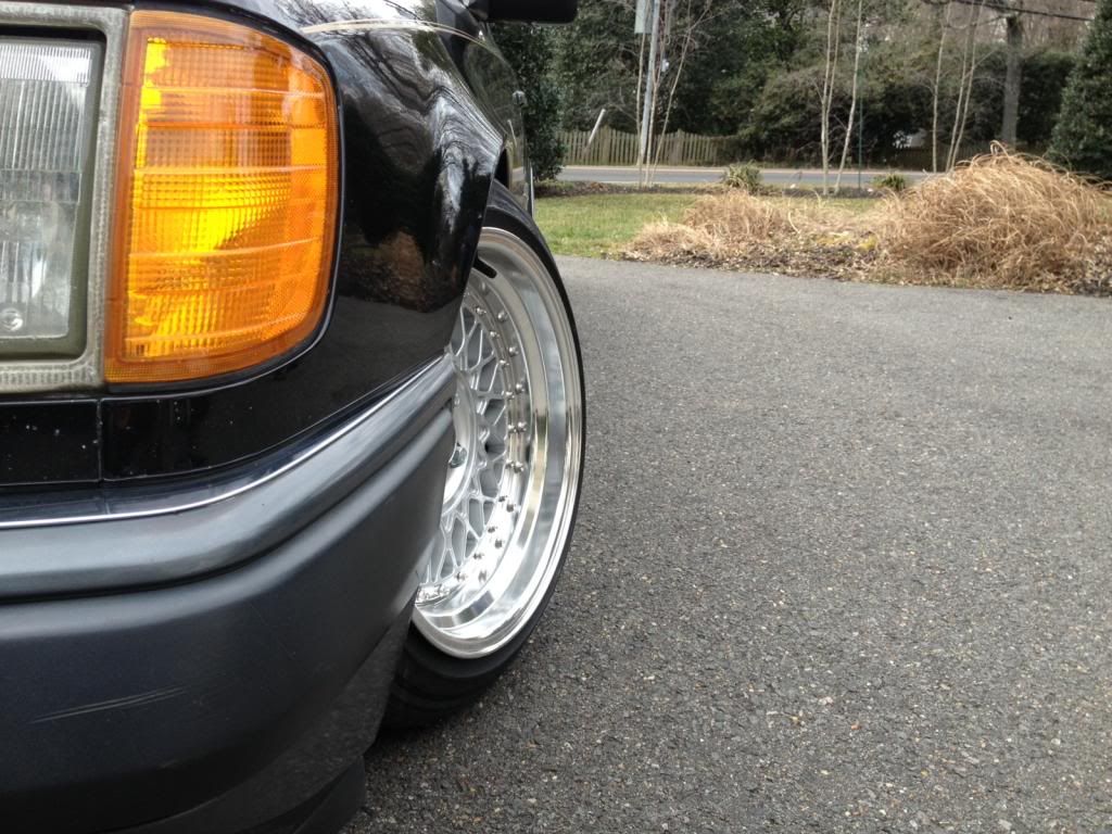

So finally got the wheels and tires on. My boy Arty (turbo turkey on here) played with a cheetah and got the 195/50/16s on the 16x9 to my surprise the kuhmos stretched super well I highly recommend them.
Ran into a front clearence issue with the brake caliper and the wheel up front so threw on a 3mm so final offset up front is 16x9 et17 and then had the typical w124 issue of the wobble bolts being too long and the rears looking sunk compared to the fronts so threw on a 10mm out back for a final offset of 16x9 et10. Fitment is on point now!

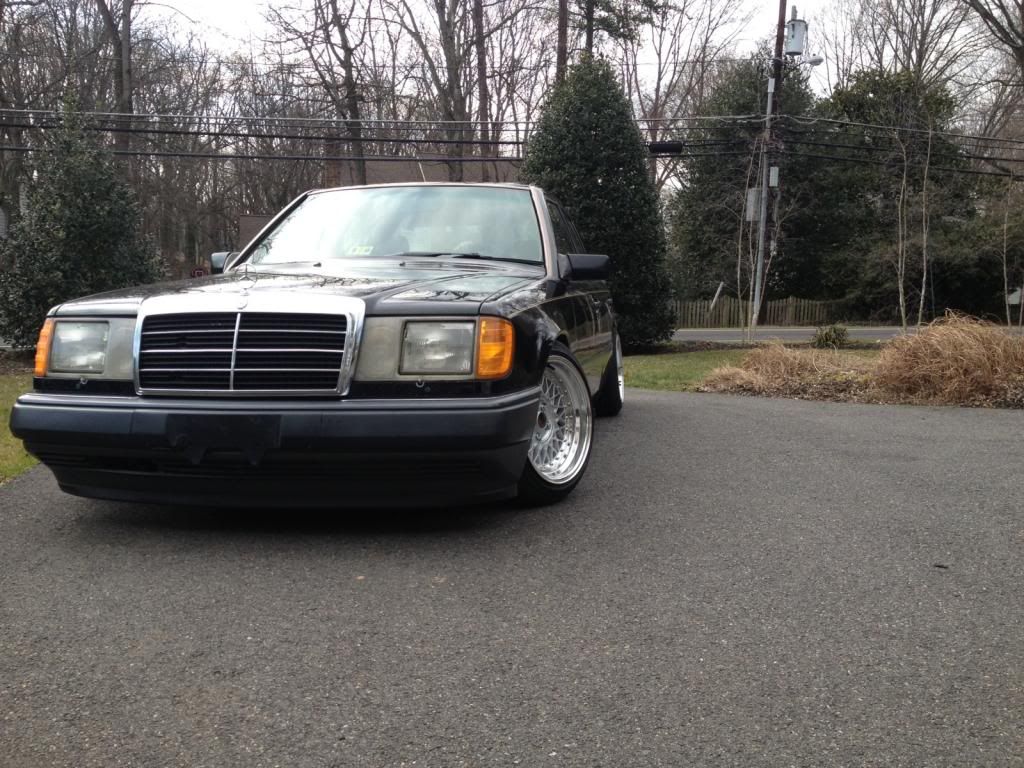

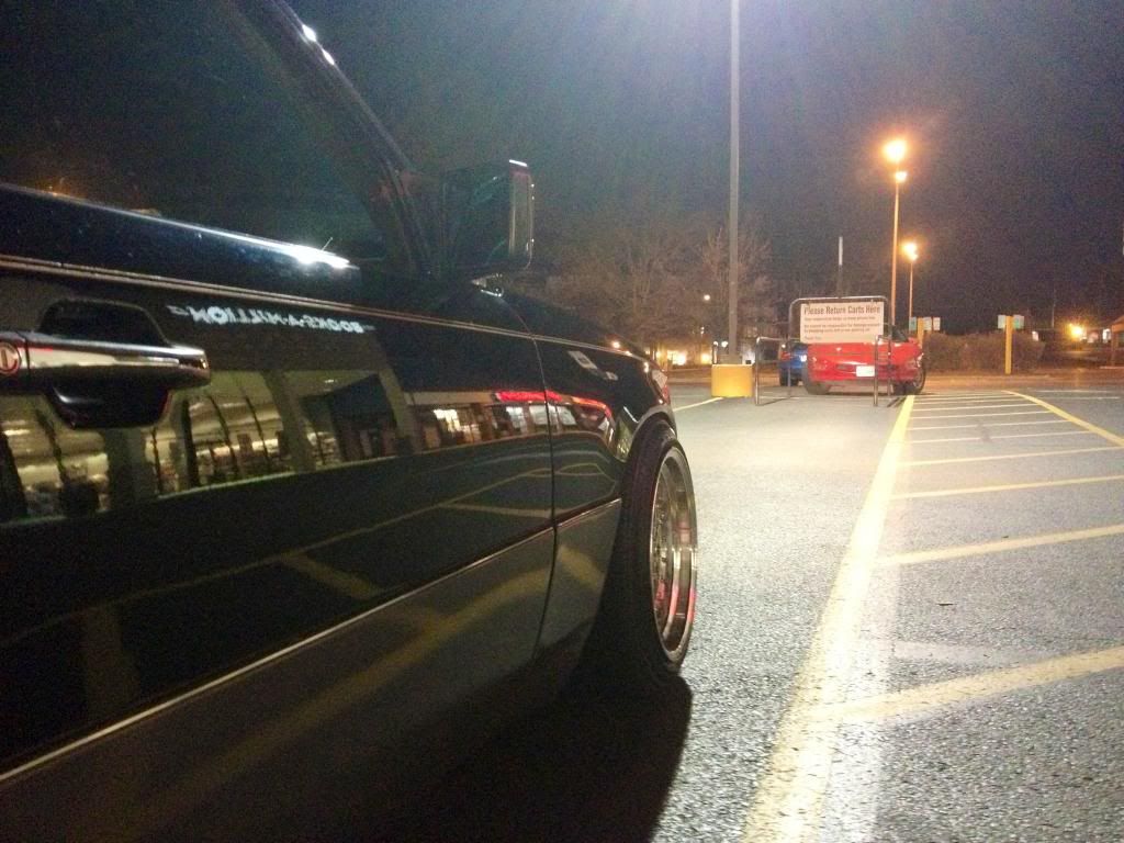

On to the pics... Sorry shitty IPhone shots for now...
Will get a vid of the exhaust and some better shots once this snow storm blows outta here.
