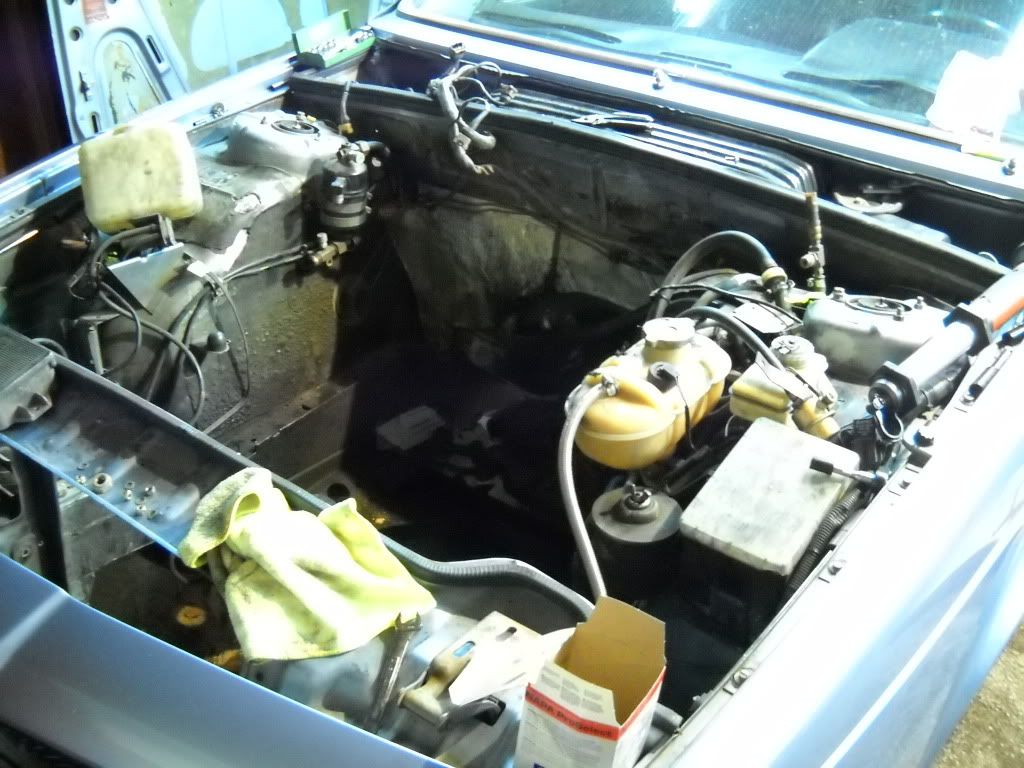

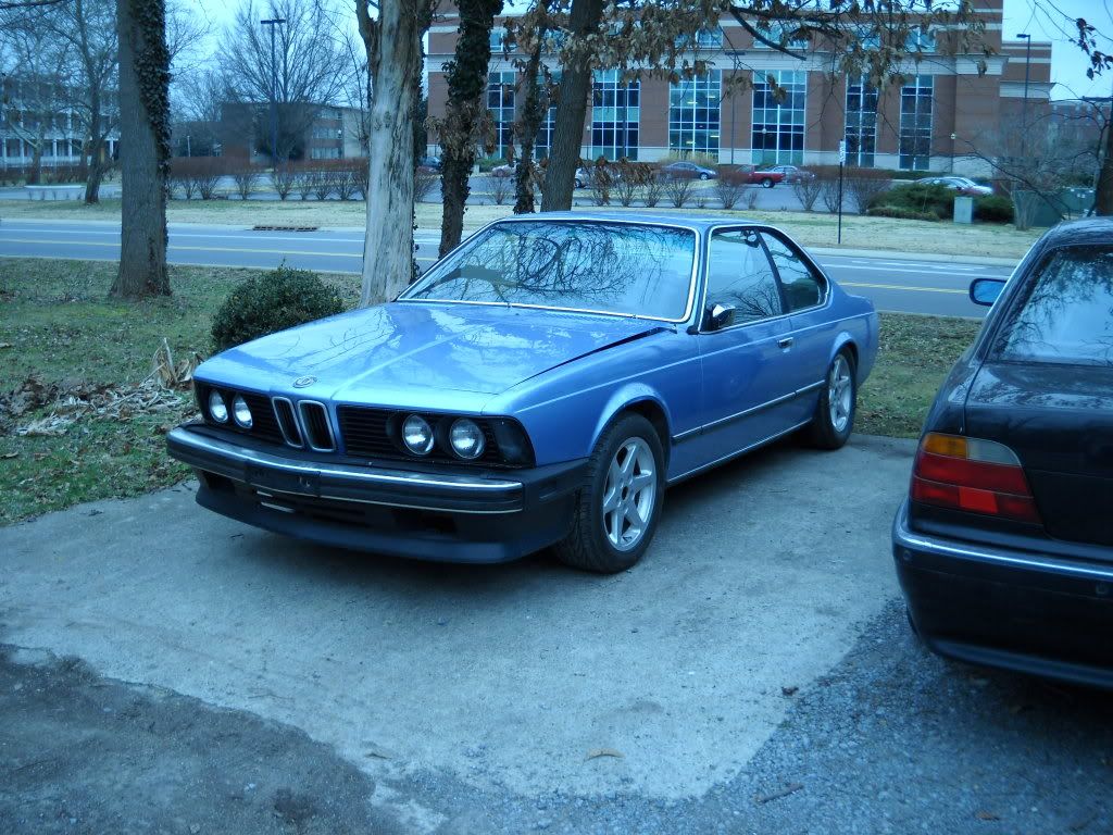

                            Ok so I said eff the lt1 (too heavy) then went with an ls2 ida but realized id have to sell my soul to buy one so I decided on a different swap, that will be concluded soon. Till then some progress pics?
                            I took the spoiler and rear bumper off but of course you cant see it well in these pics...
