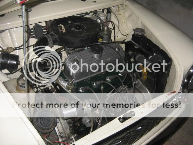

    Regards from Croatia, this is project of my car..... Thanks to all people which helped me in any way with my car. We worked on them about three years.
    Body: New front wings, front panel, floor panels, A panels, sill panels, rear bootlid, rear lower panel, doorskins, and lot of work on body.
      Front subframe: 7.5" discs and calipers from cooper s, braided goodridge brake hoses, HI-lo (height regulation system) , repaired arms, all new bushes, GAZ shocks for lowered cars, upper brackets upgraded, new cones, knuckle joints, etc....
      Rear: New cones, repaired arms, hi-lo, GAZ shocks, rebuilded brakes....
        Body is painted in Old English White with black roof, so we started with work....
        Rebuilded engine and gearbox from Austin 1300 with 2.9 diff and flat pistons....

                            Some new details...
                            new hif44 carb mounted...
