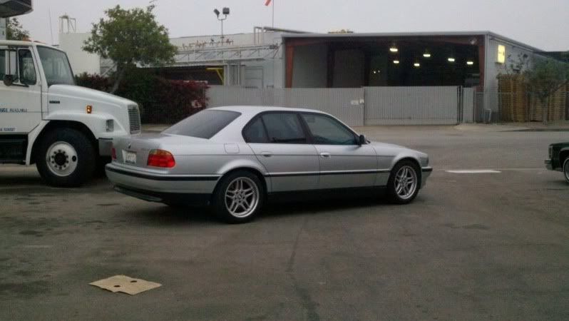

    Well I've never posted here but been lurking for a while now. Figured id share in case it helps some people out. Car is a 99 740i sport in titanium silver with black interior. Planned on leaving it stock for a daily but that idea never lasts long with me.
    Here's a couple of pictures of it pretty much stock. Car had front end damage when I got it. The paint didn't match up well so a complete repaint is in the near future.
    After coilovers.
    last two pics are with fronts adjusted all the way down. All adjusted nuts stacked up on the lower spindle mounting bracket.
