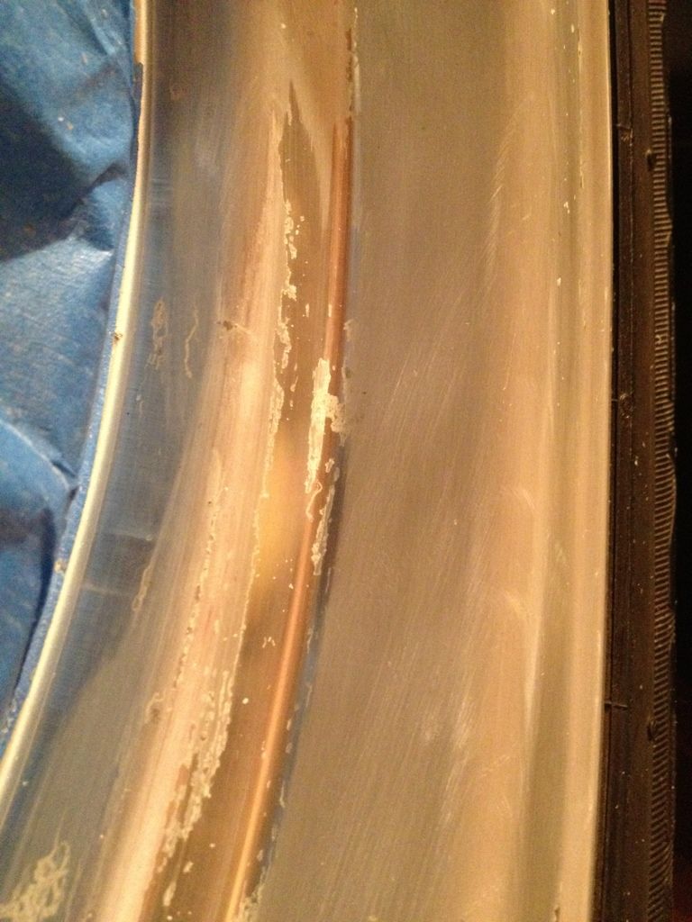

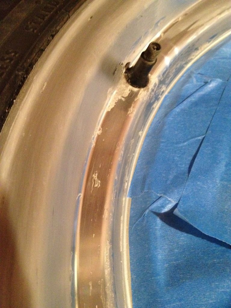

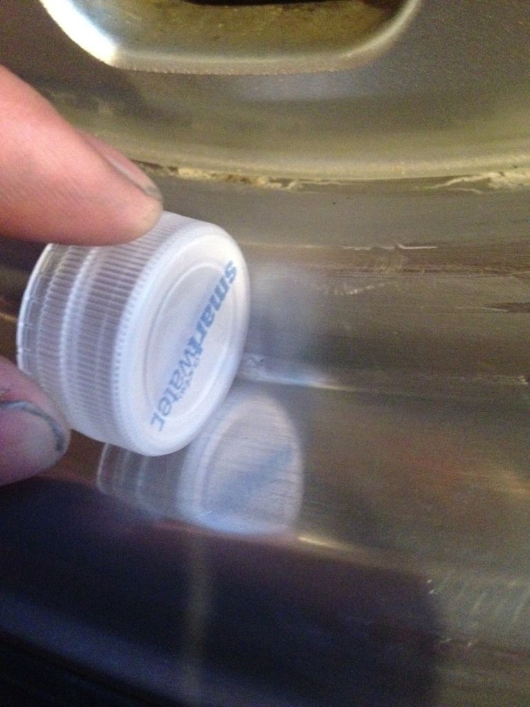

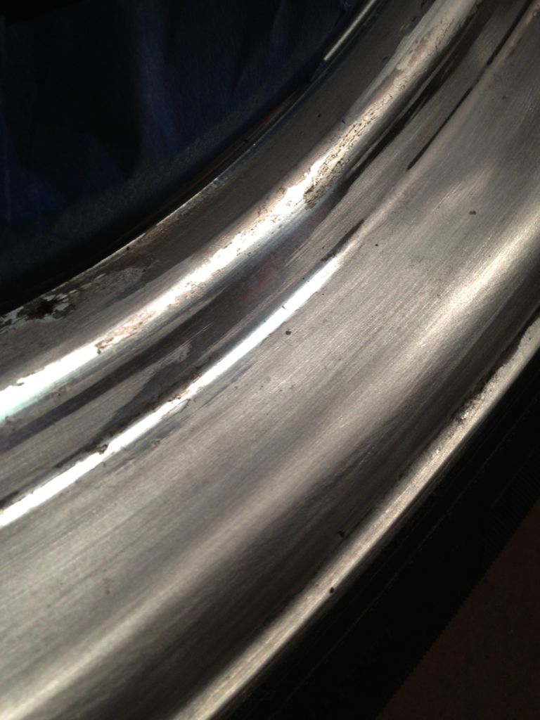

Probably shouldn't have wasted time sanding... After sanding at 400 and then a quick bit of 1000 I was able to get this...
I was told to try paint stripper. My initial worry was getting it on the faces by accident and then having to have the faces repainted. I taped off the center and slapped some paint stripper on for 15 minutes and the areas that I hadn't sanded all of the clear off came out like this.
Definitely going to start with paint stripper first on the next 3 wheels... Save myself a lot of time.

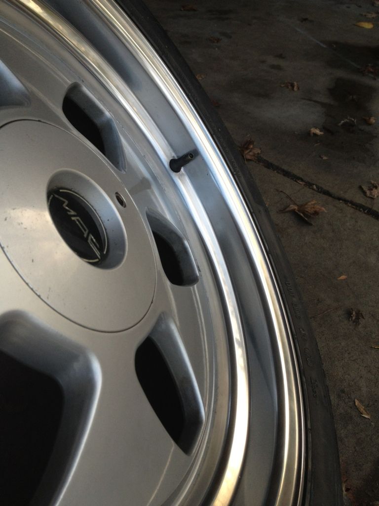

Since no one looks here anyways... I might as well just post what I'm working on...
looked like
Anyone know where I can get a centercap removal tool for these wheels? I've called countless places and no one has a fucking clue...
