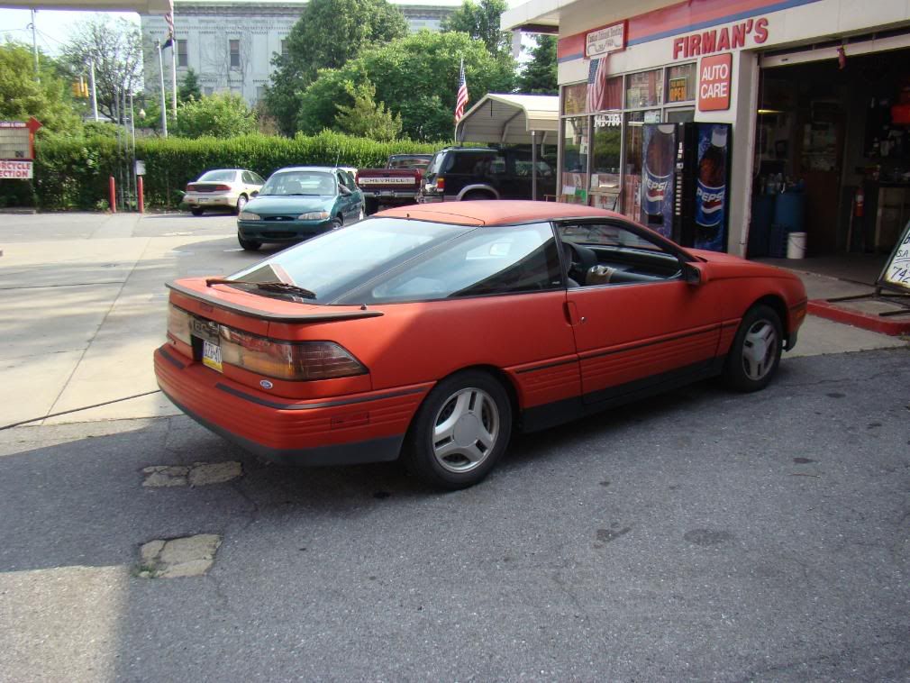

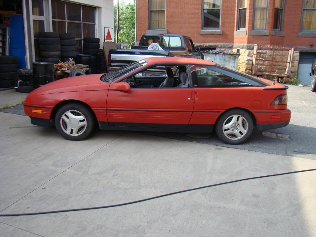

When I first Bought her Home. Picked her up for 300 Cash! Had 150XXX mile on her.

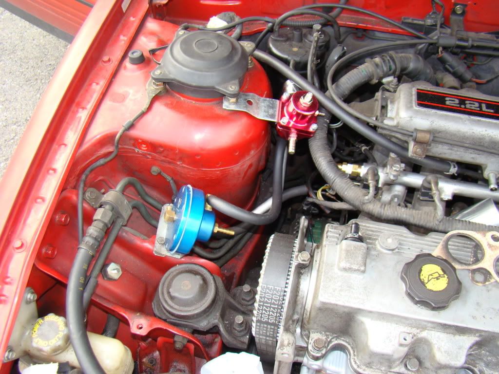

Mods since then:

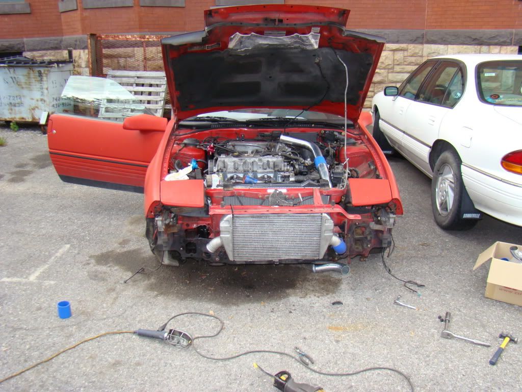

Chipped ECU
2.5 custom Exhaust

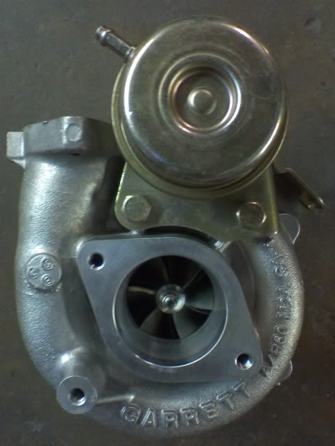

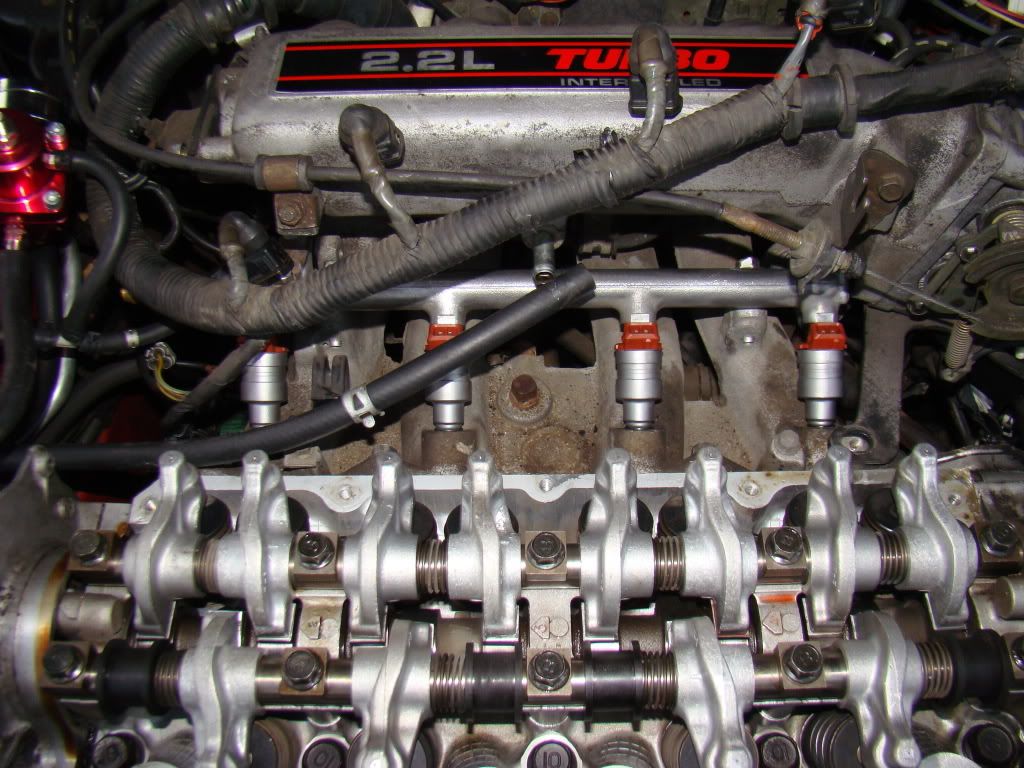

Upgraded the Turbo (YES TURBO!!)
Put a gt28r on

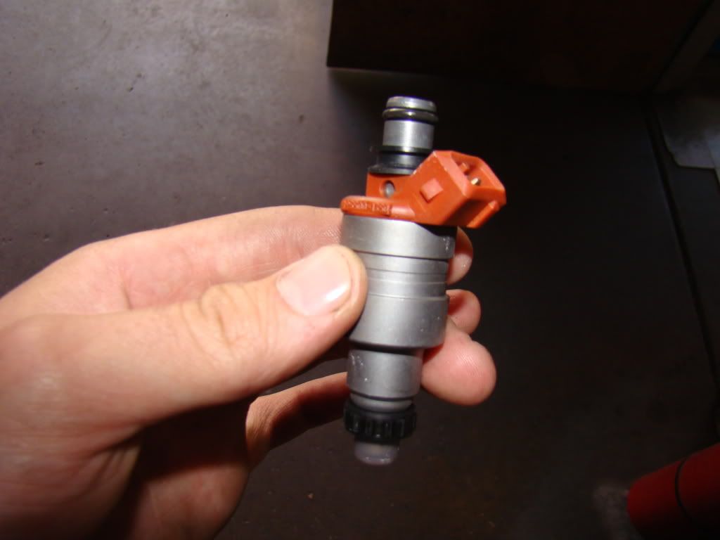

FMU Management for Fuel
rx7 460's Injectors drop right in

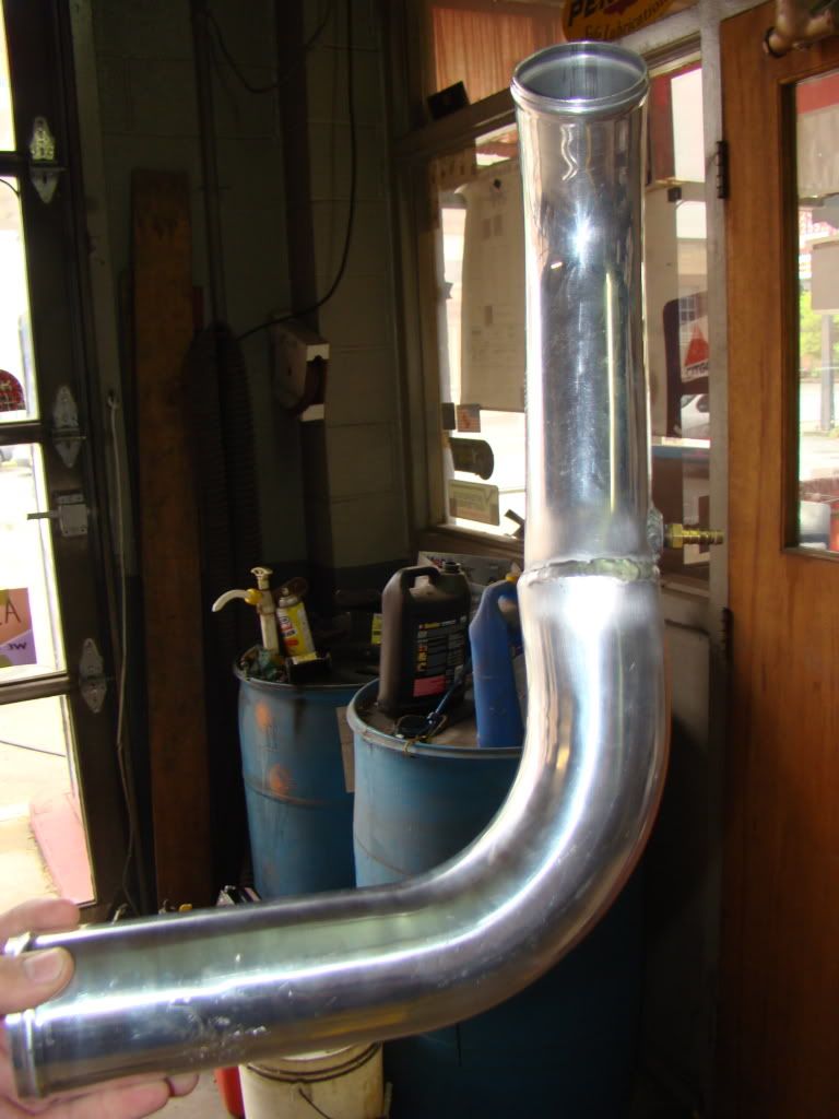

Custom 2.5inch IC piping

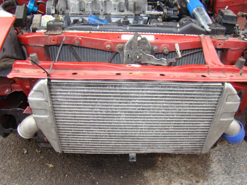

Evo 8 IC Looks like it went through a stone storm.

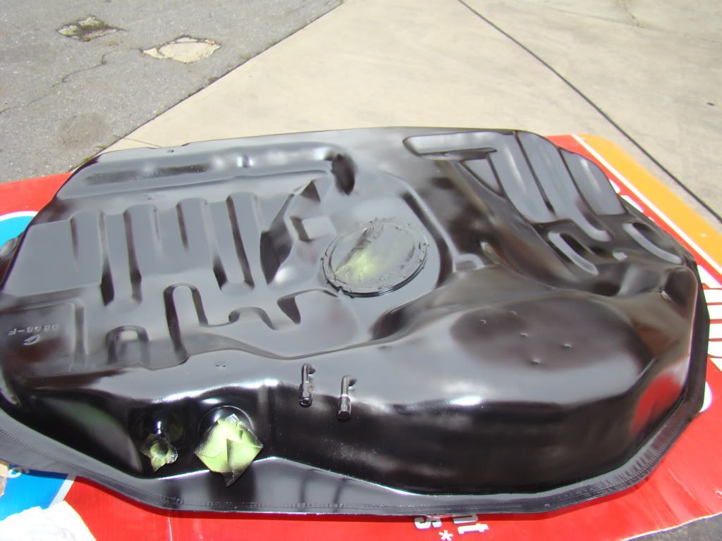

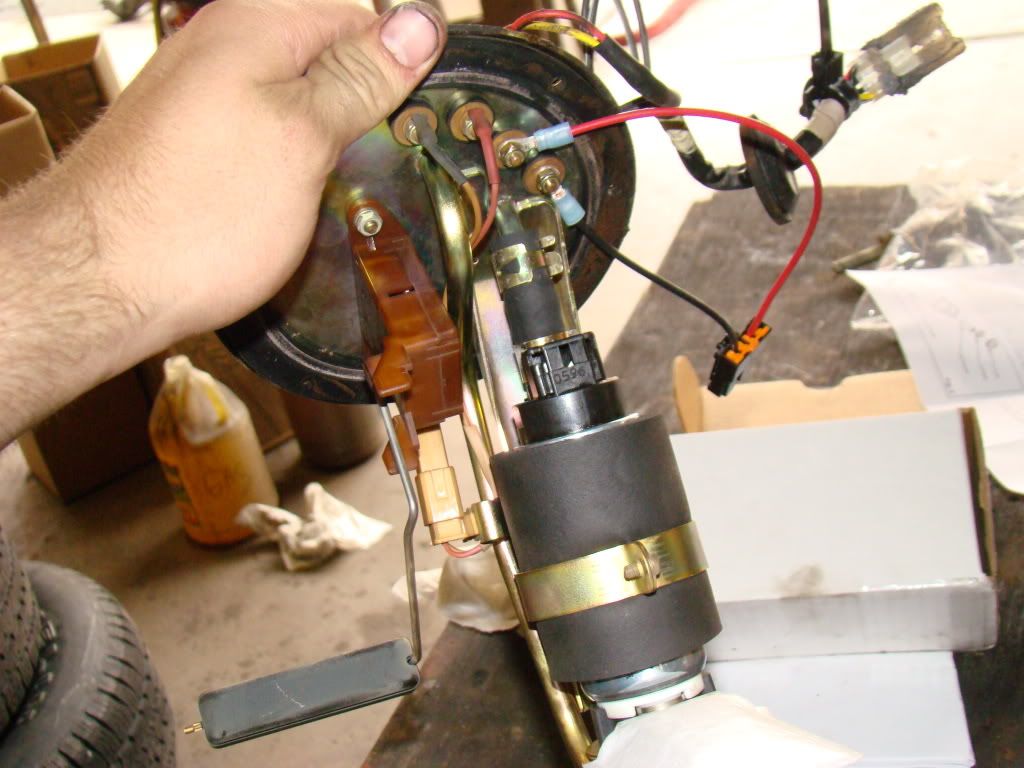

New Gas tank. old one leaked
Fitted with a wally 255

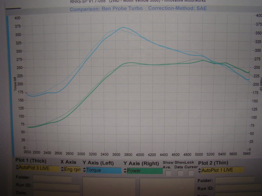

All those goodies made some good numbers. 272hp and 363tq

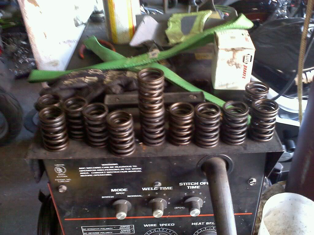

After that I put in Mazda b2200 Dual Valve springs
And full 3inch exhaust
Hopefully I am at 300hp! I should be close if not right on.

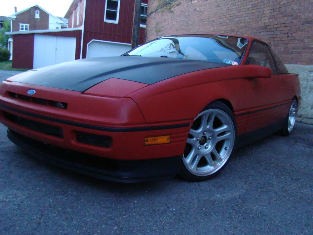

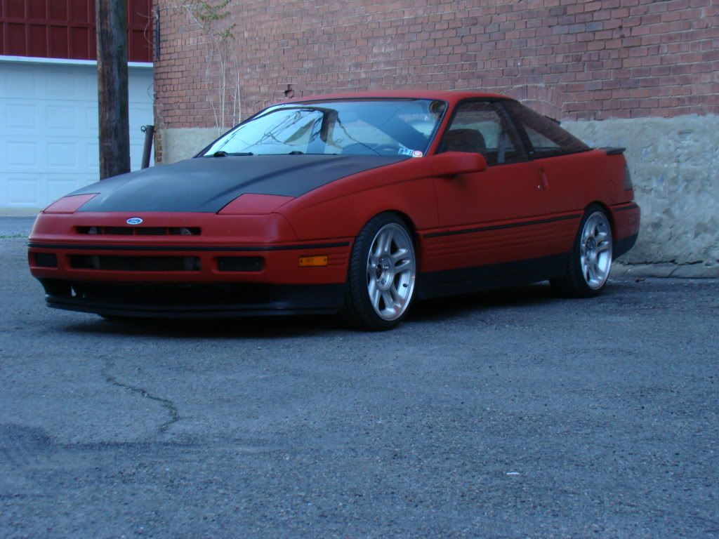

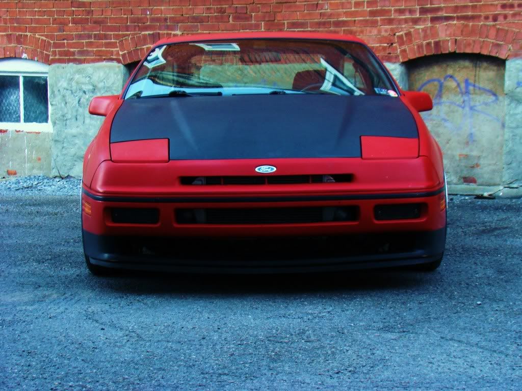

Now the STANCE!!!

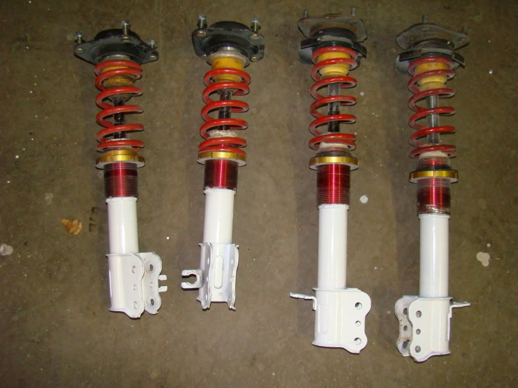

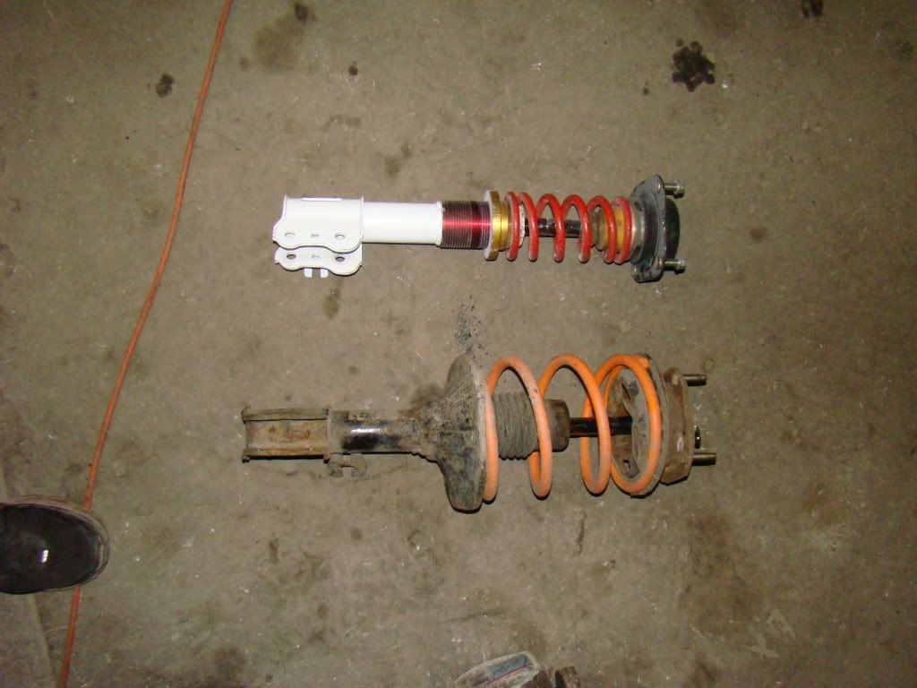

Tokico Illumina with GC Sleeves

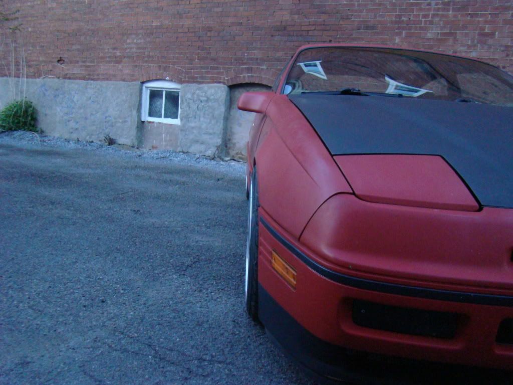

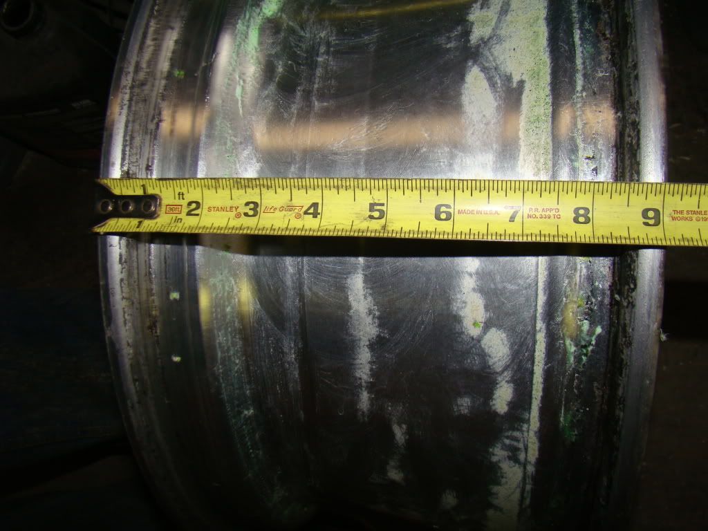

97 Mustang GT wheels 8 wide
POKE
I put yoko sdrives on them. I wanted more of a stretch but i wanted the sticky of the sdrives but I am more then happy with it so far.

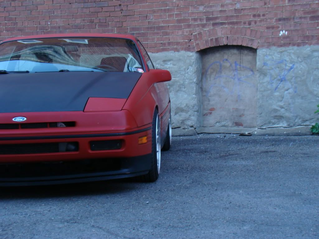

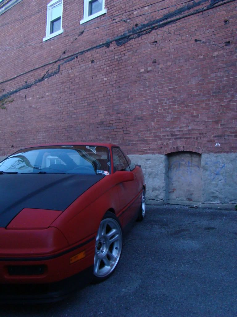

This is mt fav veiw of my car. With the rims just poking out the sides.
Before Anyone says it
1. Im getting a spacer for the back wheels.
2. Its goin another inch lower on all corners, I need to get RX7 camber plates for the front then turn the backs down.
3. roll the fenders maybe pull the backs a tad.
I am pretty sure you are witnessing the first stanced OG Probe!
Put a gt28r on

Now the STANCE!!!
POKE
