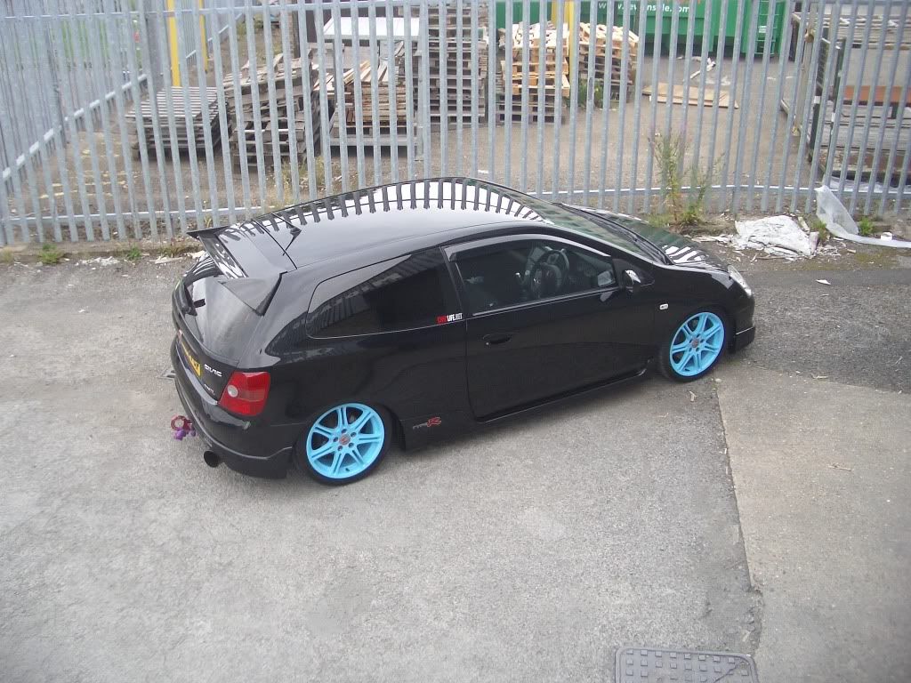

hi iam buzzer from nottingham, on my 3rd honda now after 2 ep3s ,
heres my last one

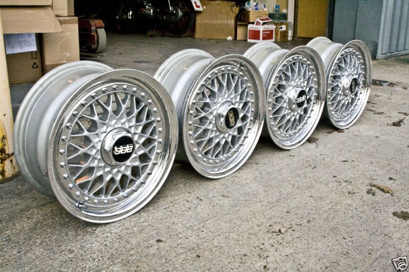

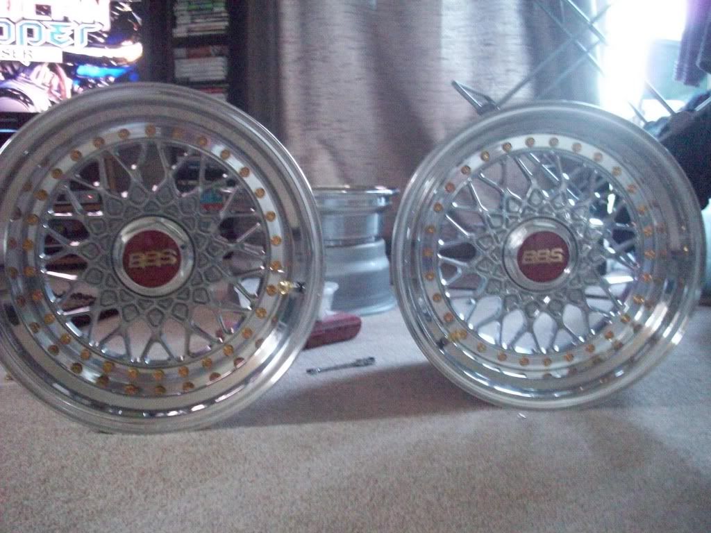

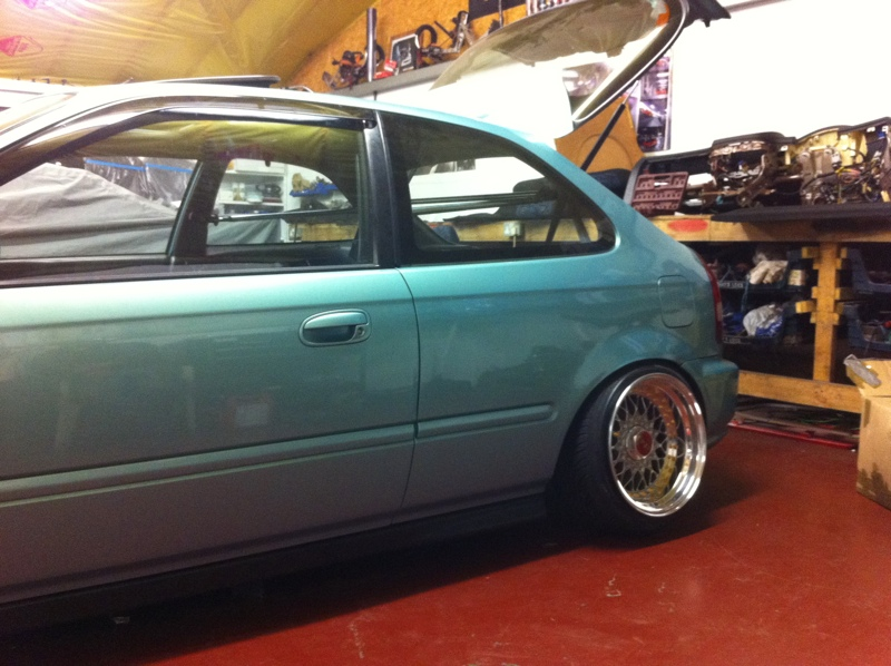

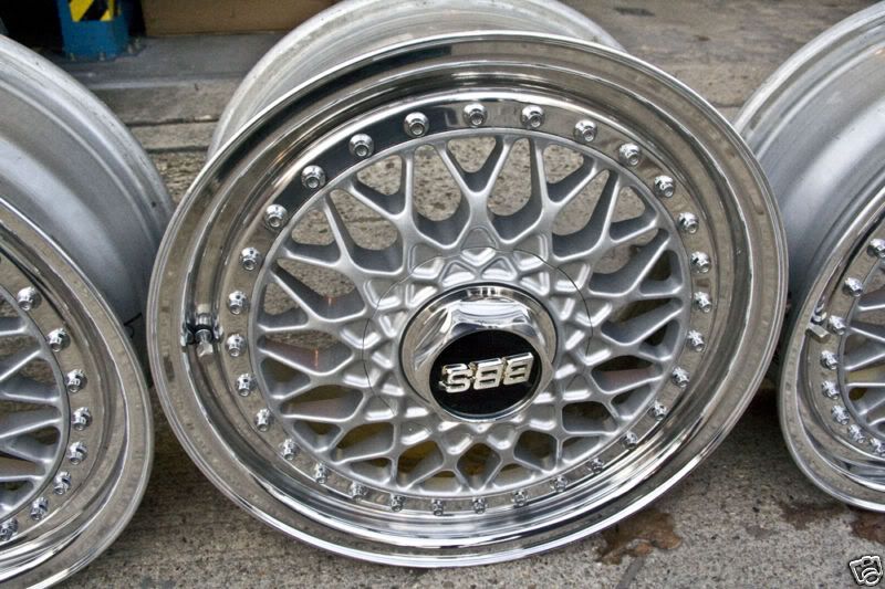

first off i bought the 15" bbs rs wheels from a lad down london. 6.5 j all round

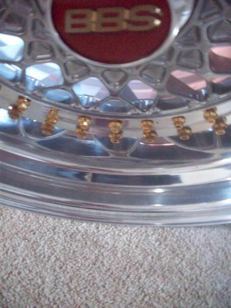

havent got any pics of the strip down but its prity simple, i then sent the centers off to mike the polisher in scottland along with 120 bbs studs to be 18 carrott gold plated, took about 2 weeks whitch gave me chance to find bigger lips n some tyres

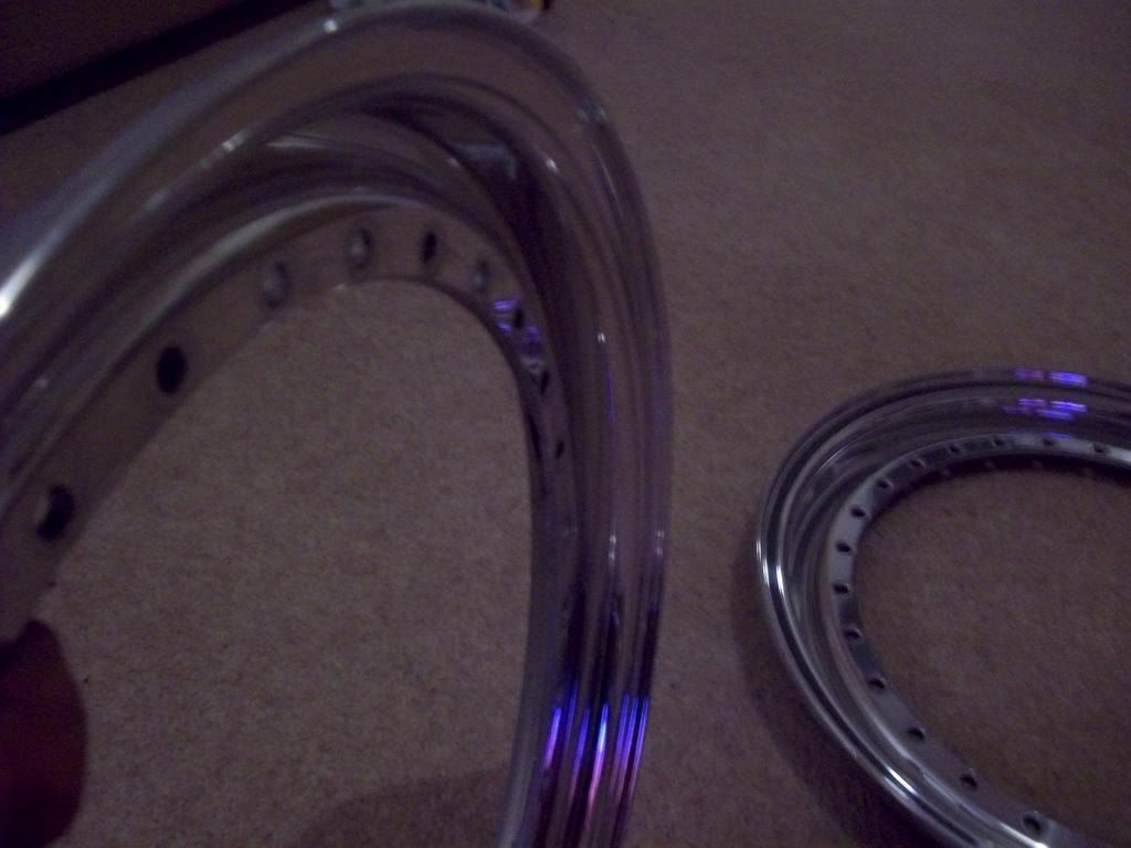

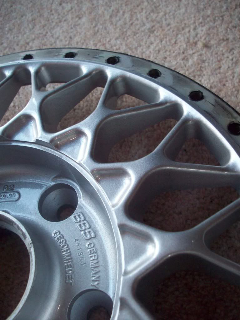

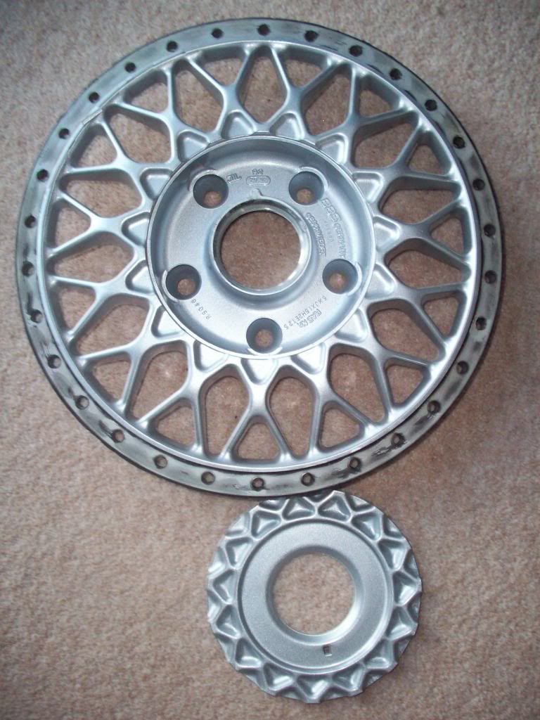

heres the standerd the half inch lips
then i sourced 2x 3.0" inch lips for the front witch made it 9j
2x 3.5" inch lips for the rear witch make it 9.5j
that excited i dry built them in my living room lol.

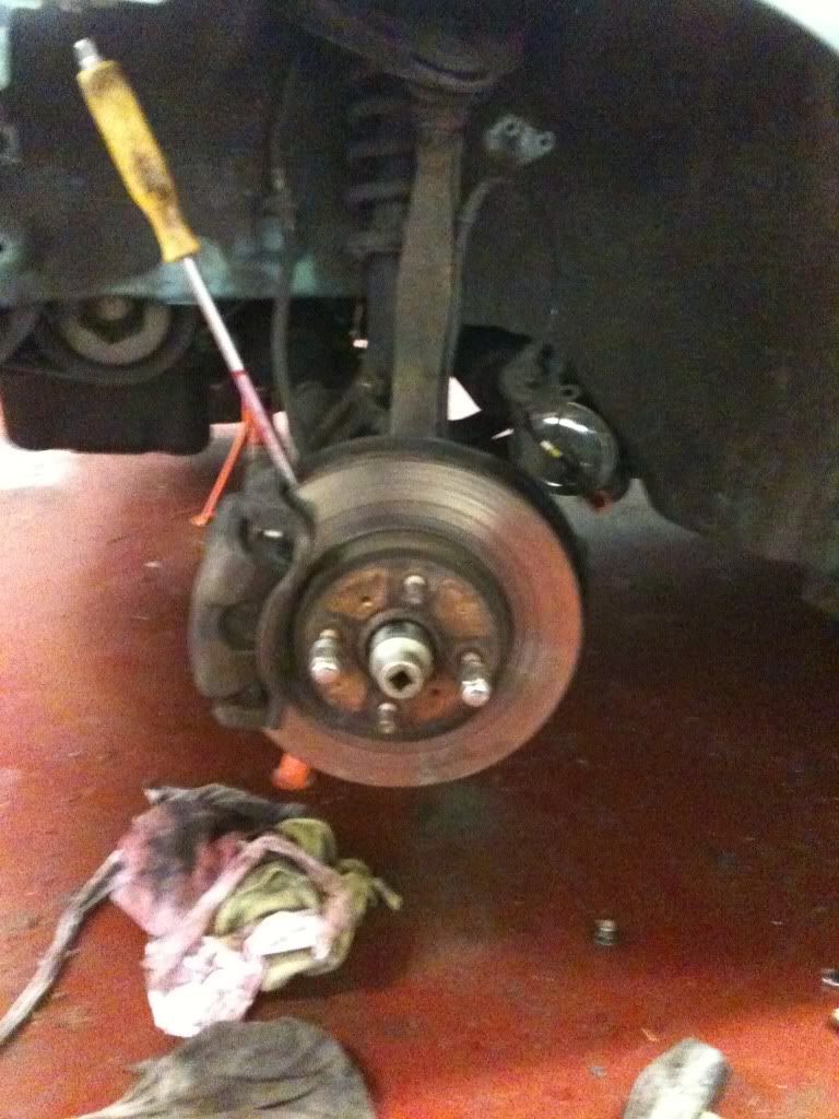

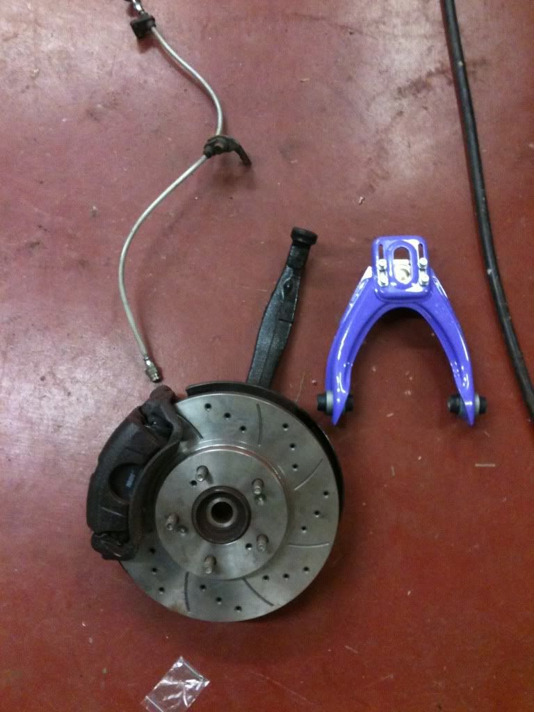

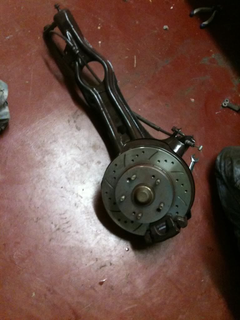

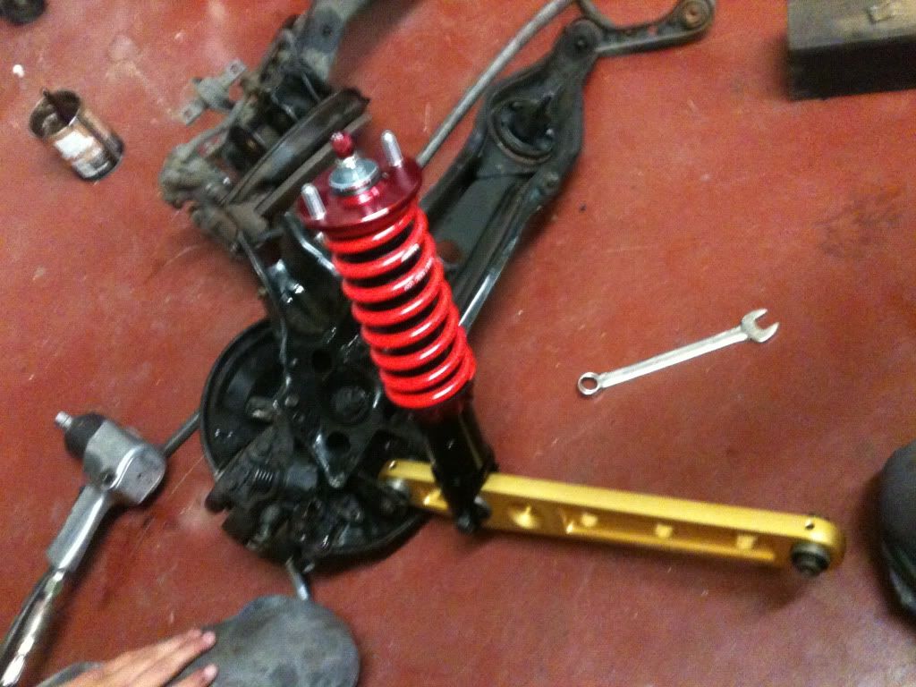

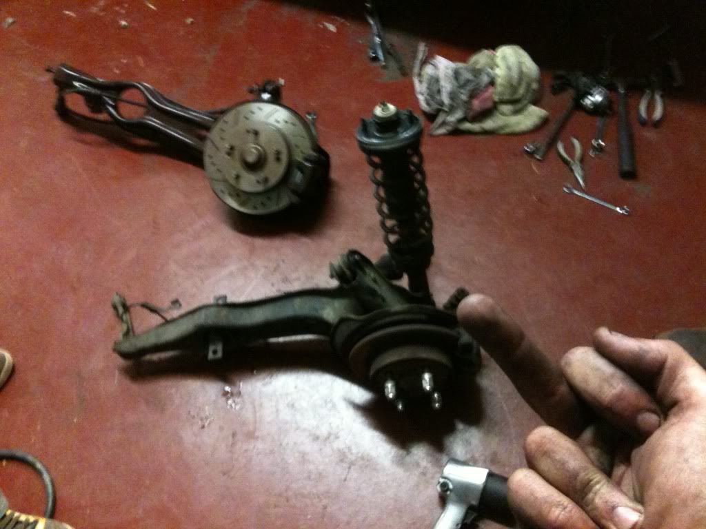

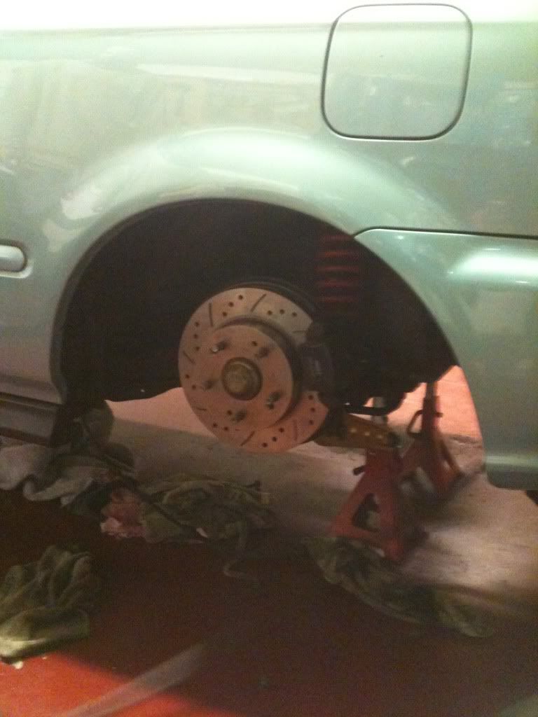

i then bought a teg dc2 5 stud hubs fully striped them down new trailing arm bushes , camber arms, toe in arms, track rod ends, bottem ball joints, new discs n pads.

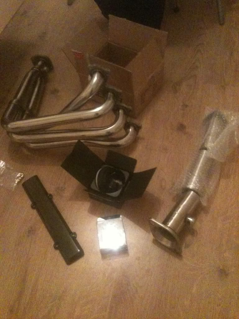

then set about getting a load of parts :-

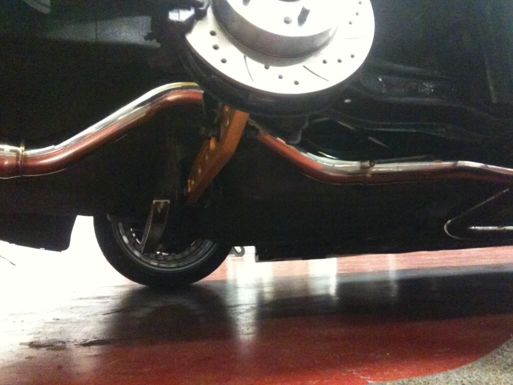

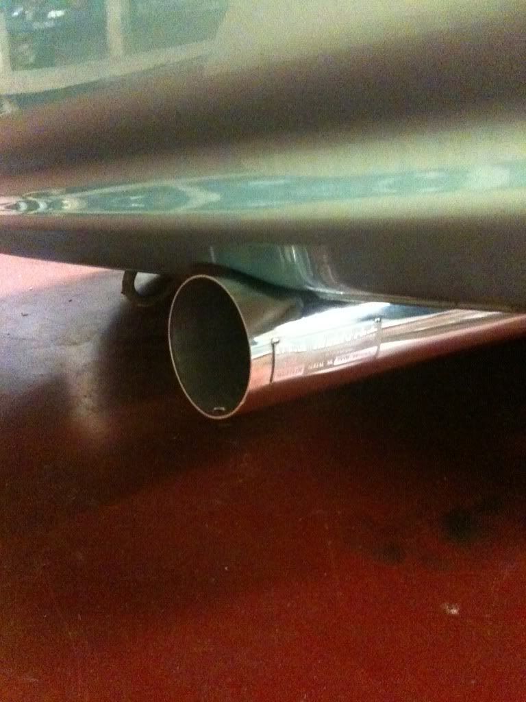

buddy club spec 2 exhaust

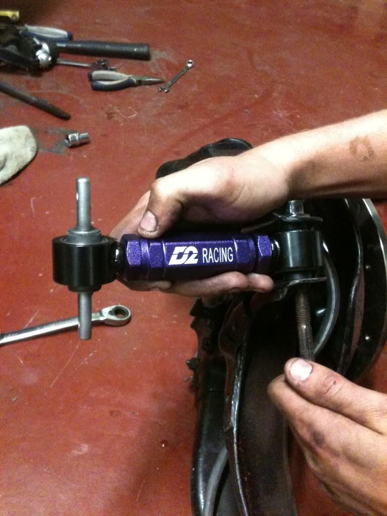

d2 front camber arms
d2 rear camber arms
beaks brace
blox lca

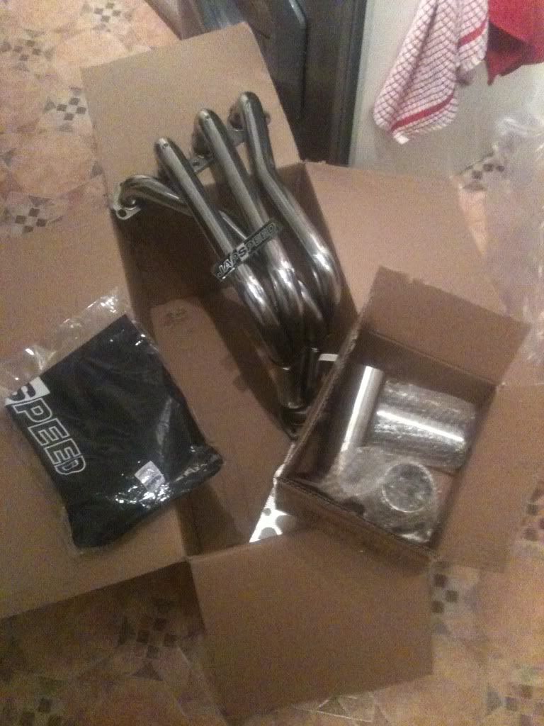

japspeed 4 in 2 in 1

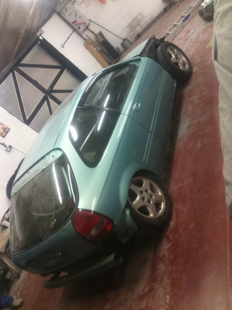

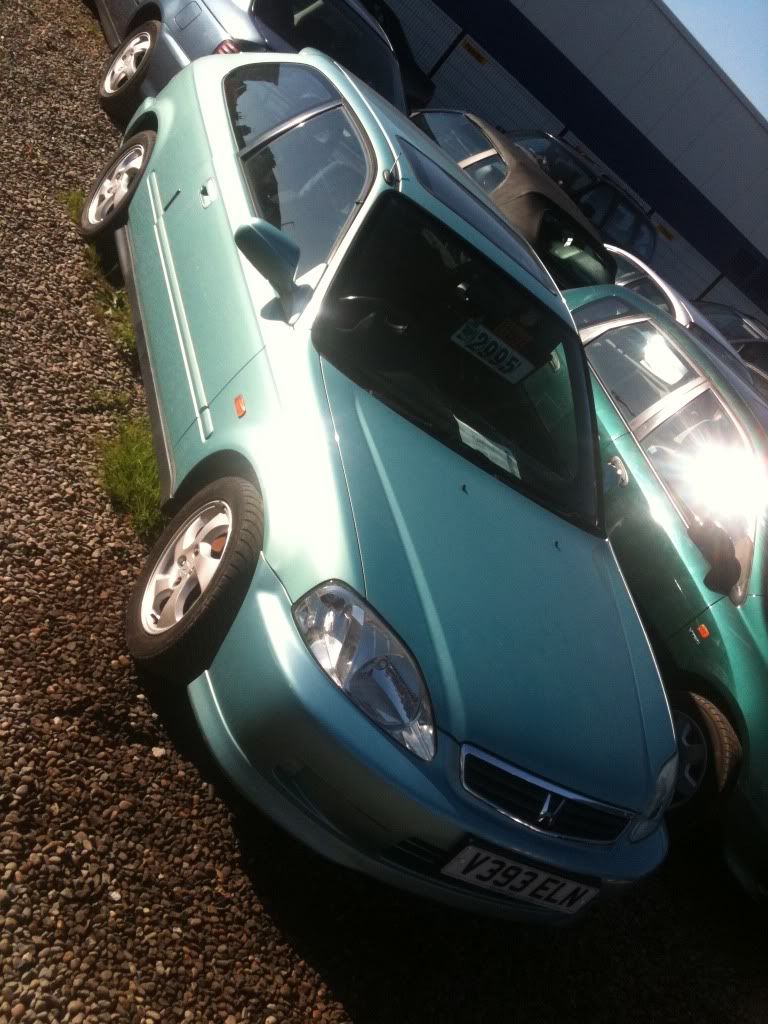

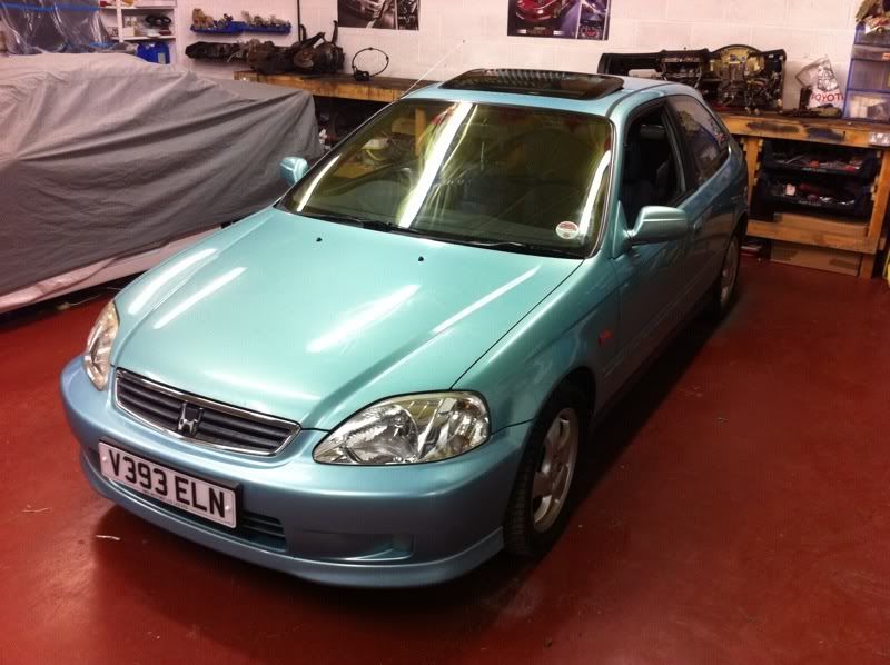

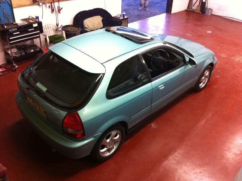

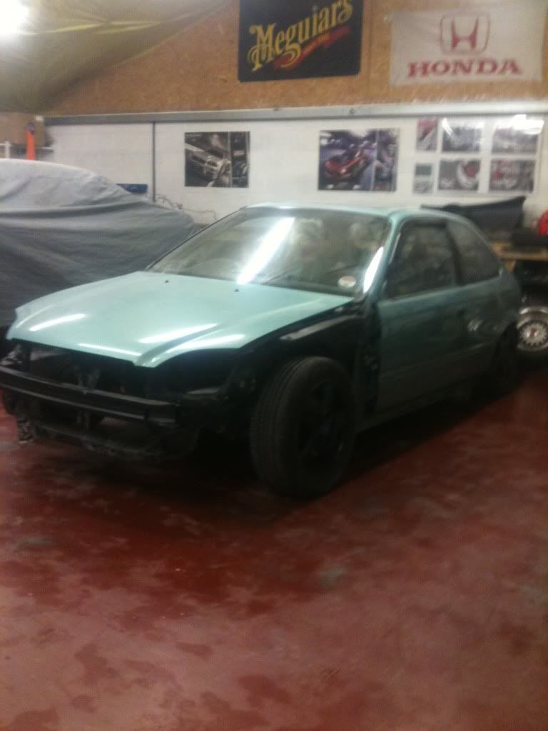

then came the time for a shell, looked at a few 1.4 at like £900 -£1100 and then do a b series swop, added it up and i was £2,500 in to a shell, then came across this vti at a dealers, was up for £2000 on the web ( dont take any notice of for sale sign) nocked him down to £1950.
on the way back ome
at my mates unit

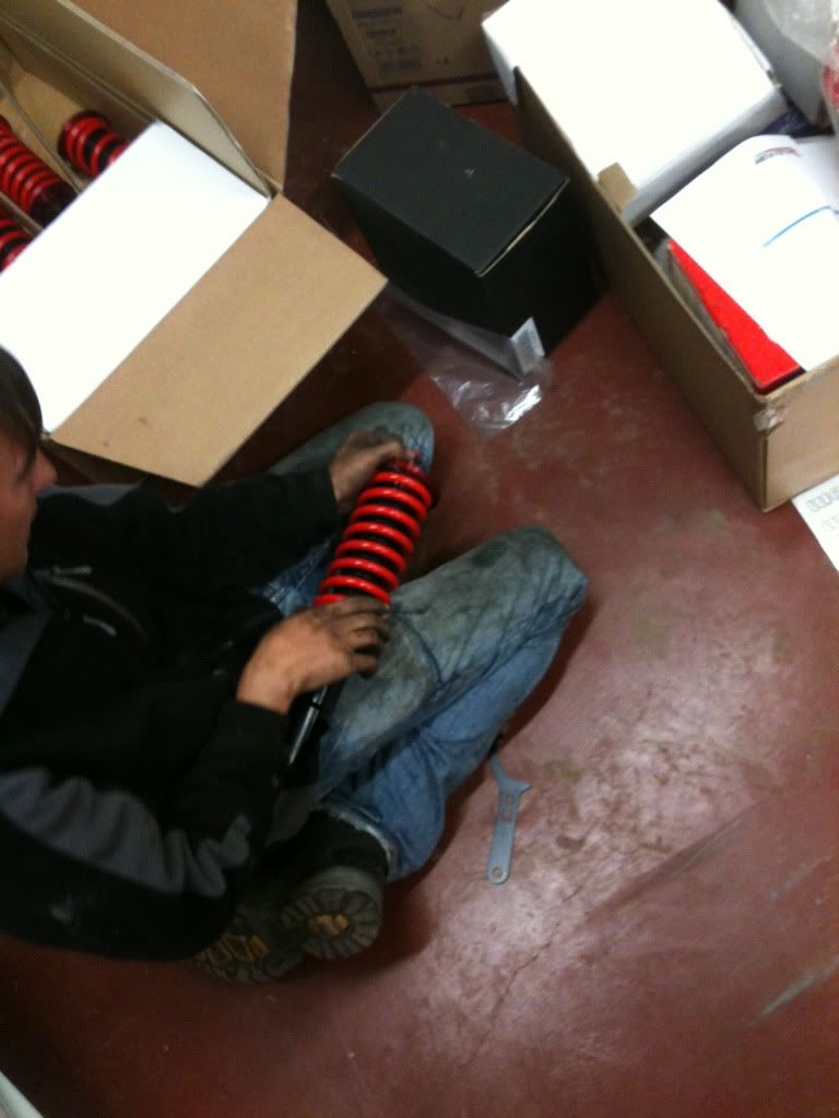

all my stuff ready to go

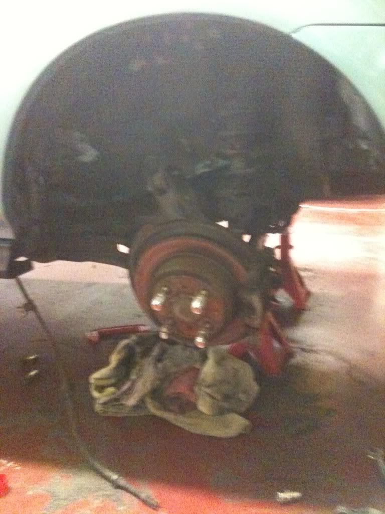

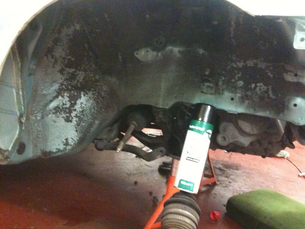

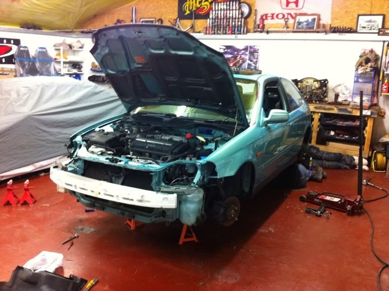

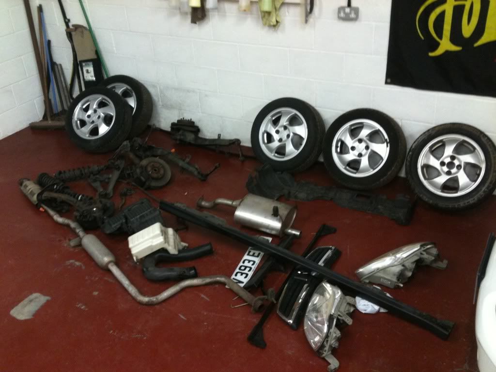

strip down begins

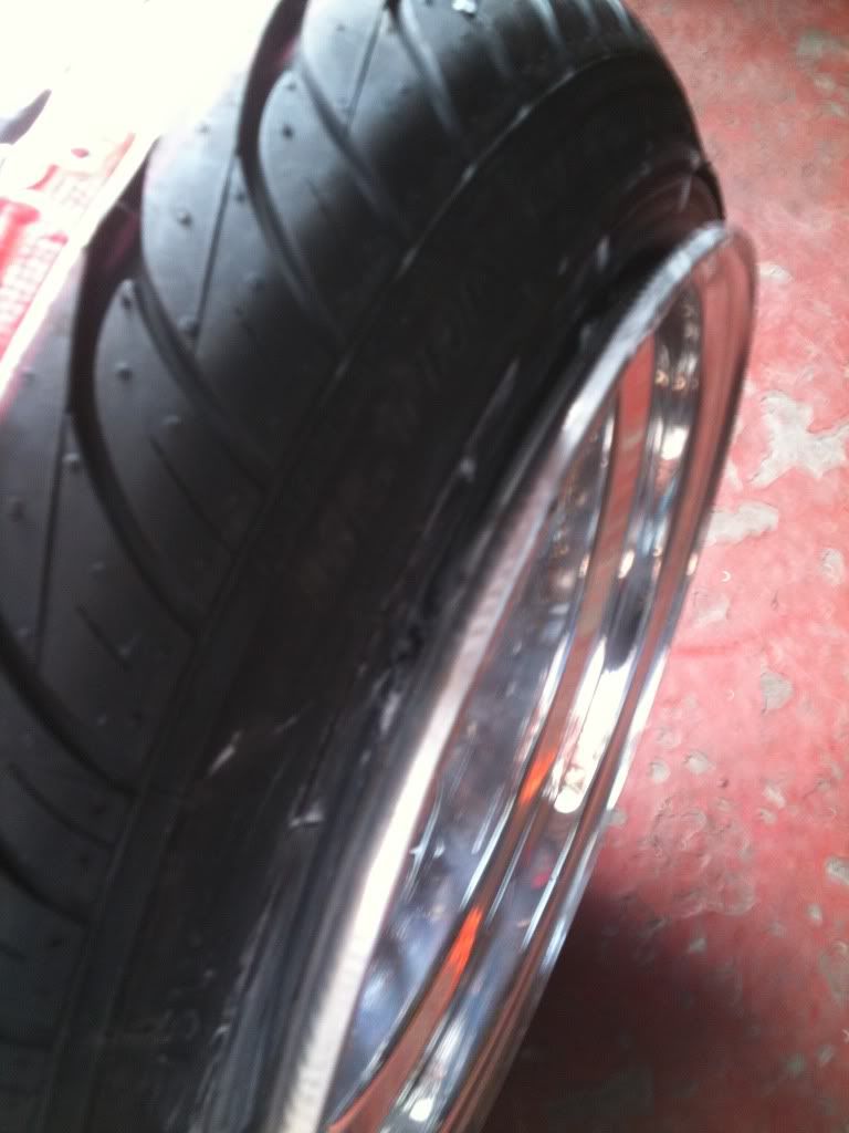

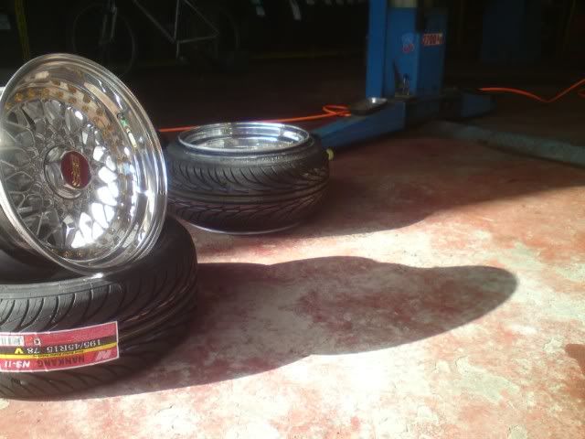

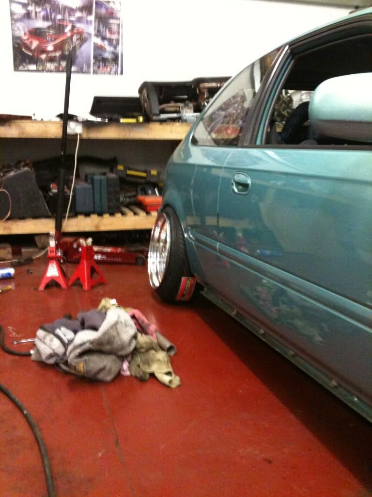

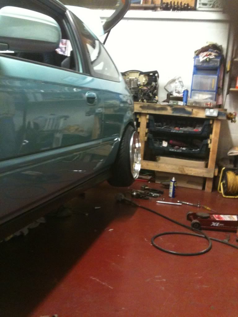

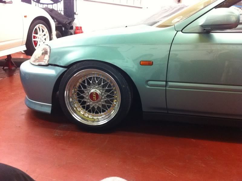

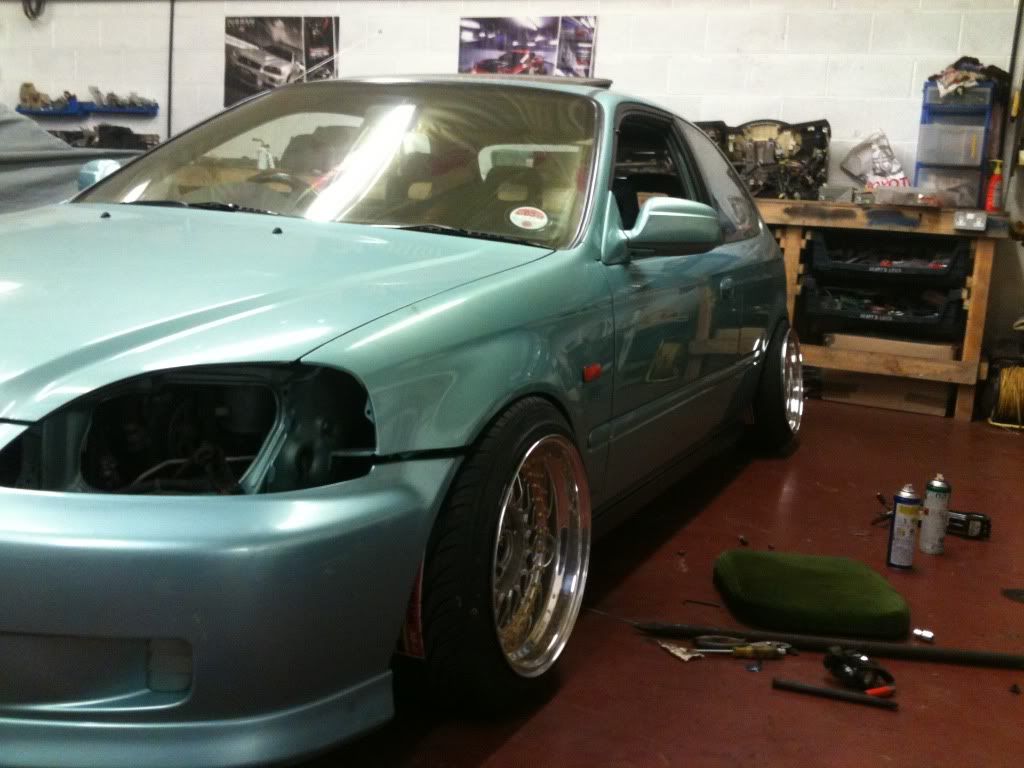

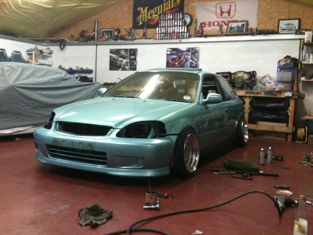

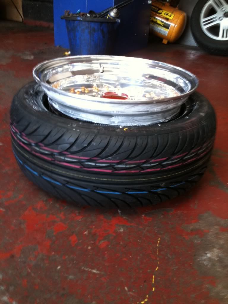

then it was time to get the rubber mounted
test fit

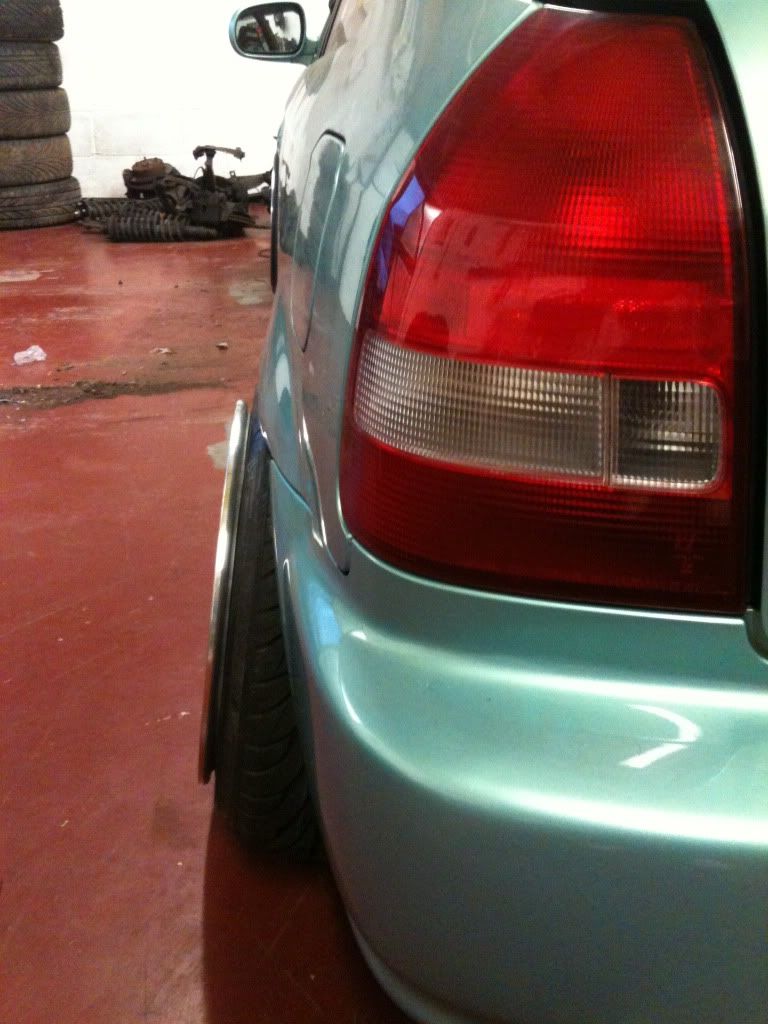

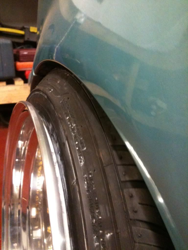

arch rollin

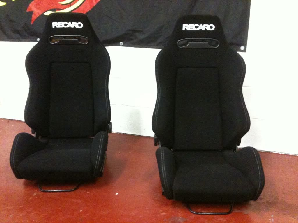

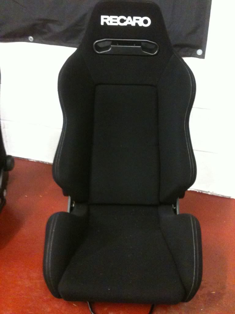

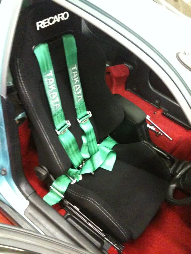

wonted to get some buddy club seats but then came across these on ebay so i bought um like brand new.
and with takatas
buddy club spec 2

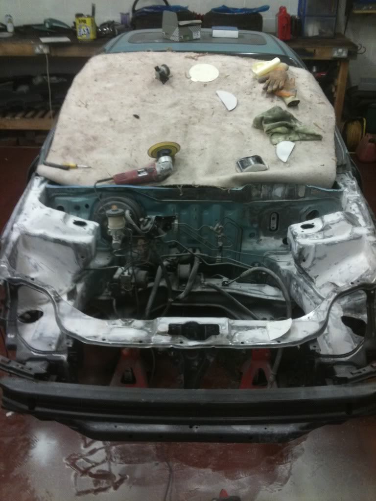

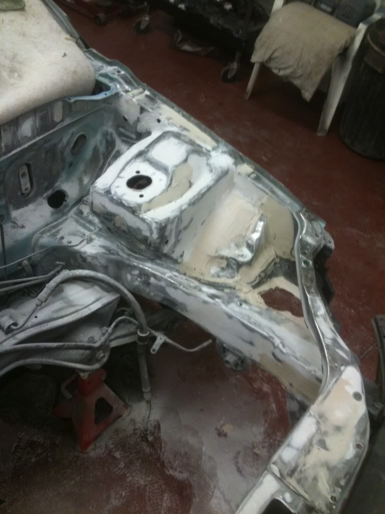

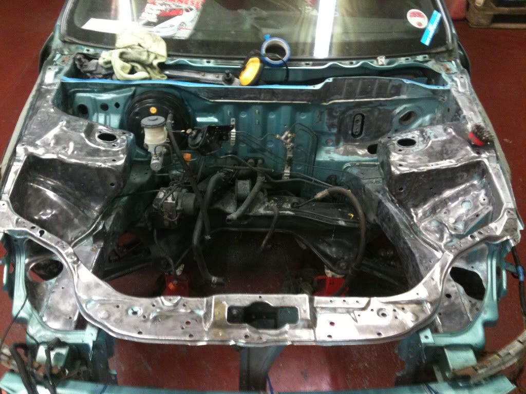

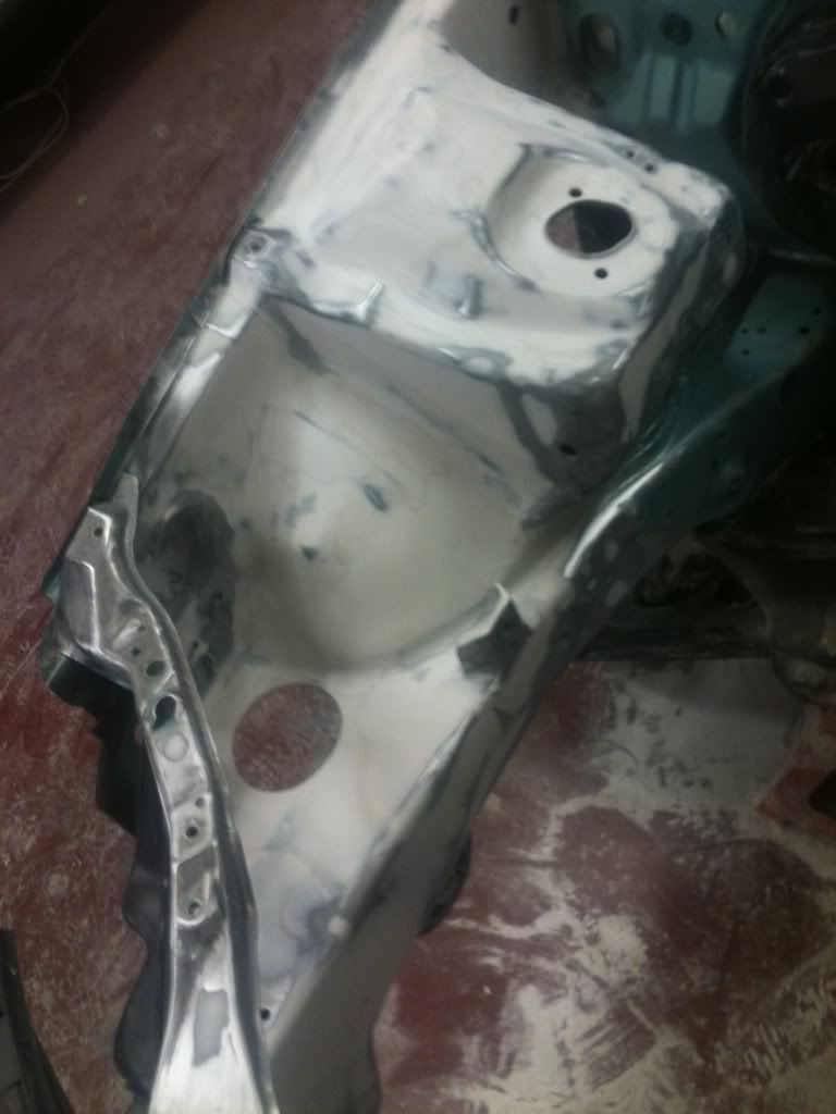

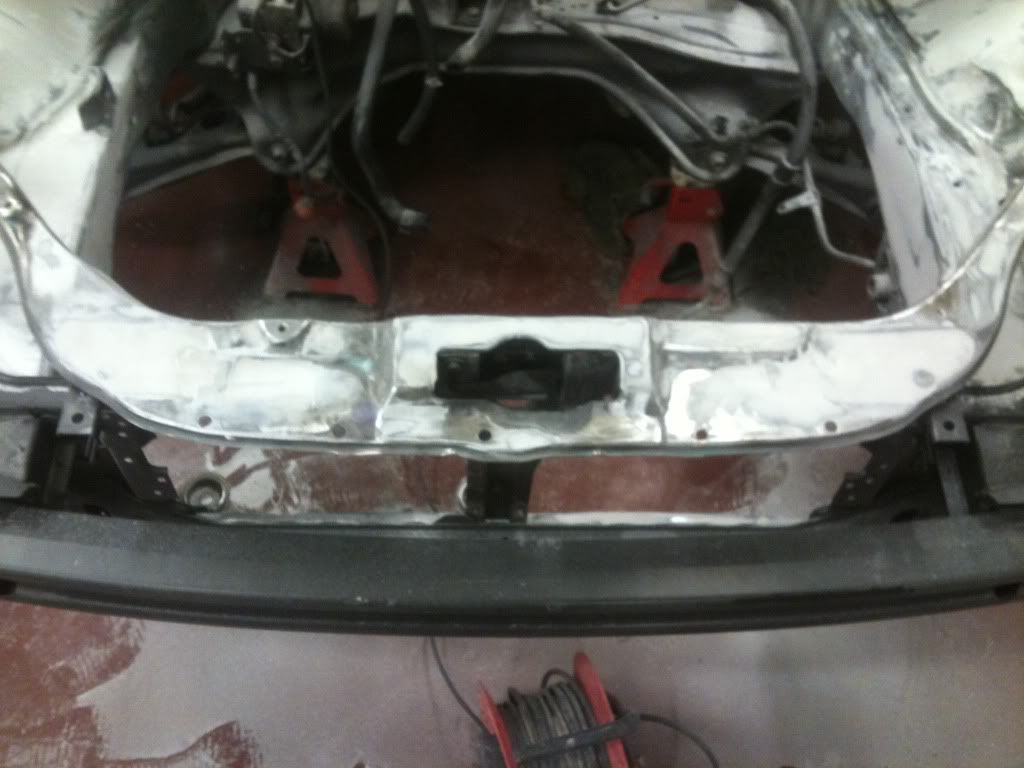

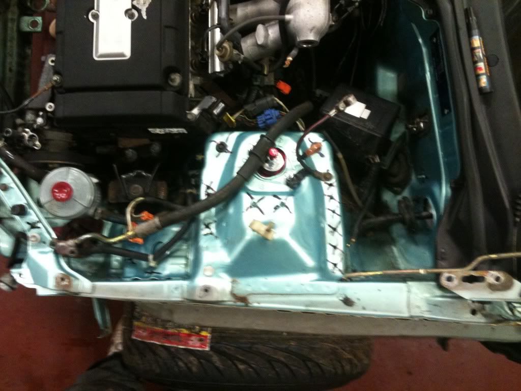

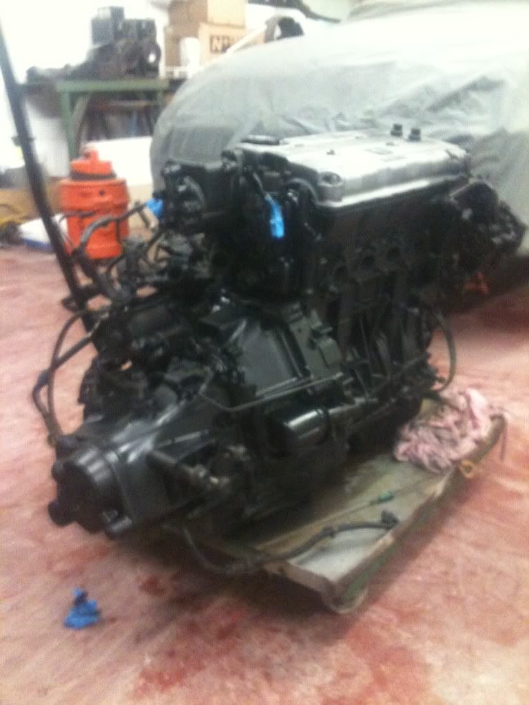

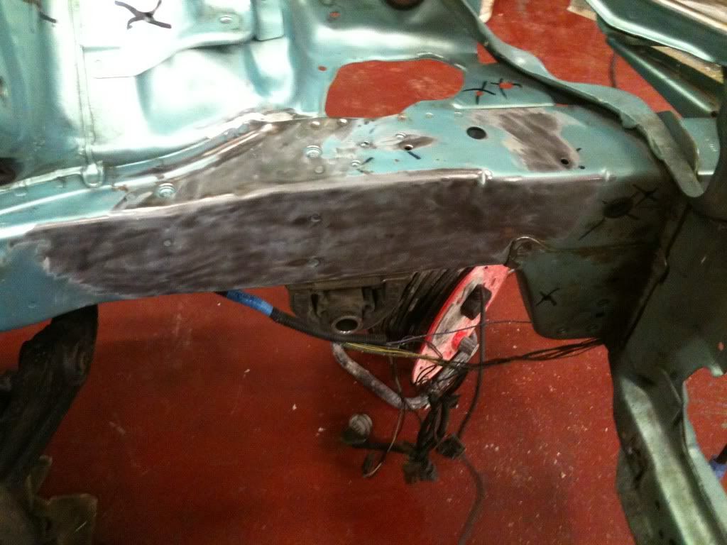

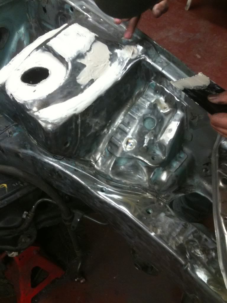

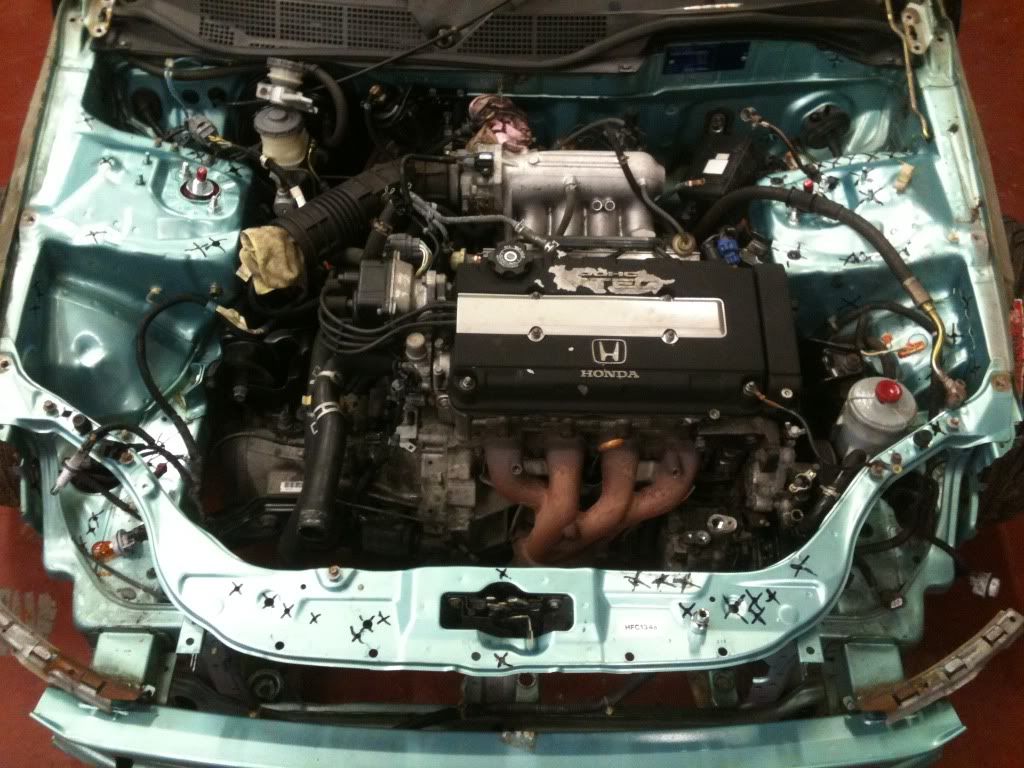

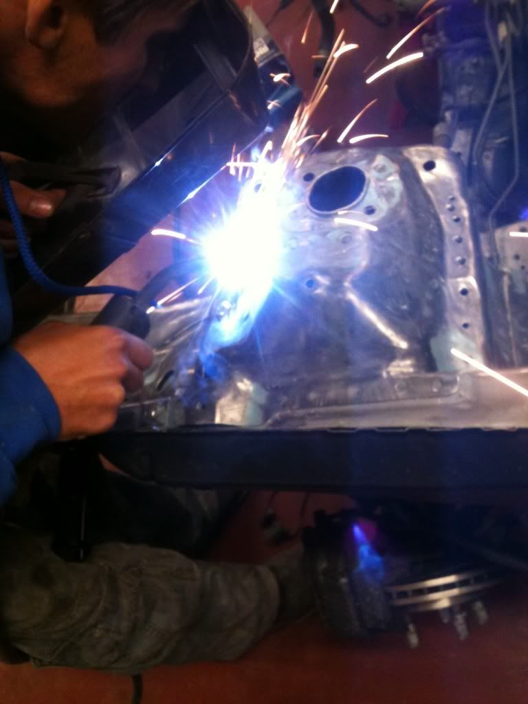

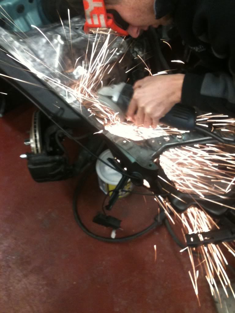

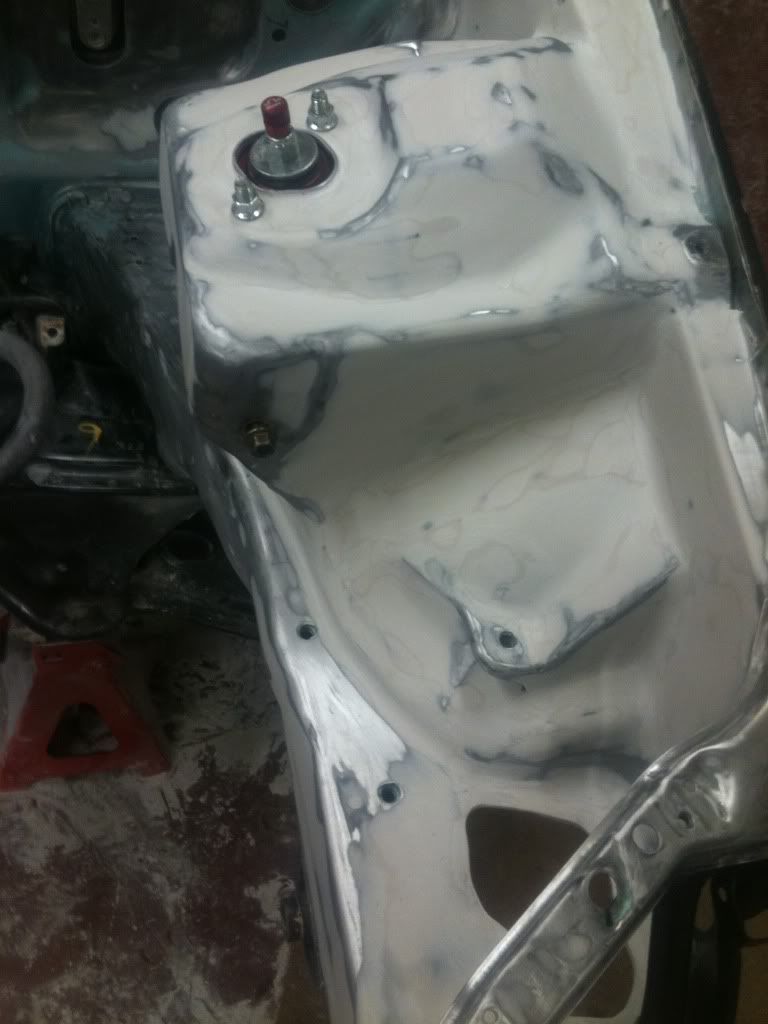

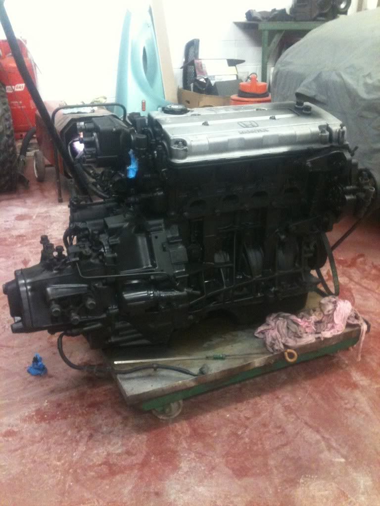

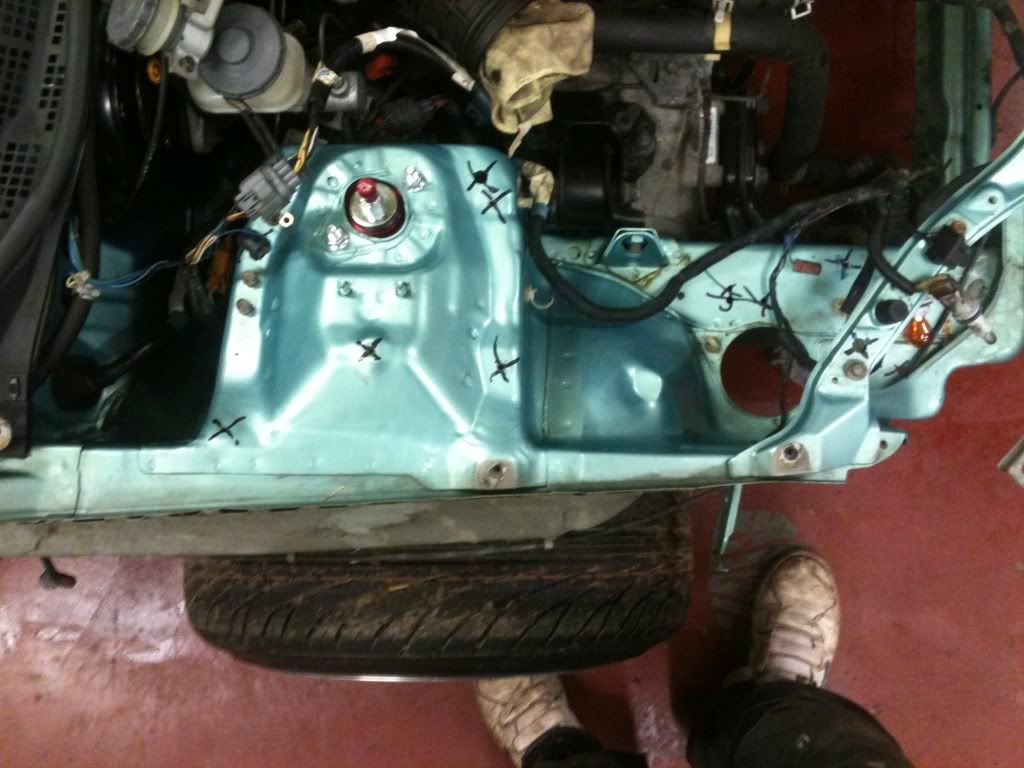

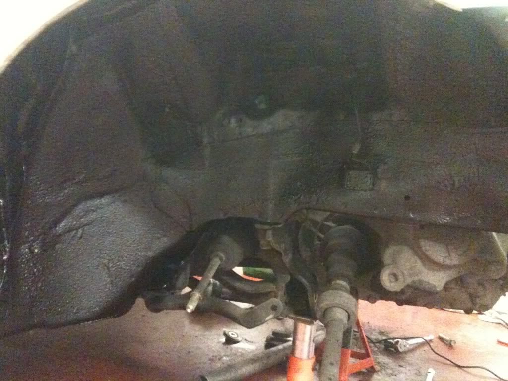

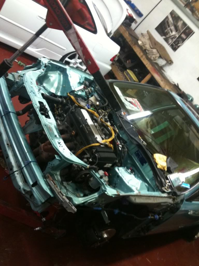

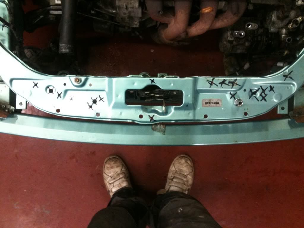

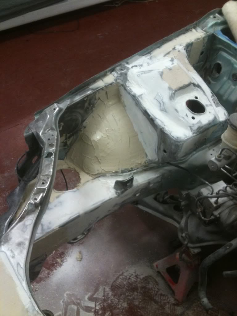

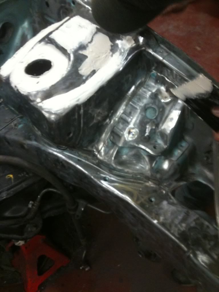

next ive marked the bay of any holes i dont need, pulled the lump out n started welding n smoothing.
show pics of that later on.

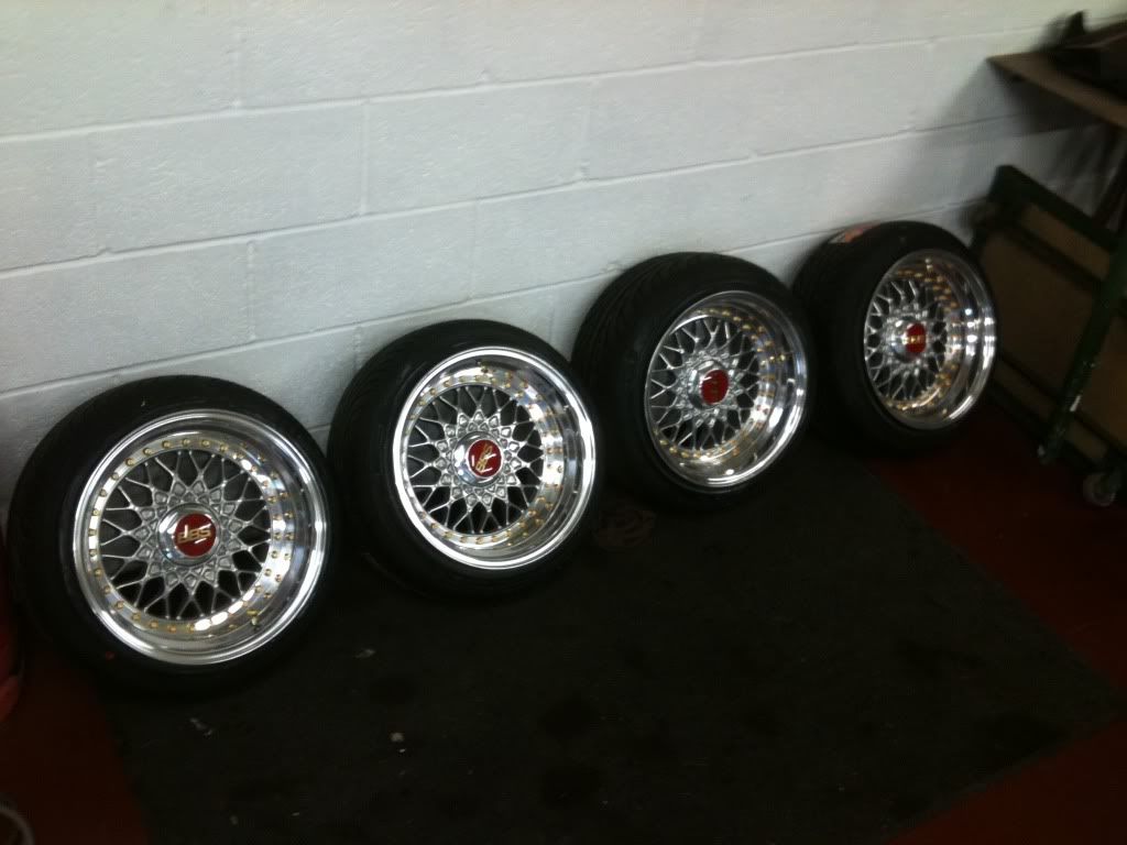

on the way back ome
at my mates unit
strip down begins
