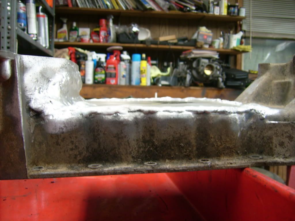

Got my upper pan back. Not the prettiest welds but they're strong.

Got more gas for the welder and finished the lower pan
