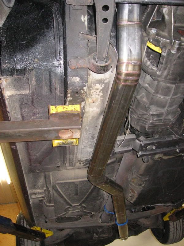

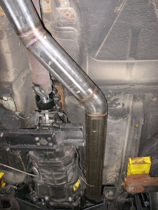

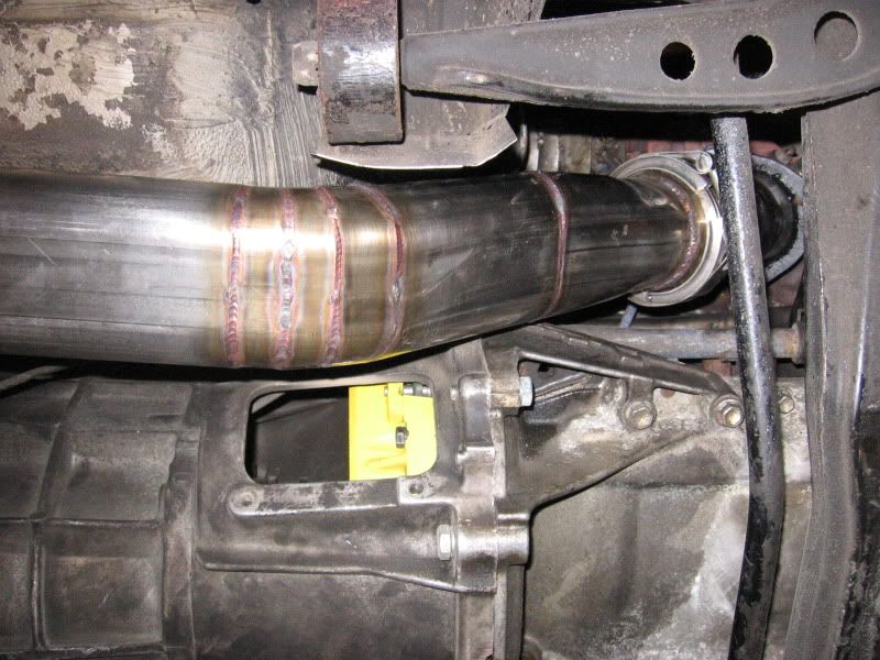

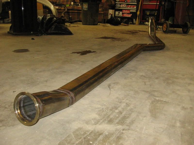

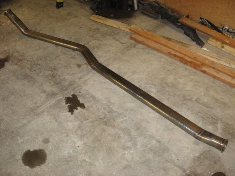

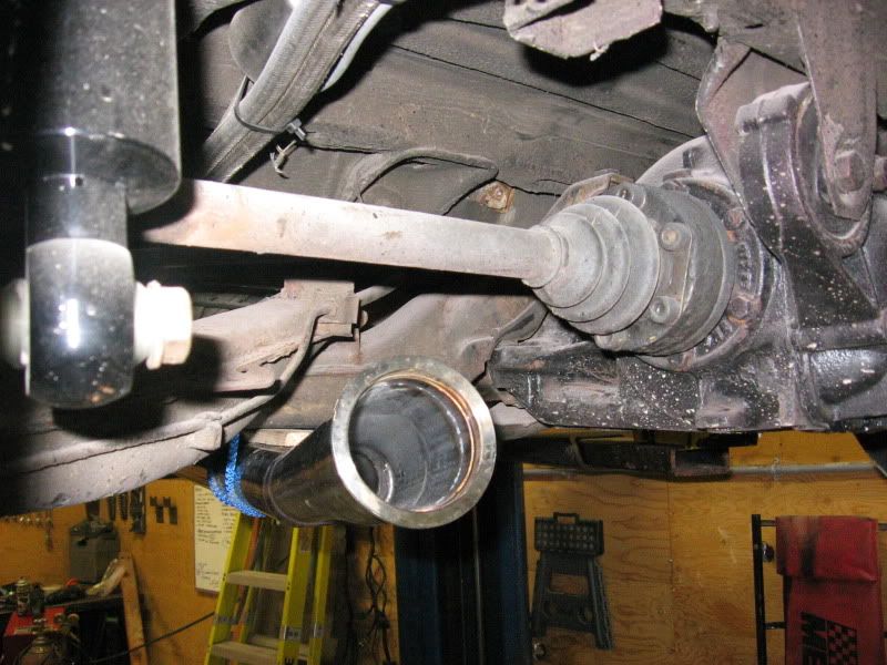

got my exhaust back all nicely tigged..
clearance is much more gooder
just have to make the axle back section now

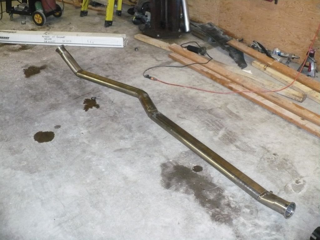

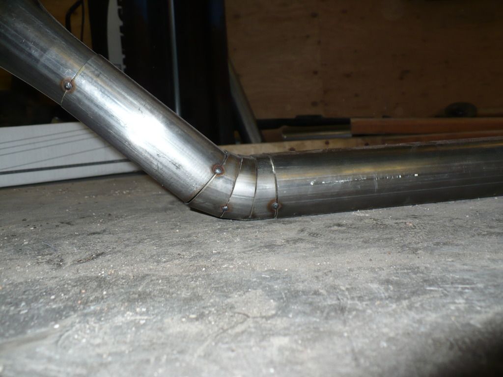

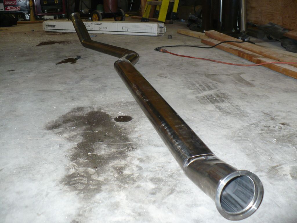

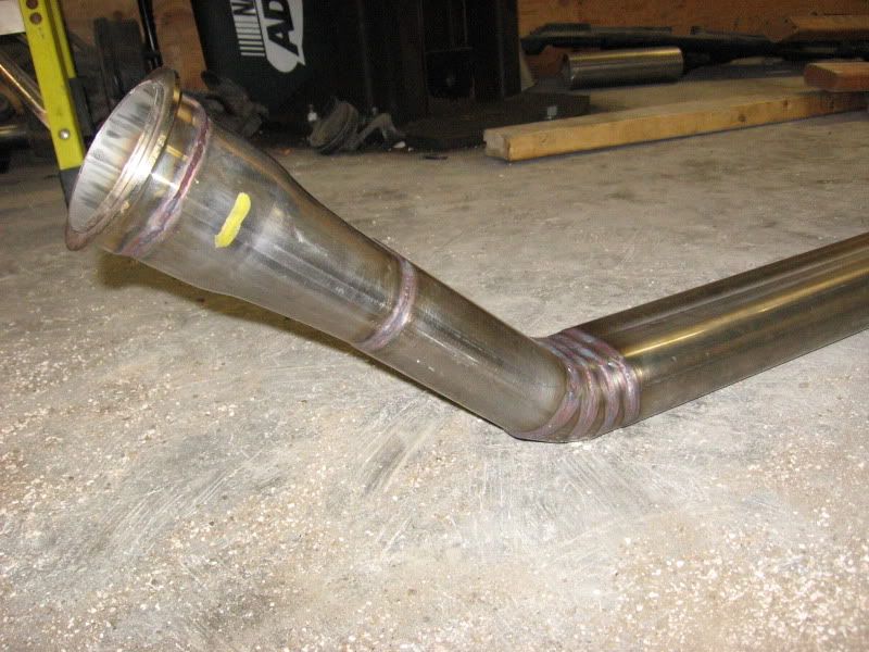

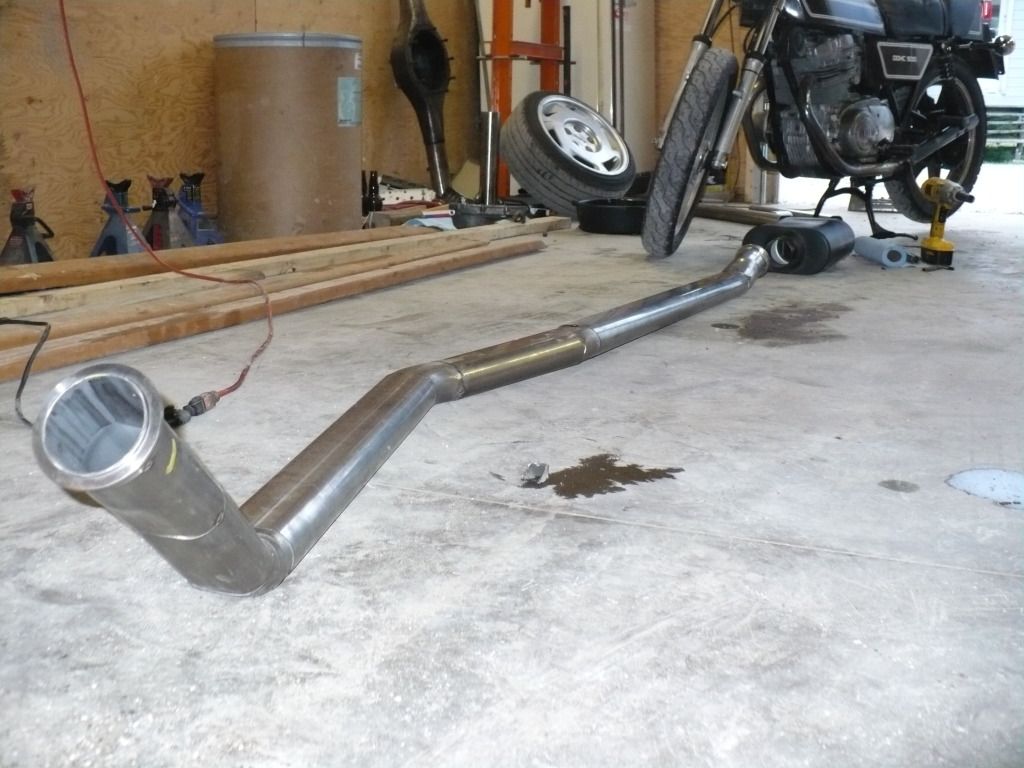

Well over the last few days Mike and myself have been working on his exhaust. It is a fully 3" equivalent ovalized tube exhaust, v-band clamps, etc.
We just tacked it together, and Mike is dropping it off tomorrow to have it tigged.
Time for some pics!
And some badass pie-cut work.

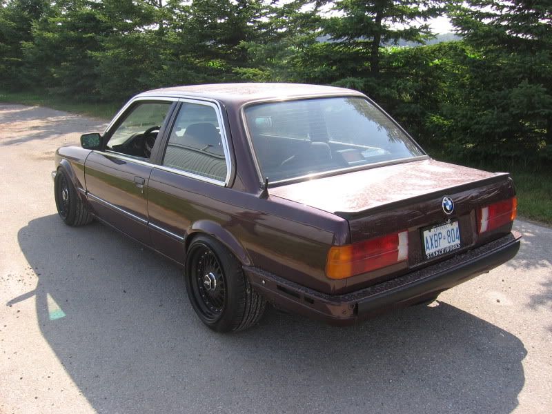

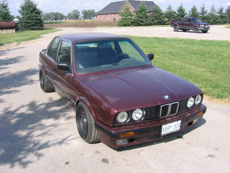

Final specs are 16x9.5 on all four corners, 26mm spacers in the front 38mm offset wheels, 35mm spacers rear 38 offset wheels.

I know the rear has to come down...already took the adjusters out...that's just the coil spring....but the tires already rub like a bastard just pulling in and out of the shop (just rears)
Leave a comment:
Amazing. I love this. Rear needs a little more low IMO but if you are going for performance then you probably don't want to go lower.
