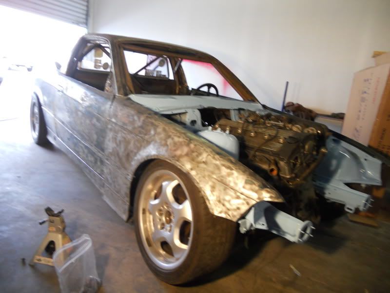

    Here is my friend Dustin Latimer's e36 truck he has been building for a few months now. its at our shop (elevens' paint & fiber) right now so i thought i would keep up a record of whats going on with the car. might as well share it i guess. you can get more info from his thread on BFC
    heres where it sits sans motor and a salad shooter test fit on it

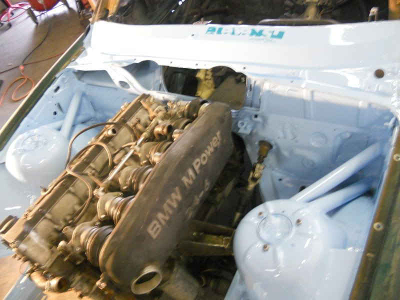

    motor mounts made for the M5 S38 motor. its really damn big
    painted the bay a few days ago, came out pretty well i must say

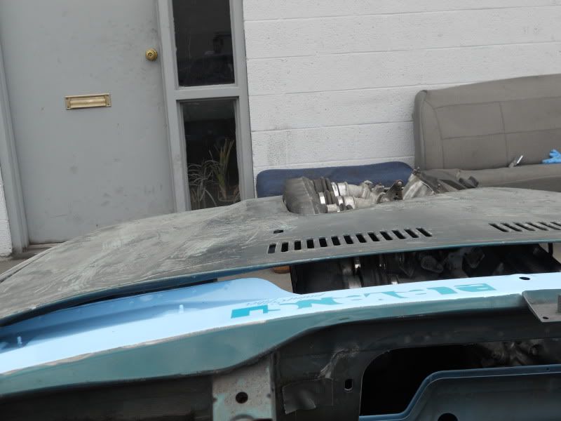

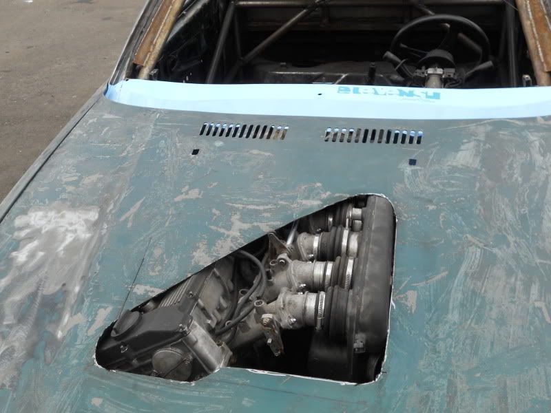

    its a cool view from the driver's seat, ITB's look sick to me

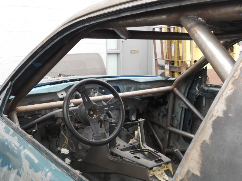

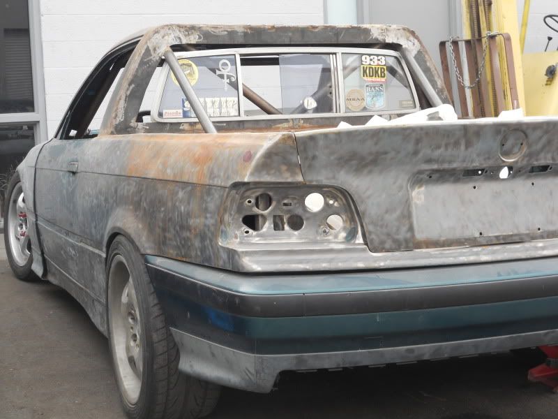

    k so the car was an e36 coupe, now has a truck bed, full pro-am legal cage, e46 arms, e36 ground control stuff, modded knuckles for angle, and alot of hours put into it to say the least. a megasquirt is being built now and a clutch sourced, wheels will probably be the salad shooters, i have 6 16x9.5s that i was going to use on my Benz but i might give them to Dustin

    I looked through the build thread though, and the door bars make me really nervous, they seem like a liability.

        please take this as constructive critisism, the motor would be better if it was mounted lower or further back (ie. cut the firewall and make room for it to fit). it looks cool with it sticking out like that but it will handle better with it lower and back more.

            the cage thing looks weird in pictures i guess but in reality its a standard x door bar (single bar going at a downward angle to a floor plate with a two piece bar going the other way to make a x) the other smaller ones are just there hanging out, not an integral part of the x. so its really just the standard cage design for pro-am stuff with extra tubes added on you know? like if you cut them out it would look totally normal. anyways i would ride in it with no worries at all.

            i would def agree that back and down would be rad, but i think the front sump deal is what got in the way? i know the pan had to be heavily modded by Evil Engineering to work with the steering rack the way it sits now and dry sump is pretty spendy so i guess this was the most effective solution. the fun to dollar ratio on this thing is still looking pretty good, i think thats more the main goal than anything.

                            if i had to GUESS i would say the car might be heavier after all of this. cages, especially overbuilt ones, add alot of weight. you just cant avaoid it though since all comps pretty much require it. if you limit the car to only practice events you dont get as much driving/fun time. and the truck bed is alot of metal, it looks pretty heavy...
