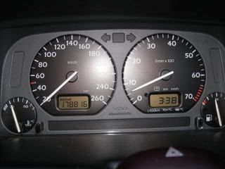

    Had 178XXX kms, steering wheel neeeded TLC, interior plastic was good, seats are probably 85% condition, paint/body work needs attention imo, mechanicals are good.

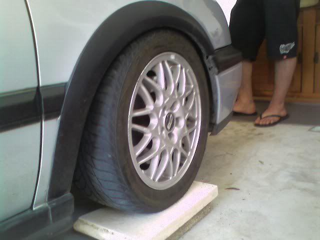

      Now for some moar low. A group of about 4 mates, installed JOM coilovers into the little Mk3. I also didn't know how "low" it was going to be, so we took precautionary measures by using pavers. I'll let you be the judge
      H&R Camber bolts were ordered.
      Note: I recommend you get replacement Strut mount rubbers and bearings and install at the same time. Saves you pulling them out again, unless you want the practise.

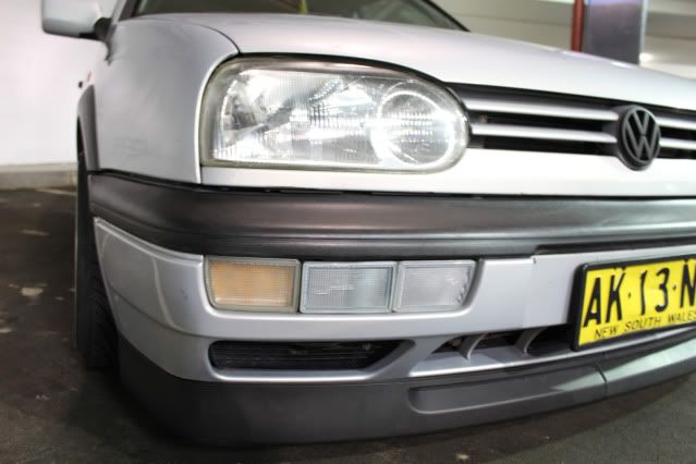

        Euro VR6 lip was installed:
        - Mal

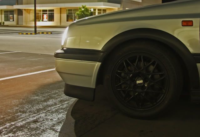

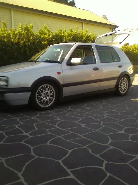

          Then came the black wheels, just for a cheap, different look and to help clean up the wheel presentation. Bridgestone Adrenalin RE001's were fitted, 205/50/15. Really really nice tyre!
          Have EBC Greenstuff pads waiting to go on the 280mm rotors as soon as the pads I have wear down....
          - Mal

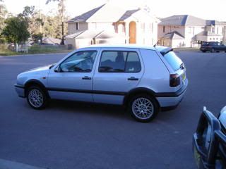

            As the beast sits now (has been raised to a much more suitable height)
            I am quite happy with how much better the car presents but there is still plenty to do. Switching between mods and maintenance is a good balance to have. Keeps things interesting

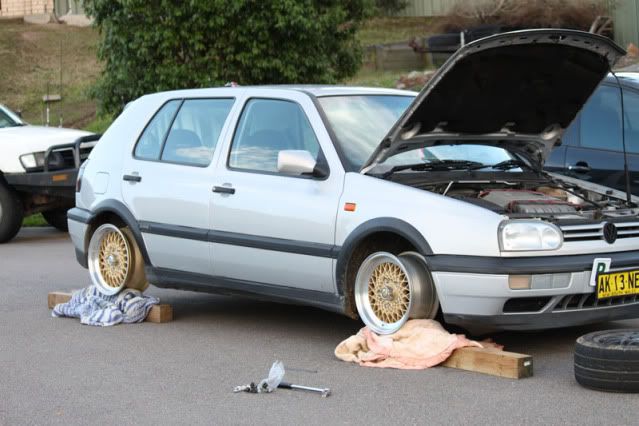

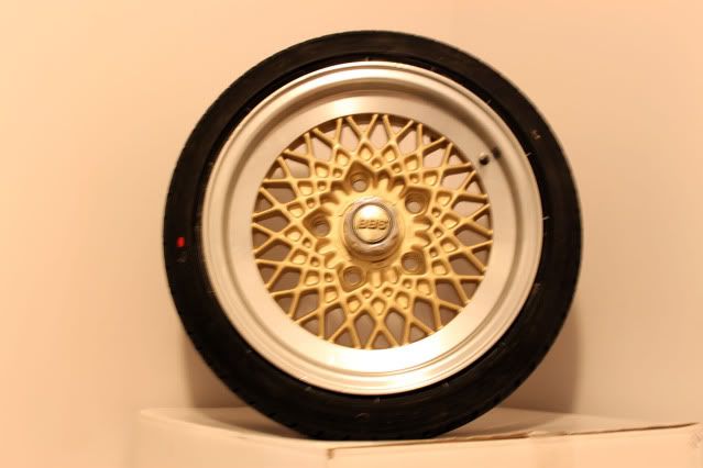

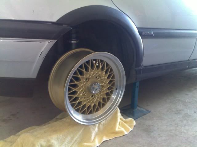

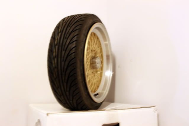

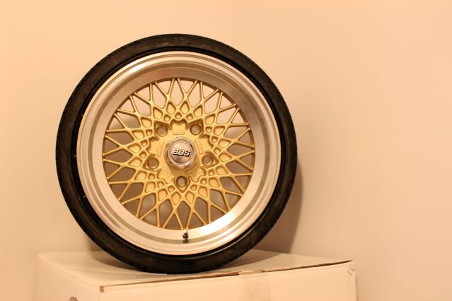

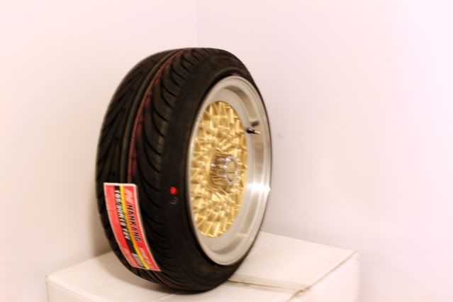

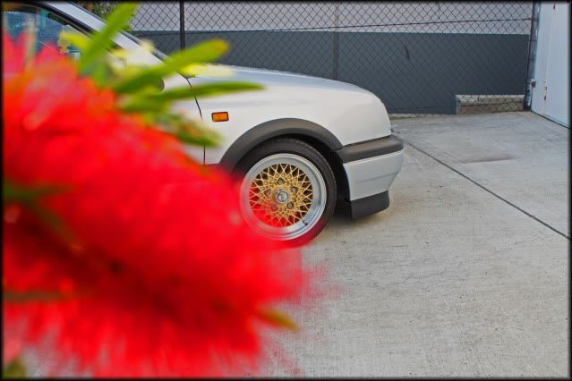

            15x7 ET23 front and 16x7 ET23 rear BBS/Mahle wheels. A friend of VWW showed them to me and I had to have them for obvious reasons. Love the centre caps. I hope it's not too much, but I will cop a little bit of poke with this set-up, which I am not worried about.....
            Dummy fitment without the adapters:
            - Mal

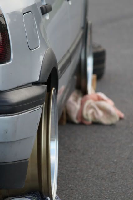

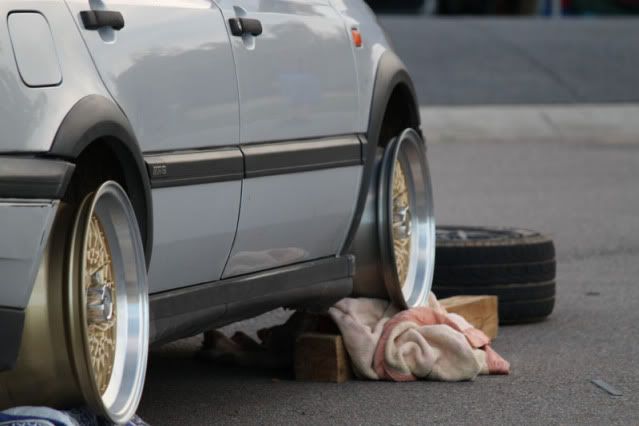

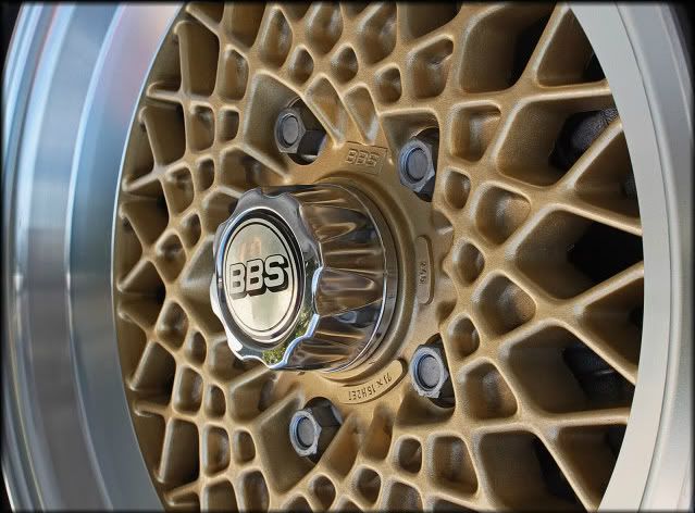

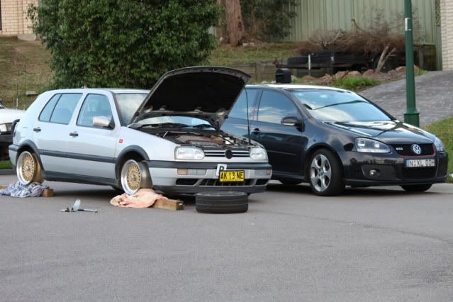

              Ok so test fit of the wheels, few things to fix up to make it all mickey mouse, (apart from put rubber on). Excuse the filthy car, been out of town all weekend and moto riding etc.
              H&R adapters 15mm front and 20mm rear. (Had to have the front bolts to the hub machined because they aren't cavity backed wheels.
              Final offsets are +8 and +3 (only on a 7" though )

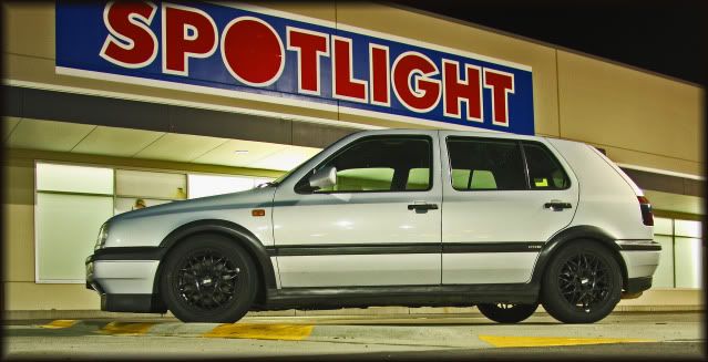

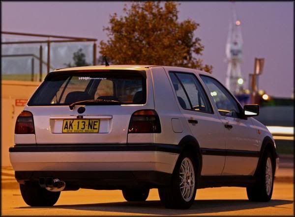

                    First shot of it.
                    Got wound down later and a NA Vento lip put on. (Smashed the euro VR6 one)
                    Also got defected so sold the exhaust pew pew pea shooter ftw!

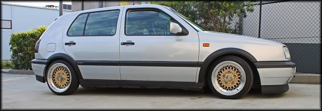

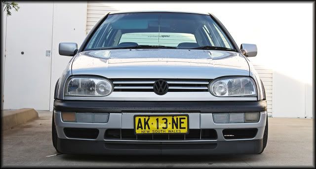

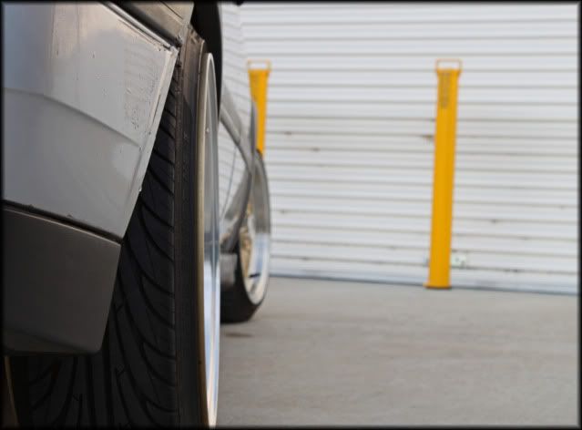

                        -Moar lows. It didn't come down evenly will need another dig tomorrow. But looking better every time. (Not to blow my own horn though!) Will get a good suspension checking over and another alignment done on Friday.
                        Yee all like pickshers, been learning. These were very quick but hopefully a couple of different "feels" to them.
                        Brake Clearance...

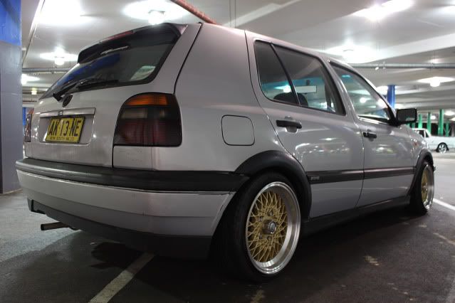

                          Few more pics:
                          - Mal

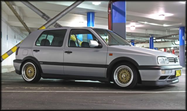

                            That's pretty much as it sits now.
                            Got a "wrong fitment crew" and some pedo bear stickers just for some more fun but haven't touched htis in a while.
