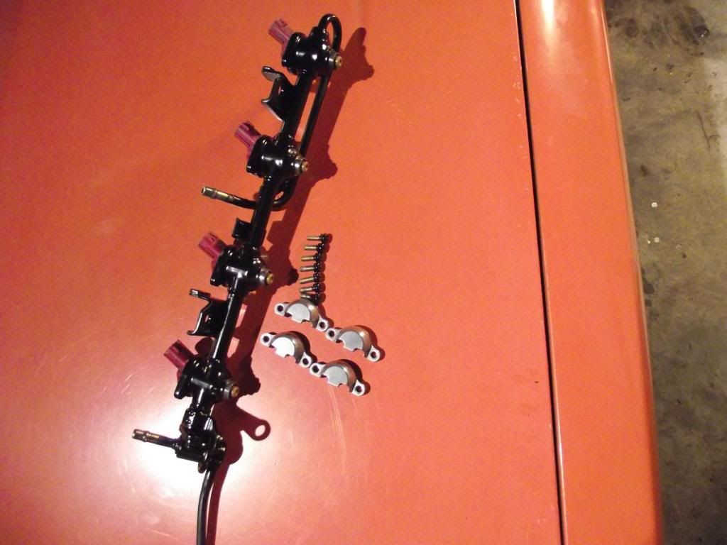

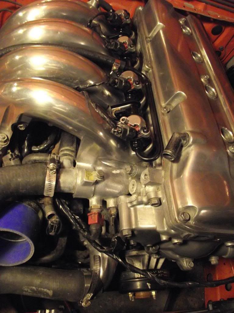

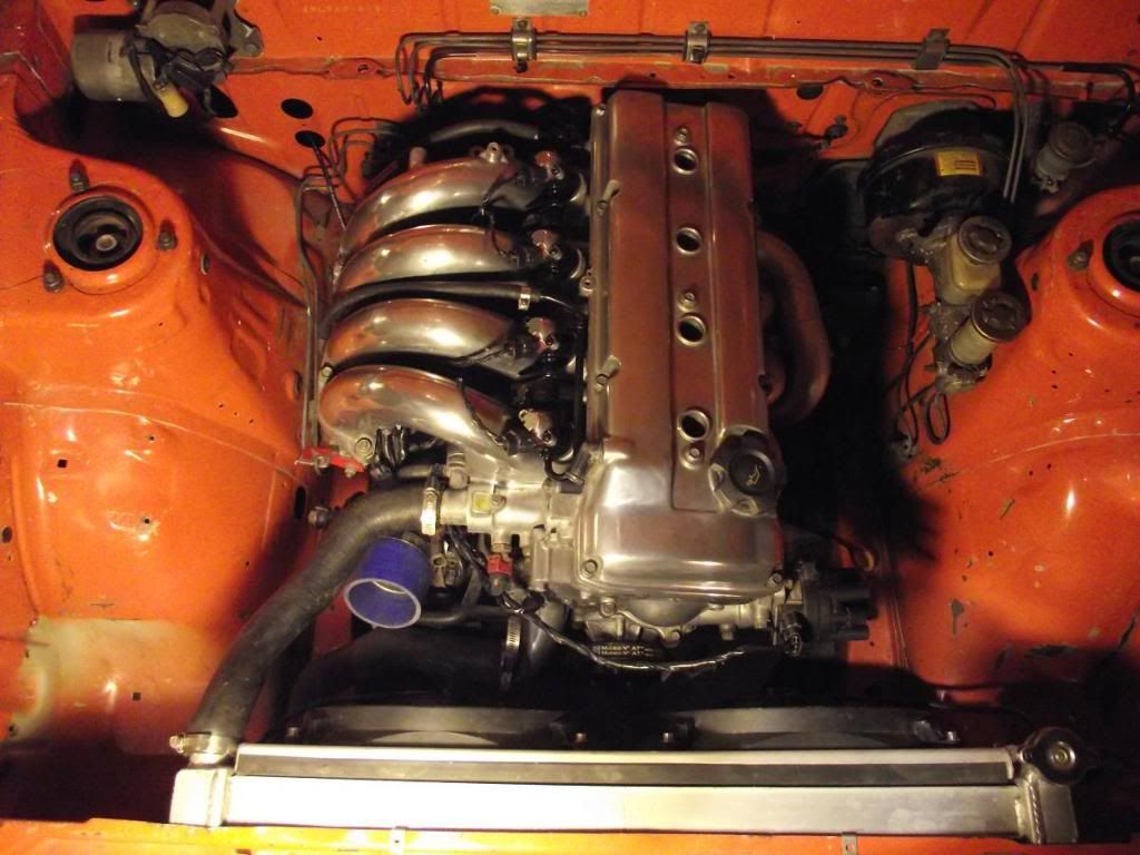

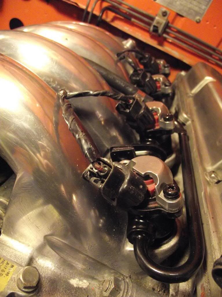

    I painted the fuel rail with hight heat satin black:

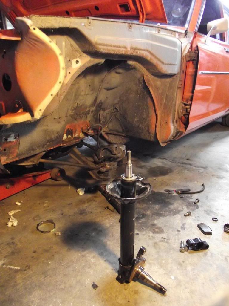

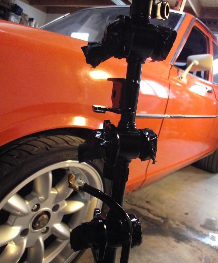

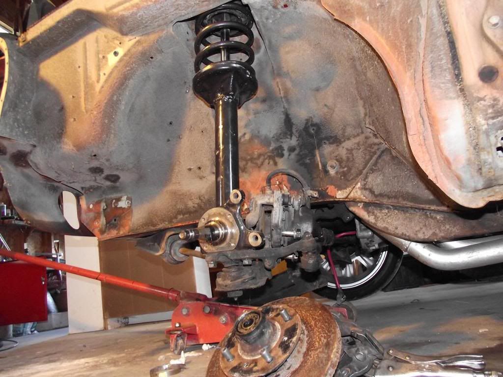

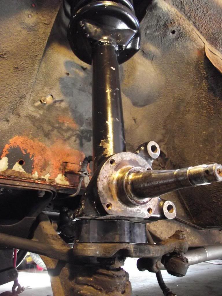

    All of the pics so far with 280zx struts have some positive camber....

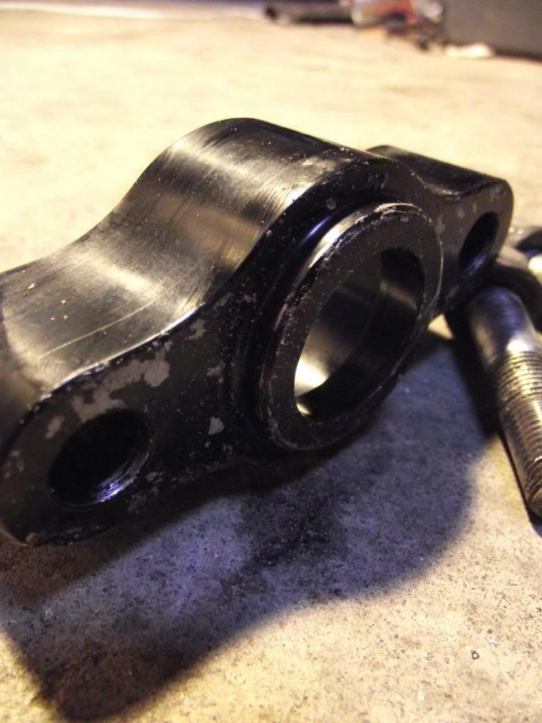

    I needed a 1 inch RCA (Bump-steer-spacer) .... to correct the angle of the spindle:

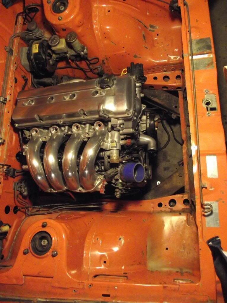

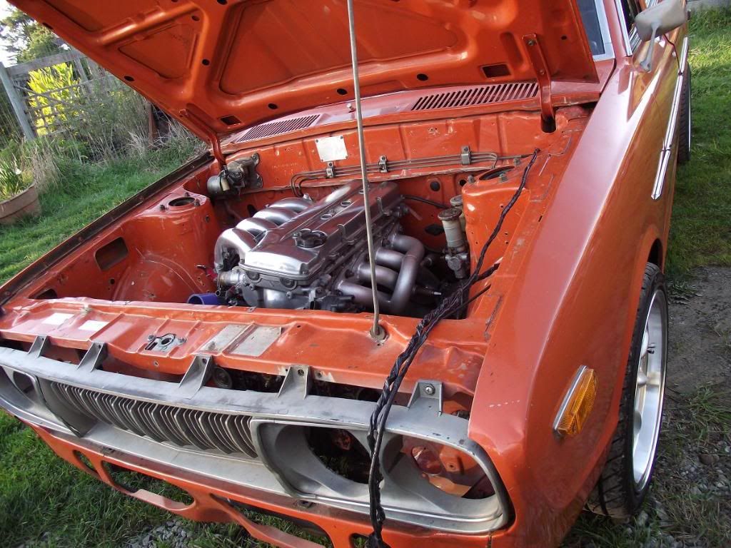

    The wiring is still not done........ but it works......
