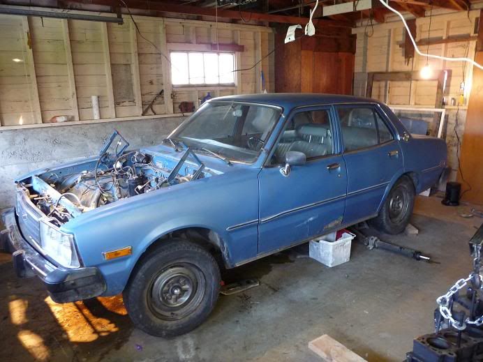

So I picked this little lady up a while ago. I guess it had been sitting around for about 10 years or somthing like that, and then the kid I got it from, drove it around, blew the head gasket, sold it to me.
Now I've had the car for about 2 years now, so I will try to catch you guys up.

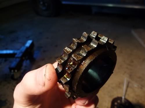

I got the car home, took the head off to replace the headgasket, and decided to checkout the timing chain while I was at it.
It looked like this:

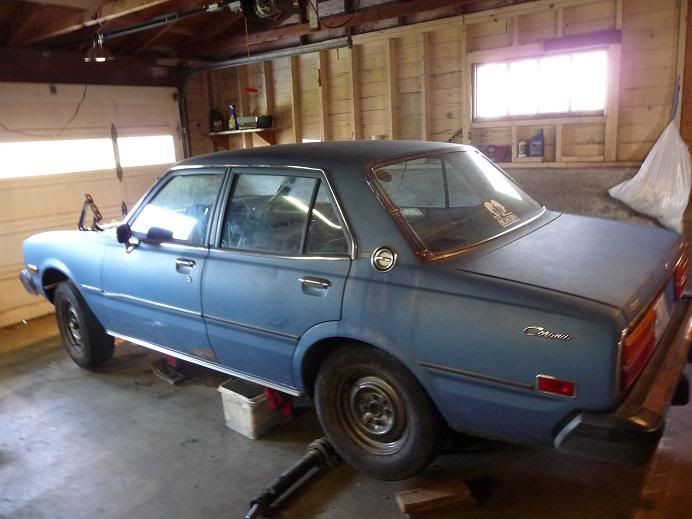

and I was like "oh dag!" So i pulled the rest of the 20R out and took pictures apparently.
(Oldest known pictures of the car):

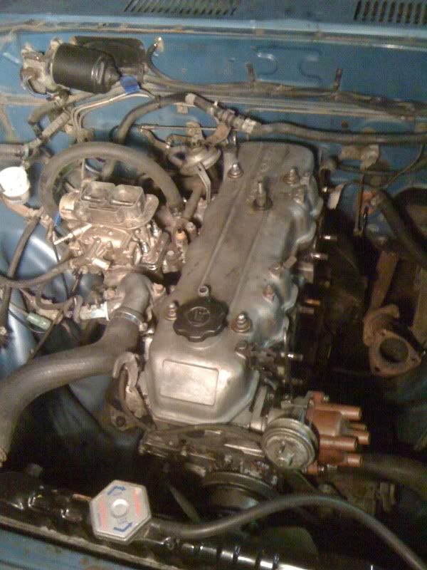

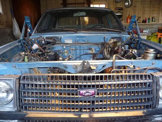

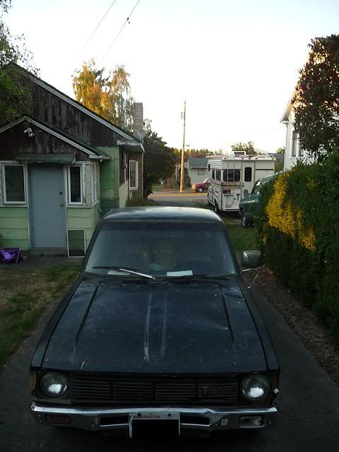

Moving on. I ended up getting a 79 toyota truck for $100 that had a pretty strong running 20R in it, and not much else...seriously, the thing was a heap besides the motor that was in it.
So I pulled the motor out of that, and found out it was a 21R, not a 20R.
The 21r was a japan only variant of the 20r, that was a 2.0L instead of a 2.2L. besides that, not a really big deal, there was alot of them imported in the 80s.

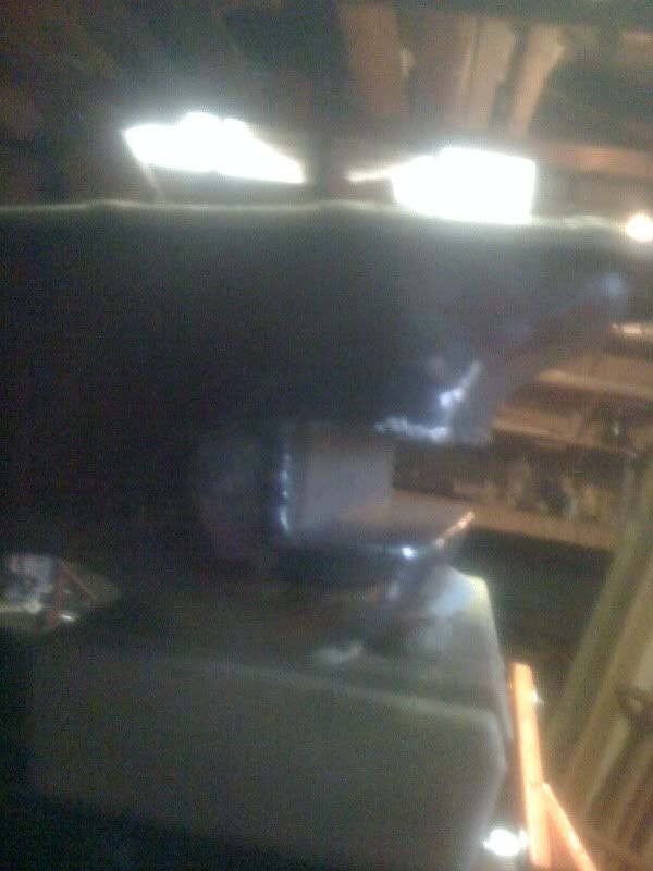

So I go to drop it into the corona, and it dosent fit! the oil pan it a rear sump, so it hits the rear cross member, and some steering components. Balls. and the oil pan off the old motor wont line up with ANY of the holes on the block, because the 21r block is like a 1/4 inch wider on either side than the 20R. Damn.
So i did this:
and I also had to notch the rear cross member to fit around the pan, but hey...at least it fit!
I also took this time to remove about 70lbs(srsly) of emissions crap out of the car, add a weber carb, and clean up the bay a little.
