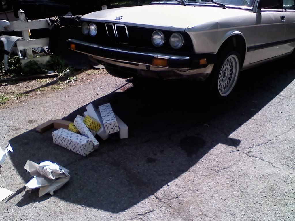

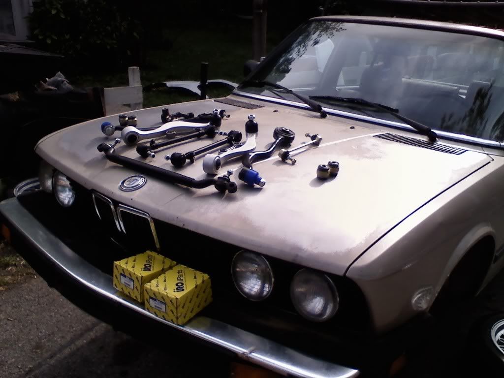

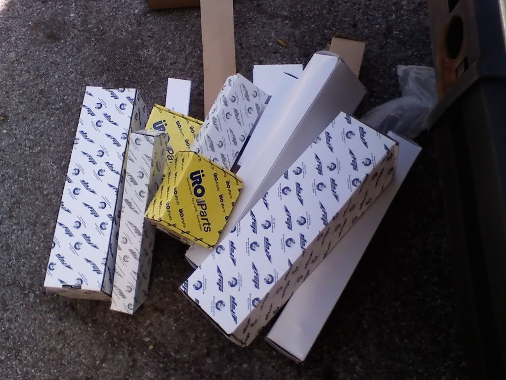

got that voilent death shake dealt with. the inner tie rod end and idler arm on the passenger side were totally shot. A bunch of bushings are bad too, but so far I just did the inner and outer tie rod ends, tie rods, idler arm, pitman arm, and the steering bar between the two. Still yet to install are the sway bar end links, upper and lower control arms, and a few other bushing type things. Got a 6 month warranty on my alignment so I can keep putting things in and have that put back to spec. word.
