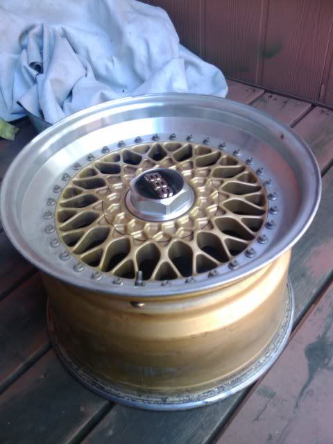

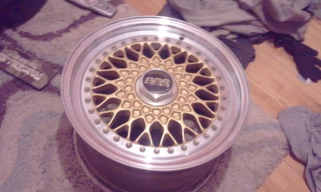

    I'm totally broke right now with payments to make.. but I don't care, I'll borrow money if I have to. These babies are local and 5x120. 16x9 and 16x10, corvette offset, perfect for adapters. will 5lug swap and rebuild wheels to fit in the future
