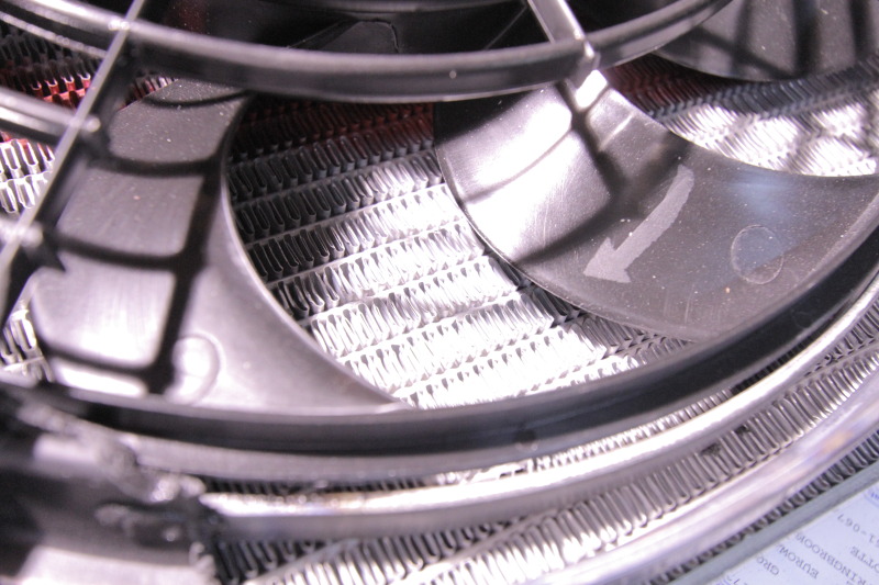

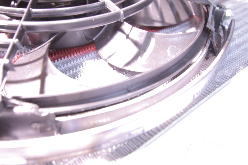

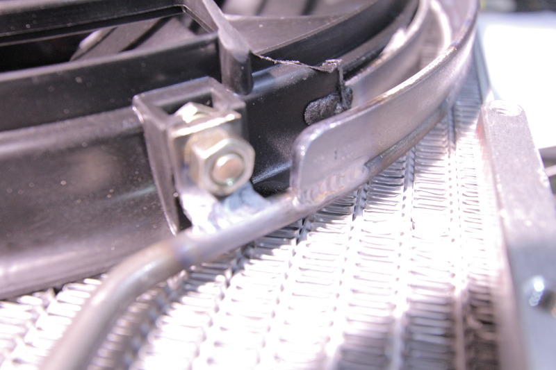

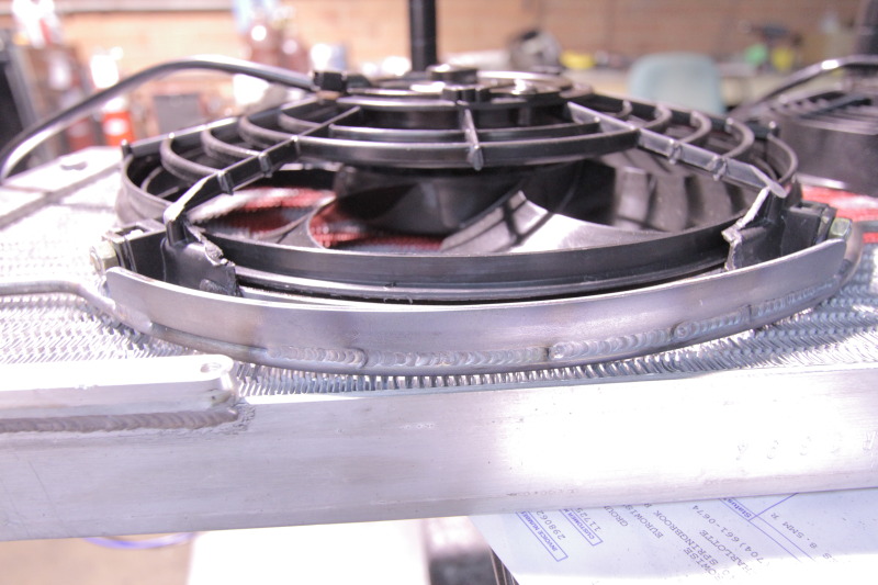

    the fans were mounted next. with the little amount of room we had to work with we had to run a staggered fan setup
    top of the fan on the passenger side had to be modified to clear the intake manifold and make room for engine movement
    the fans are held in place with steel stock rod and brackets were made to bolt fan into place instead of using zip ties
    with material removed from the passenger fan we made a small steel shield to act as a cover to prevent anything from contacting the fan blades

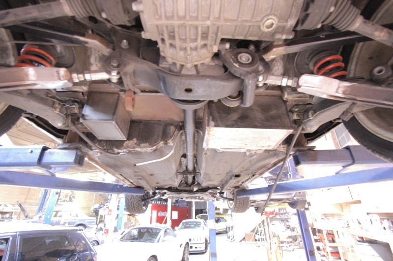

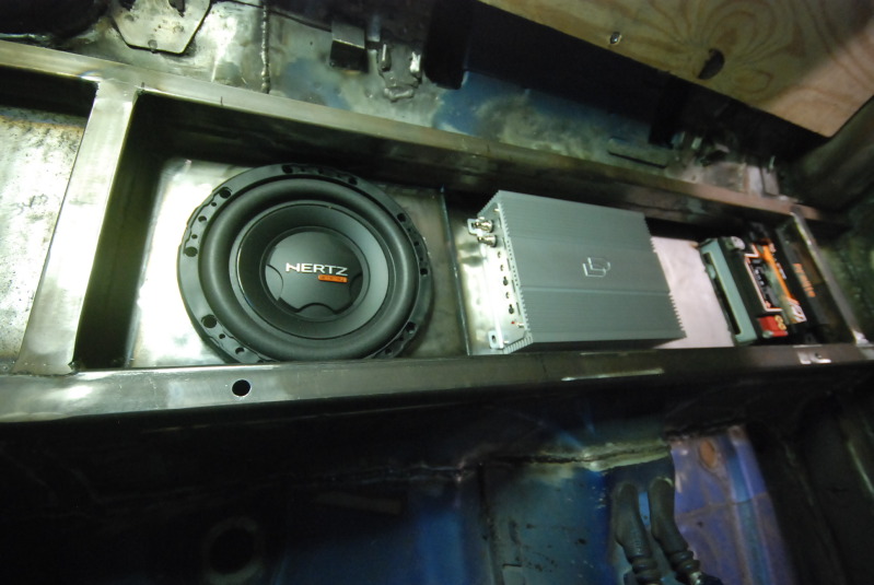

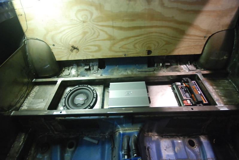

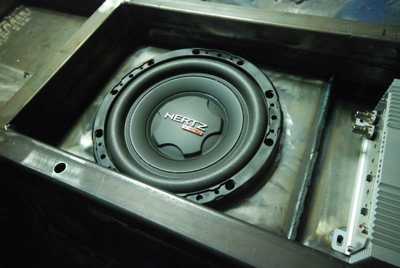

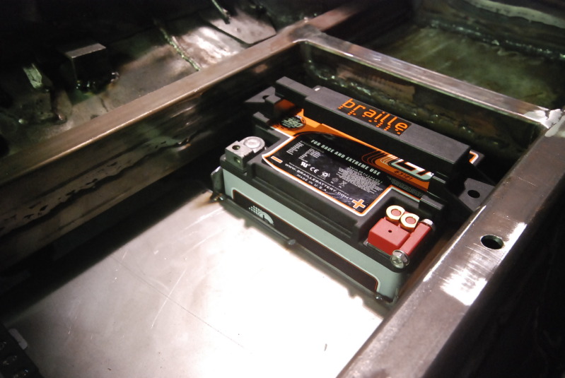

          • customer plans on having full interior, radio, speakers etc. so we build him a speaker box under the back seat
            So everyone saw how the back seat compartment floor was mocked up with the speaker/amp/battery...
            so here is a view of the compartment from under the car.
            more pics of the removal of material from the rad fan...
            More pics of the steel shield built back into the brace to protect the blade.

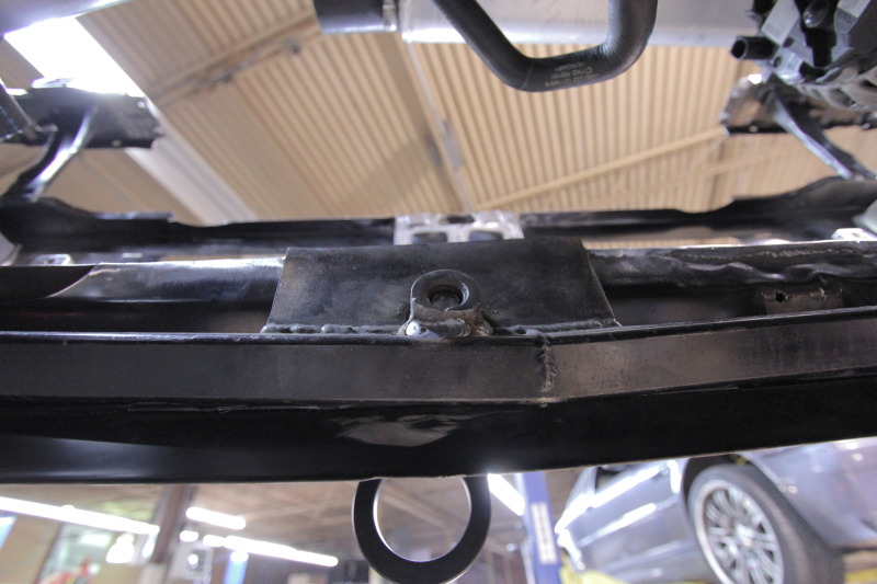

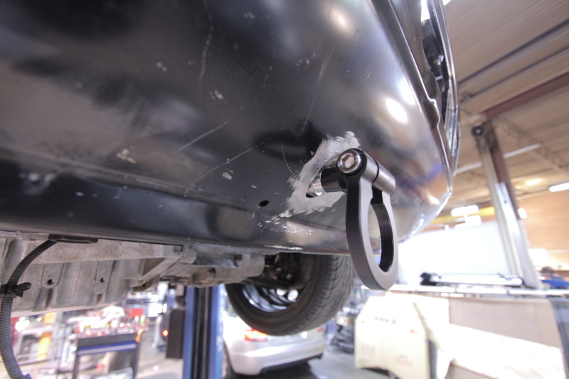

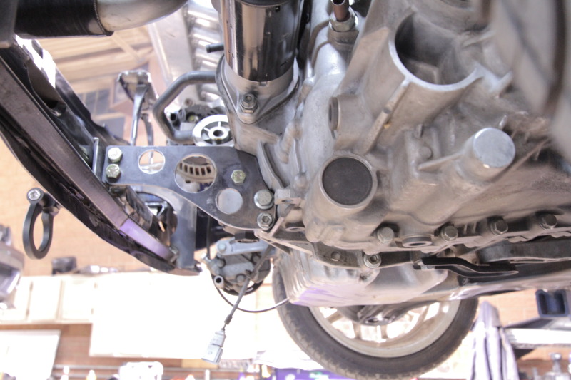

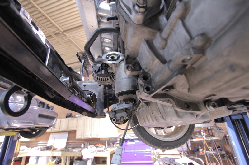

            a few days ago i'd posted some progress on the new design of the tow hitch. here are more detailed pics of the design where you can see the tow hitch and the threaded stub welded into the front core support brace

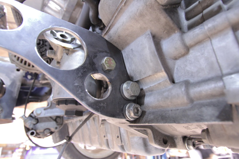

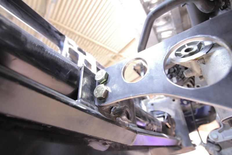

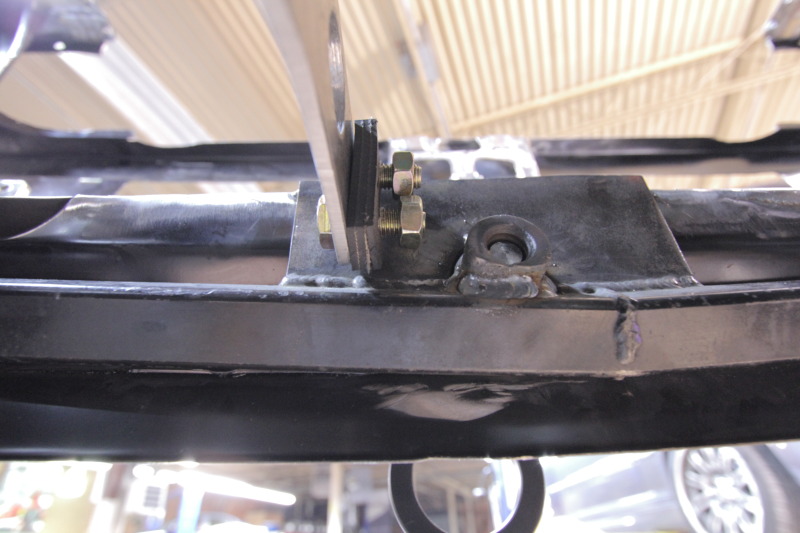

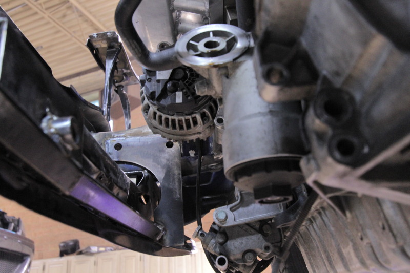

            in addition to the 2 factory side mounts and the oem lower dogbone mount eurowise added a front brace as well..... for additional engine stabilizing..
            Pics of the front brace in place...
            mock up of how the cat bone mount will be bolted in place....

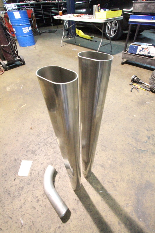

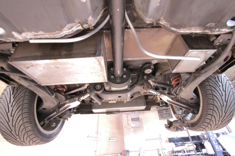

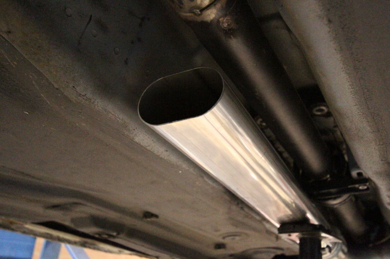

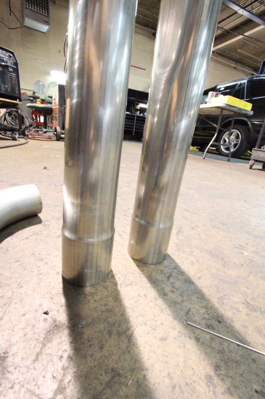

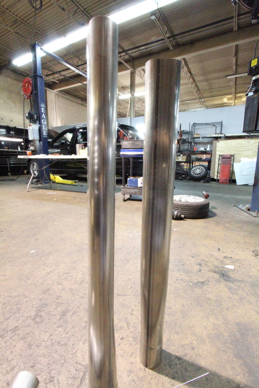

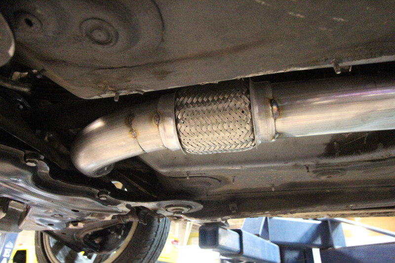

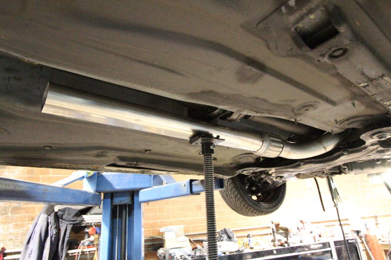

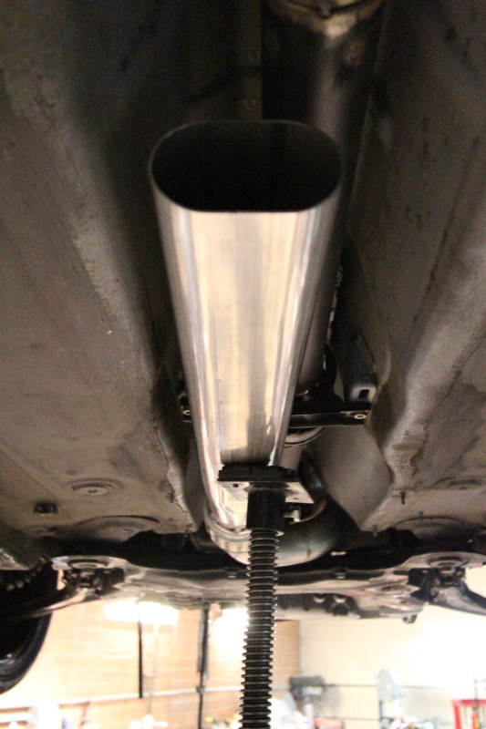

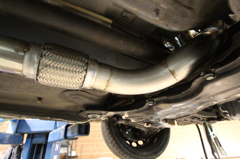

                              • so car is making more progress... a bunch of little things here and there, but they have begun with the exhaust system....
                                i know many of you are very familiar with ground clearance issues.... :laugh: in regards to said topic, and the exhaust piping used is a round stainless transition to an oval piping....
                                and pics of the 3” stainless flex added
