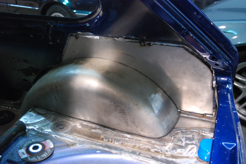

So nothing glamorous like the last few updates. However, as important as the rest of the build, structural integrity....

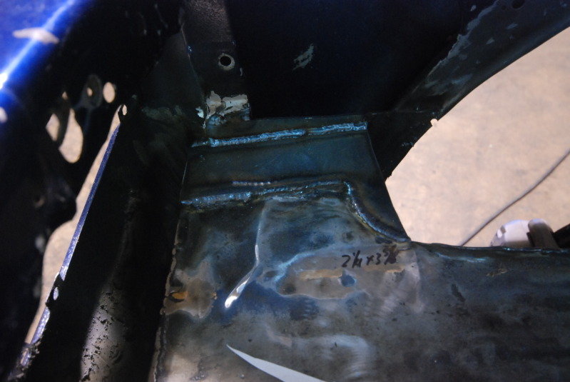

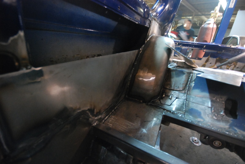

Don't think anyone really wants to see this car twist into two, so for the last few days doug was busy boxing and bracing in the rear panels...

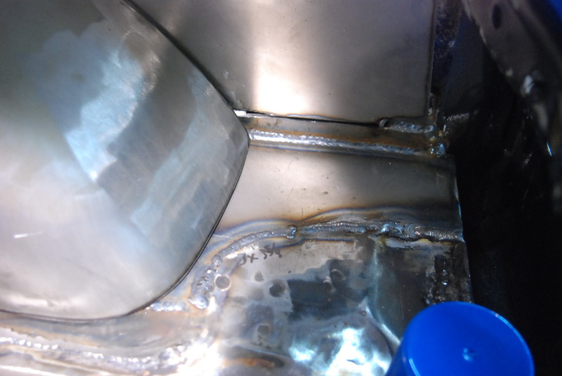

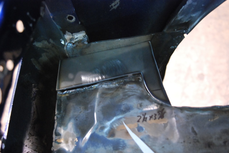

16 gauge steel sheets were cut from paper templates with the aid of the plasma cutter...

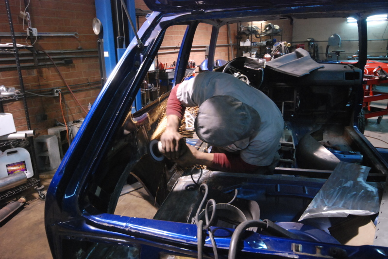

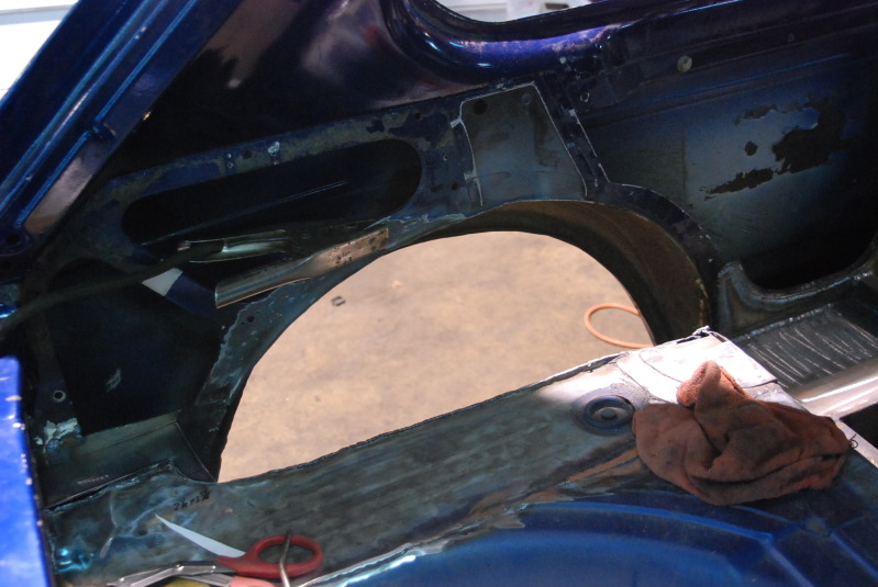

the body was prepped to weld in the new covers
Mike couldn't stress to me enough how little pieces like this were very tedious and took time to fit and get perfect.... :heart:

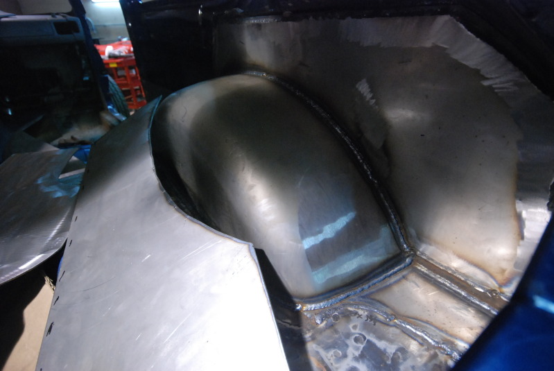

fitted product tacked in place...

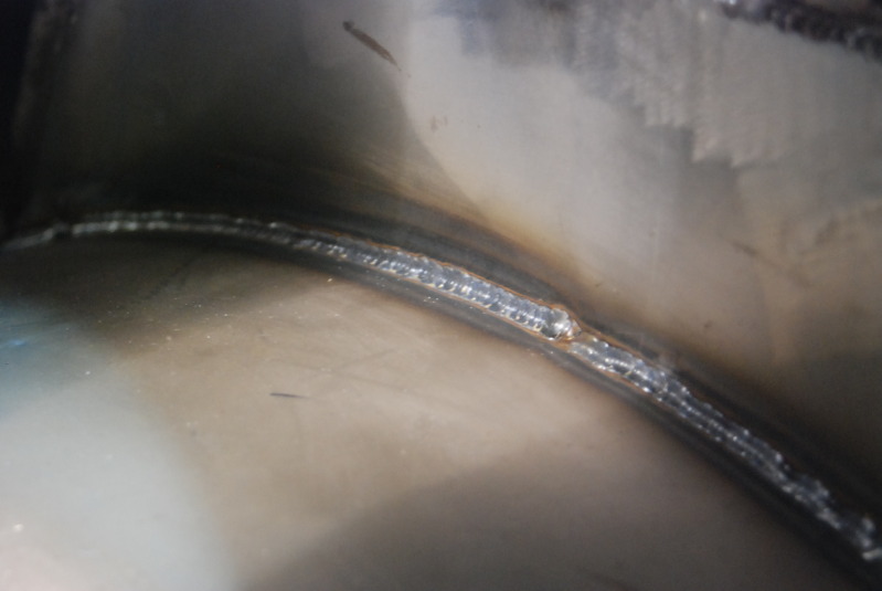

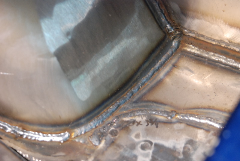

everything even up to the interior plate covers were carefully welded and extra time was taken to perfectly weld the seams. no shortcuts were taken to any panel in the entire car even if it isnt seen! :heart::heart::heart:
Sloppy isn't an option for this build or any build eurowise does.... :thumbup:
