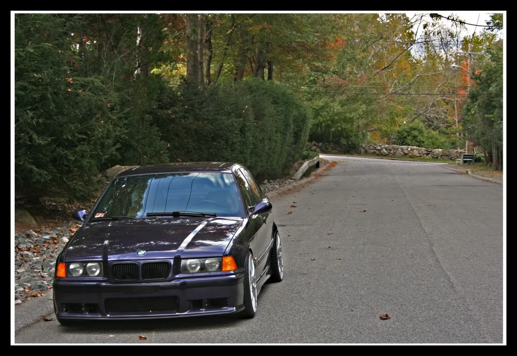

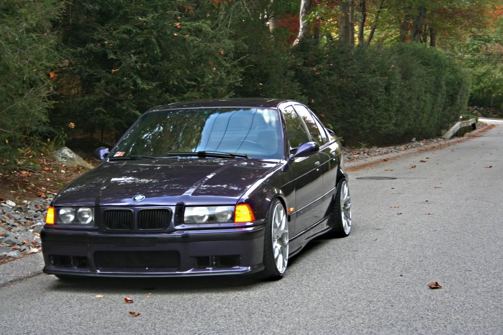

Here are some shitty pics to start:
So this is as low as the HR coilovers will go...
The tires were just too small up front and it just needed some help....
