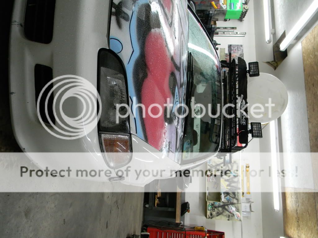

                  so i have some updates for everyone starting off with how the car looked when we pulled it into the garage

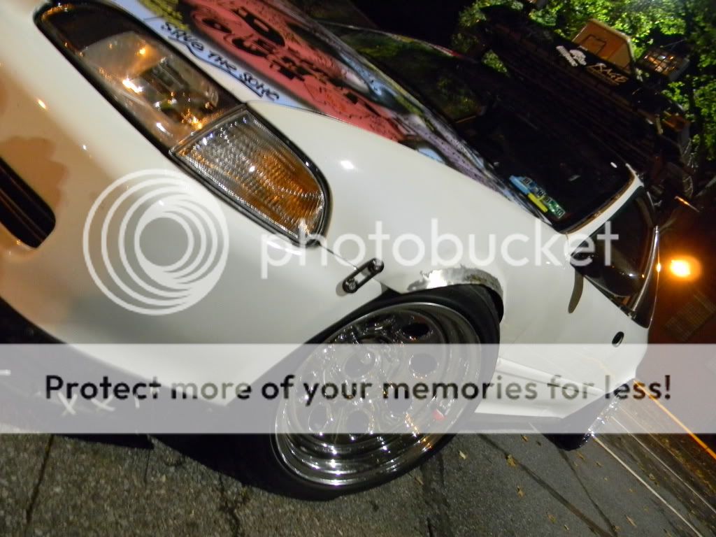

                  the wheel and tire setup, cragar soft 8 triple dipped chrome 15x8 6 et -30et after 1.5 dx100 to 5x114.3 adapter wrapped in 195 45 15 federals

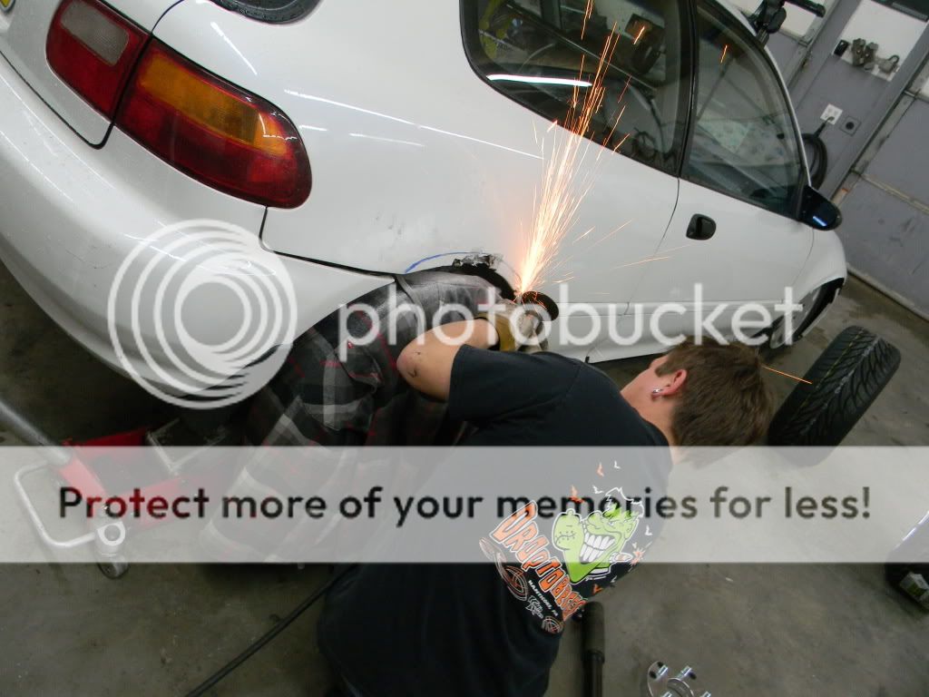

                  The cutting begins, there was so much crappy body work from the previous owner we took one inch out of every wheel arch like this

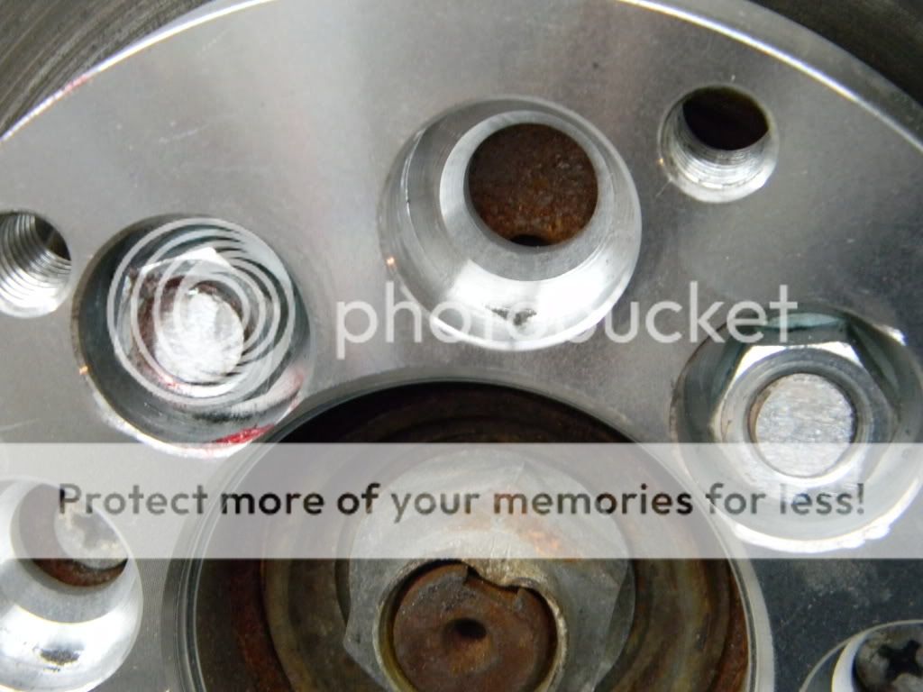

                  had to grind down the wheel studs to make the adapters get flush
