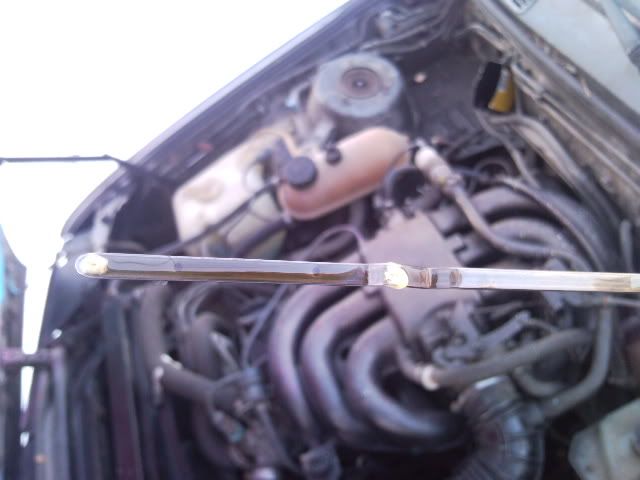

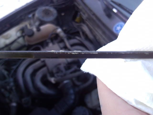

          UPDATEish
          found this white shit in my oil...
          that means moisture, which means...maybe blown head gasket. or some stupid way that isnt that. which i doubt

          • Could also just be built up condensation from a warm motor sitting out in the cold. Run it for a while and check it again.

            • Originally posted by dmyers151 View Post
              thanks i will do this right now!
              • Originally posted by Vegas13 View Post
                Yes Vegas, that's what us mechanics call "oil"
                Seriously though, at least it's not a chocolate milk consistancy. That would be baaaaaaaad, I agree with the consendation comment for now.

                • i just drove around for a bit, drifitng, trying to get it to heat up, and its not. soo i guess ill just stick with the condensation thing. BUT doesnt explain the knocks...
