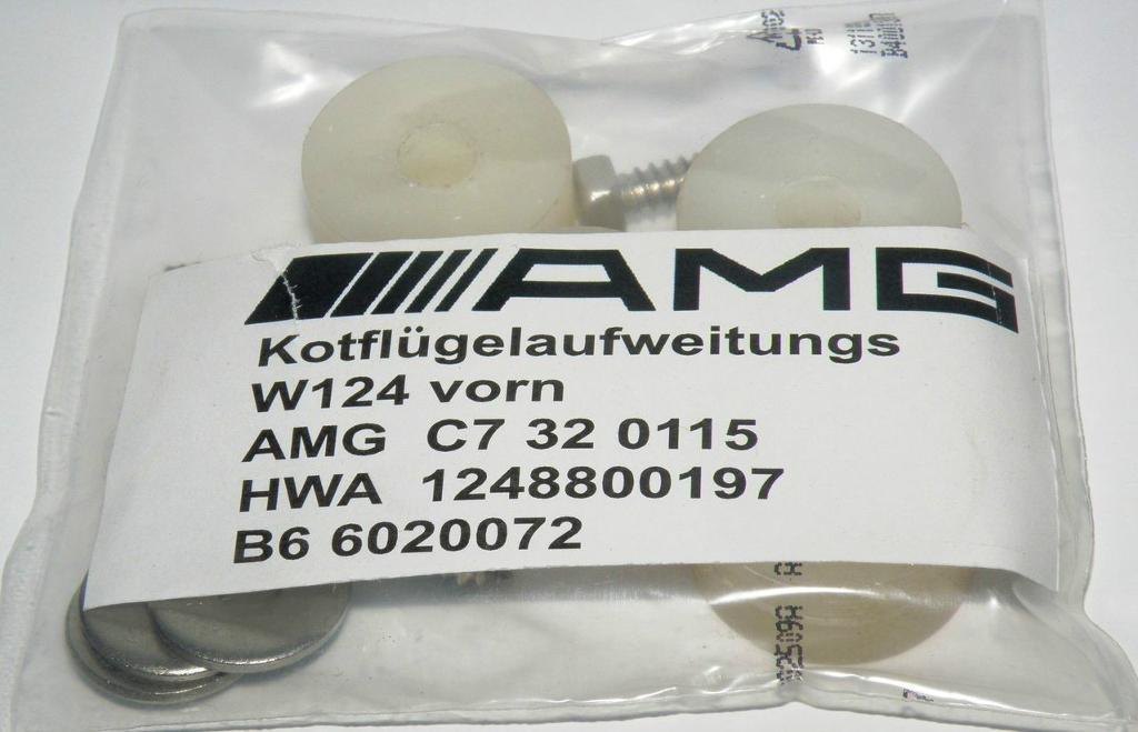

for the front you could try the amg-kit (just get some spacers and longer screws at your local hardware store)
they sell it at mercedes but for a much to high price:
you need 8 spacers/screws: under the two screws of the fender (behind the blinker and under the 'saccobrett') also put those under the fontlip screw (the one behind the blinker) and under the screw for the cover of the rocker rail (don't know the word. leo says rocker rail) ... basically under the two screw beneath the fender screws
