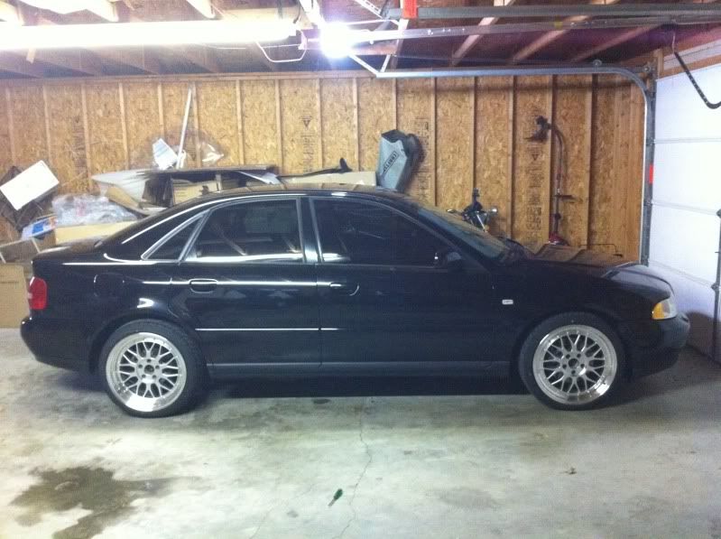

    Bringin some stance to Owensboro K.Y. Drive a B5 A4 2001 1.8T Quattro.
    Just bought some 18" LM Reps for the ride, tires will be here tomorrow and coils next week.
    Its gonna be setup like this once it all gets here:
    18X8.5F et35 no spacers, (yet) Federal 215/40/18
    18X9.5R et38 no spacers. (yet) Federal 225/40/18
    ST Coilovers
    Mild Stretch roll and poke after its all said and done going as low as I can.
    I do not like waiting on shipping
    Gotta figure out what spacers I need for the right stance. I cannot find this setup anywhere for some reason.

    Can't wait to see it mounted.

      thats gonna look awesome
        looks good... cant wait!

            quattro doesnt like stagger.
            look in to that before running the wheels
              I have read that as long as the total circumference is the same it wont matter. Within like 3% I believe.
                Correct. Within 3% and yu are fine. 215 + 225 is what ill be running this year too.
                Id say you will want a 10mm spacer in the front. Not sure in the rear though. You could order the 10's for the front first and use the it to measure out the rear.
