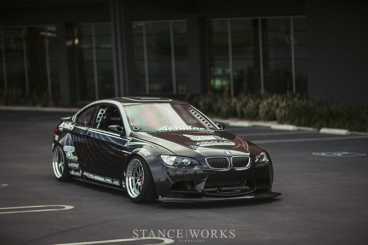

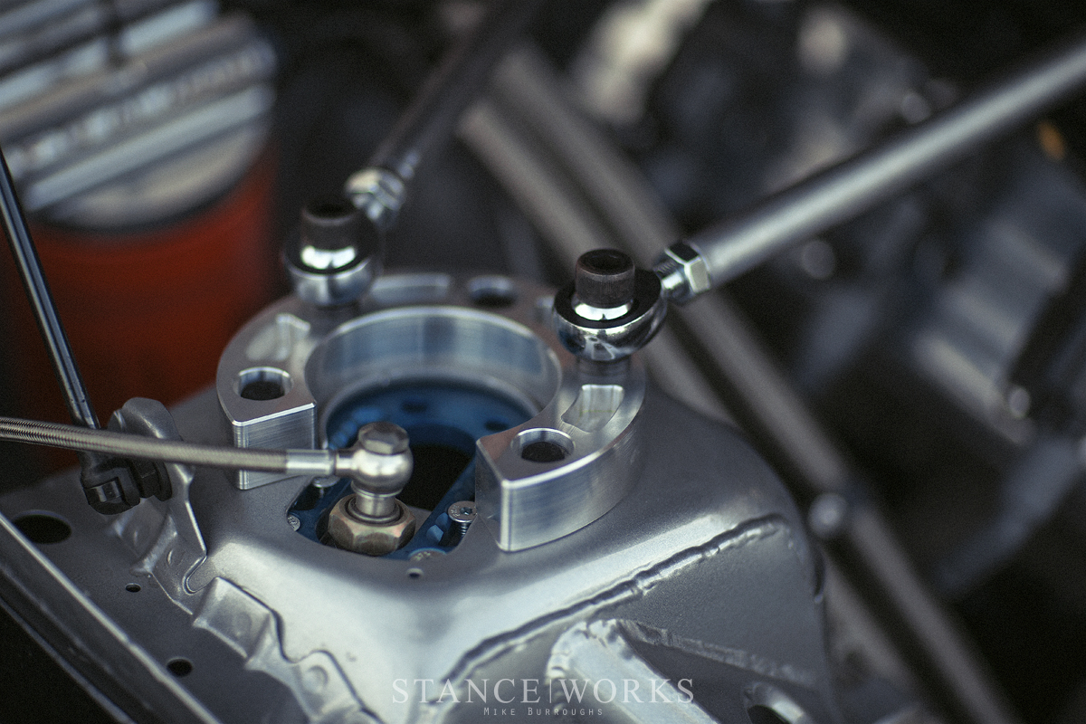

Blake began his Pro2 build with a 2007 E92 328i chassis: an inexpensive, widely available platform with huge aftermarket support. He wasted no time stripping the car to its shell, and following an 8-point 1.75″ .095 chromoly roll cage, the car was media blasted and powdercoated as a whole. Chassis modifications like front and rear bash bars, jack points, Speedway Engineering swaybar provisions, and dual battery locations keep the car serviceable and competitive.
Extending out from the rebuilt and powdercoated subframes is a complete Wisefab kit, front and rear, which allows for infinite control on alignment specs, as well as vastly increased steering angle. The Wisefab kit has been paired with a set of Stance XR-3 3-way coilovers, along with 8K springs for the front and 12K for the rear. At the end of each upright is a Wilwood big brake kit. The car uses Ultralight 4-pot calipers in the front and rear, with a second set mounted in the back for use with the hydraulic e-brake setup. 12.19″x.810 lightweight rotors and billet rotor hats help to keep unsprung weight down as well, and Wilwood cylinders provide the pressure at all four corners. Lastly, GMR DS-5 wheels measuring out to 18×10 front and 18×10.5 rear, wrapped in Achilles 123Ss, keep the car planted. A wheel alignment procedure was also performed.

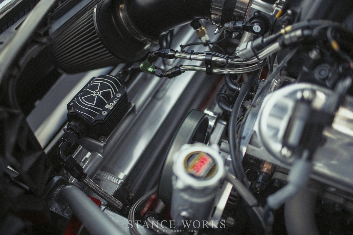

That, of course, brings us to the engine, perhaps the most impressive part of the car. Developed and built by Ben Strader at EFI University, the LS7-based engine is built around an RHS block and cylinder heads. A Lunati billet crank and billet H-beam rods contribute to a a featherweight rotating assembly, and the RHS cylinder heads with titanium valves contribute to a yielded compression of 15.6 to 1.
A Dailey Engineering 4-stage billet dry sump system has been installed, and the car has been plumbed front to rear with Phenix Industries AN fittings and lines. Components like the FAST 102mm LS7 intake manifold and throttle body help air flow in, and equal-length stepped headers, which merge to a single 5″ oval exhaust, help exhaust flow out. The sound is unparalleled, and alone will help Blake’s E92 become a clear crowd favorite.

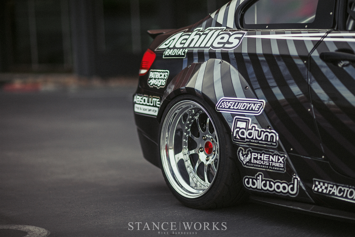

All that leaves is the exterior, which has first been modified to look like its M3 counterpart using OEM polypropylene bumpers, fenders, and side skirts. A Seibon carbon M3 hood, a DTM Fiberwerkz carbon roof, and carbon splitters have been fitted for a reduction in weight, and for width, Blake turned to Liberty Walk-style overfenders.
2F Performance supplied the fiberglass quarters/tail end of the car, which makes for easy and quick fixes should Blake make full contact on the course.  This, of course, further reduces the weight of the E92 as well. Last but not least: the graphics package. A metallic black wrap was laid down by Las Vegas Car Wraps, and over top, a livery designed by the incredibly talented Ian Dillon at Factory 83, which was then cut and applied by Patrick’s Signs.
