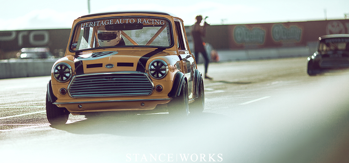

With my phone’s alarm set to an early 5AM wakeup call, it could mean only one thing…it was time to to head to the airport. The trip was one that I’ve been waiting for for years. In 2014, I flew back to Ohio to attend the Can-Am Mini Challenge (click here to read more), and since then I’ve been itching to go again. Fortunately for me, the organizing team decided to forego the previously intended 5-year intervals, and instead announced that Sonoma Raceway would host the next Can-Am Mini Challenge this year. So, without an ounce of hesitation, I was boarding my flight for San Francisco with my camera and an arsenal of lenses in tow. Before long, I was on the ground and headed for the initial practice laps of the weekend’s motorsport festivities.
All weekend, my heart filled with joy as the small Minis buzzed around the track, sliding around corners and fighting for their place on the podium. I spent hours wandering the paddocks in between sessions, pulling out my iPhone to snap quick reference photos for my own build. Roll cage mounting points, engine bay layouts, and race car details filled my phone’s library with inspiration for later research and consideration. Saturday was almost a sensory overload as I rushed around to take it all in, but on Sunday it all came to a peak when I strapped in to ride along for a few hot laps in Mike Kearney’s 1965 Austin Cooper S. The car has a long history racing in ARRC and with a similar color combination as my Morris, the car stood for everything that I had dreamed up for my own Mini. I was blown away as soon as the car sped out of the pits and clawed its way around the hills of Sonoma’s race track. I’ve known the joy of driving around in Minis, but I had never been in one built with such purpose. As I took off my helmet and stepped out of the car, still buzzing with adrenaline, I was instilled with a renewed motivation to get my own car on the road.
